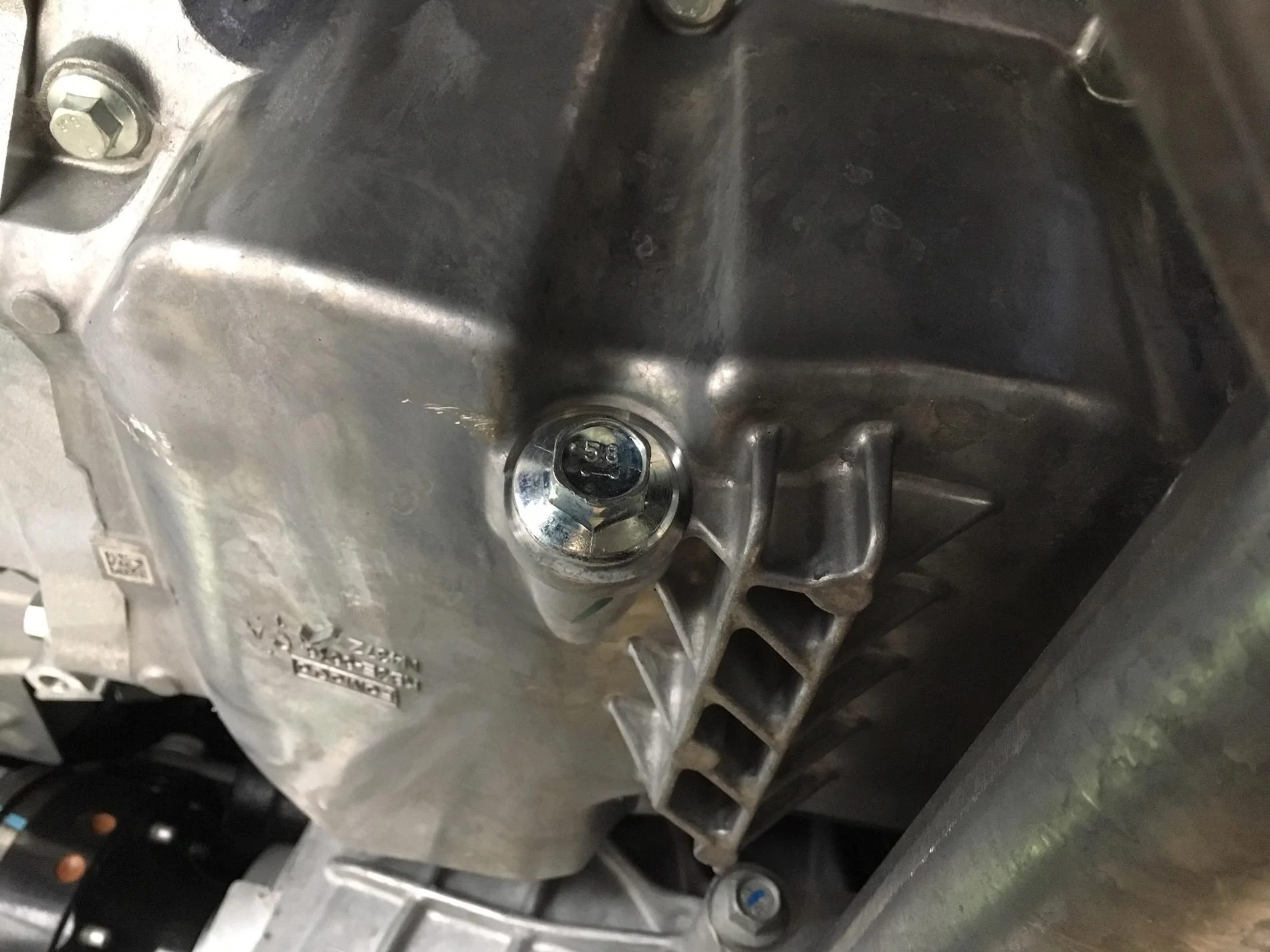

Can someone verify if this is the drain plug? I'm pretty sure since it's at the bottom of the engine but just to be sure...I'm asking those of you who know what it looks like since you've done an oil change yourself :wink:
I didn't really look at mine, but if it's on the bottom of the oil pan above that funny little skid plate, then that's it.
