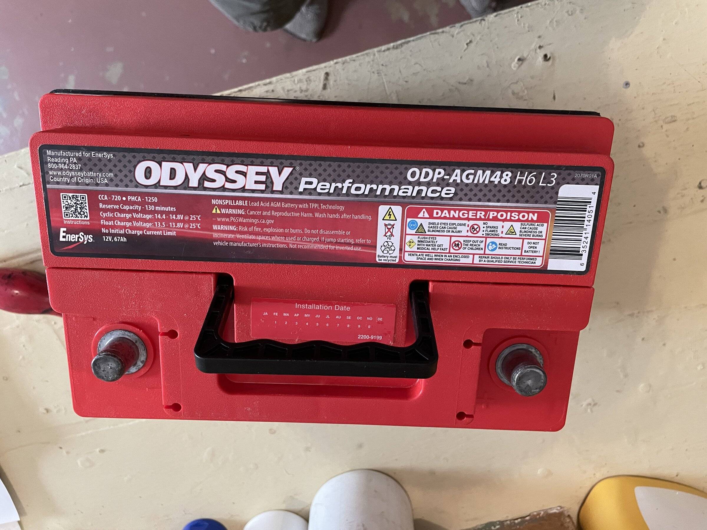

ere is my story, I ordered replacement premium Odyessy battery,
it came with small defect in case, I put Por 15 paste patch on it and installed with no issues other than wiring harness and location is a PIA. Two weeks later after E-mail and pictures a second replacement battery came from Odyessy. The Ford Battery is on our Hurricane generator on trickle charger, the first one in truck, the 2nd one on shelf.
