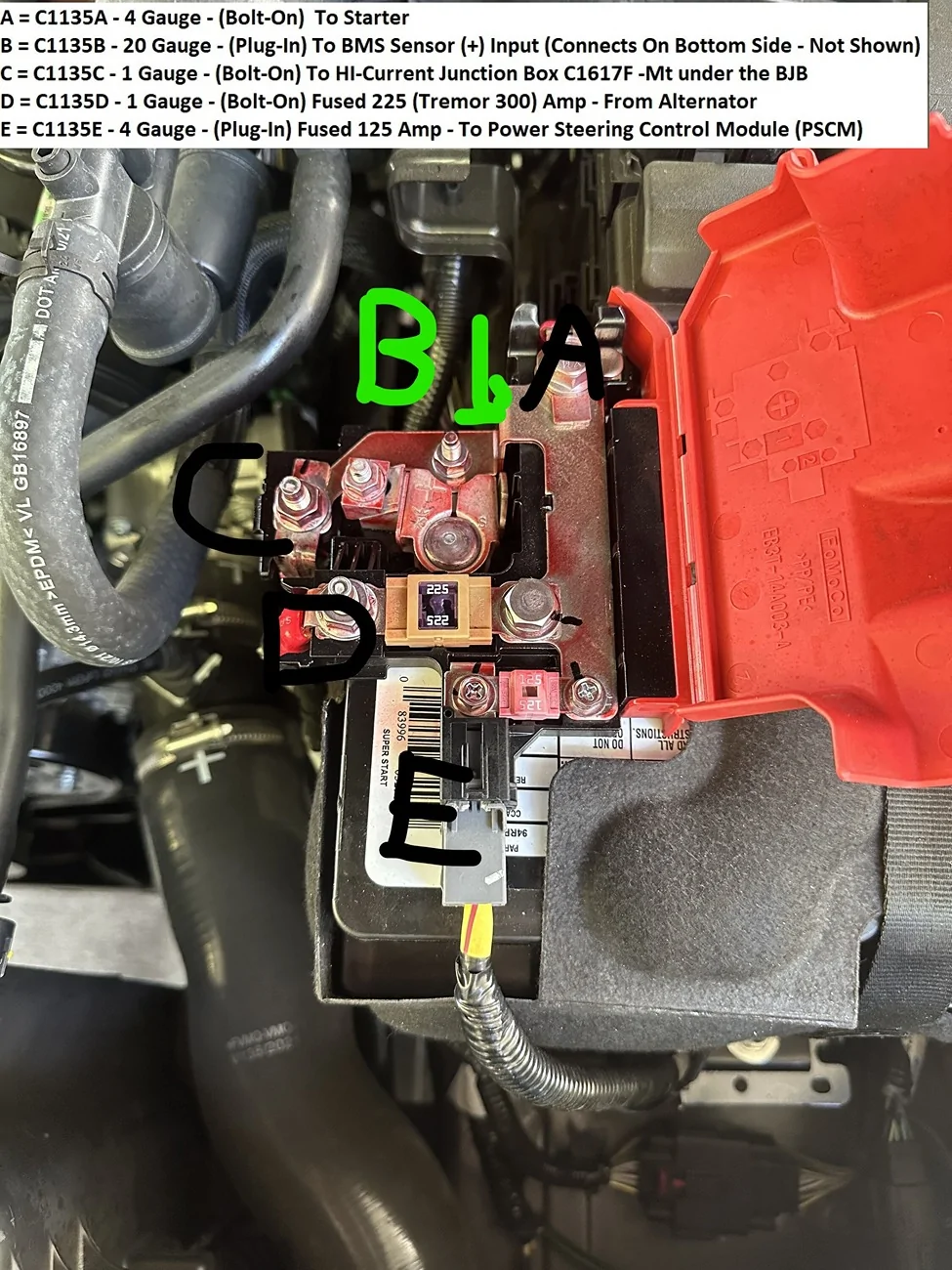

Hi. Code coming up is u012D
airline tech
Aug 24, 2022
4,482
8,550
Midwest - KS
Aircraft Tech
Yes - Check the 225-Amp Fuse - not just a visual but check for voltage on both sides or pull it off and verify its intact.
Plus check the (cable) end connection from 225 Amp Fuse down to the (Alternator) and the (Connector - Lin Bus) on the Alternator for security
Plus also ensure Connector (B) is secure to the BMFL

Thank you. I will have to check everything again tomorrow. I appreciate the help.

In the diagram above, connection D. The one from the alternator.
