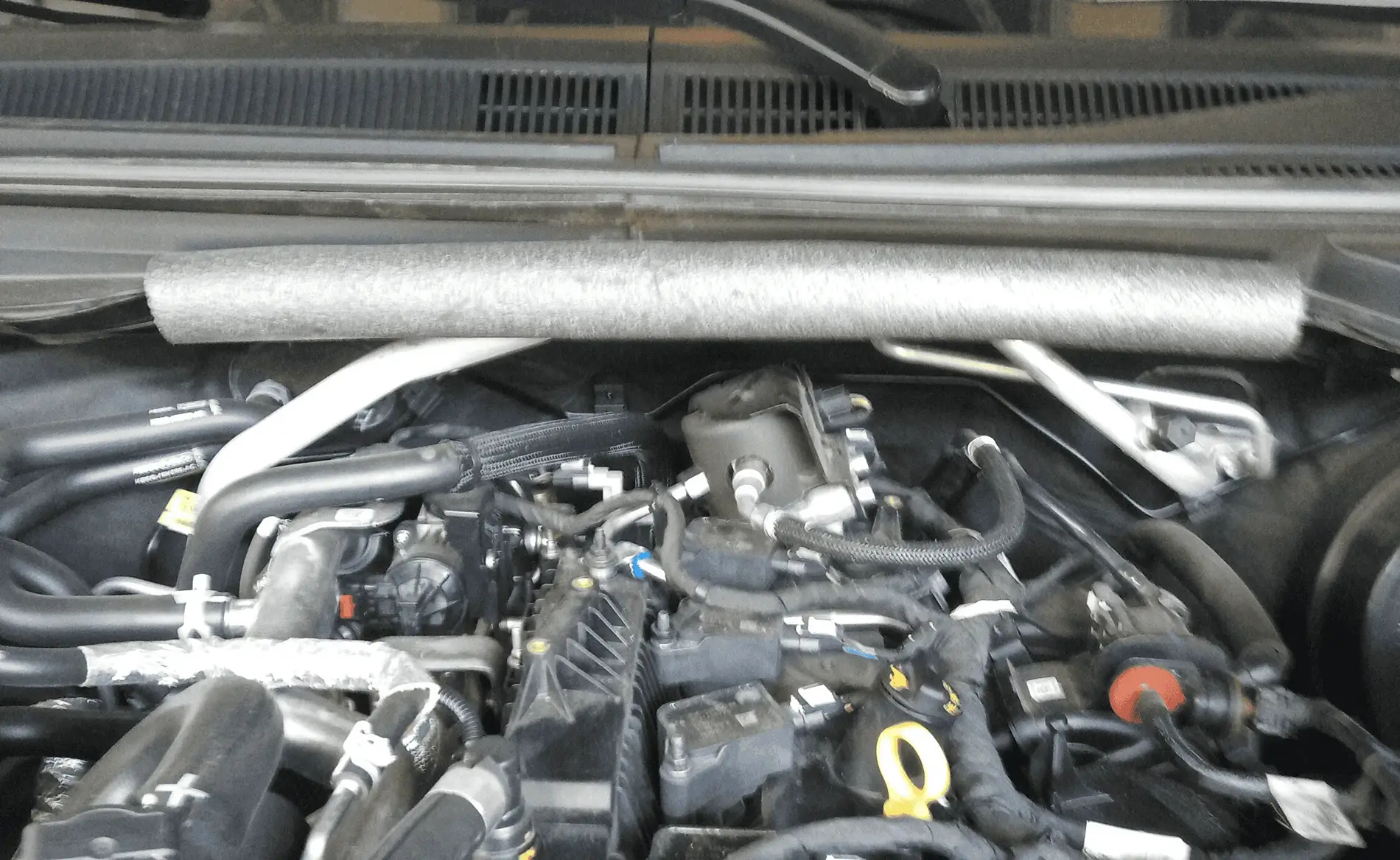

As a long time member of this group I had seen the mention of the Service Bulletin for water intrusion and had bought the engine cover at my expense ($75 back then) in the first 2-3 years I owned my Truck primarily for that reason. I mainly store this in my garage or under cover at the airport when I am traveling for work.

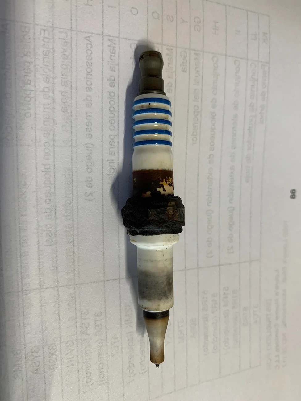

So I pulled #1 and the Plug cap was stained red at the bottom from rust and the bottom of the plug well caked up with rusty water. I blew out all of the crud and fished around and scraped crap loose with a coat hanger and kept blowing stuff out and actually got it pretty clean. I started dosing with Blaster and went on and replaced the other 3 plugs, 2 and 4 not bad 3 pretty tight but gave in, all of them squeaked and seemed to object to coming out. I was then ready for 1 and it was not budging so I let it sit overnight soaking. Next day still not budging so I put the coil back on and ran the motor and warmed things up to try again. Still did not budge so had some places to go and let it soak for about another 24 hours. Tried warming up again and still did not go, repeated again and I felt a small movement and a little noise so immediately stopped to try to turn it back slightly with the intention to rock it back and forth and let the juice soak in. Well, the slight back pressure broke the plug off, threads are in the hole and the porcelain clear to the tip and hex are in my hand.

My guess is that it will need to be drilled down through with a bit that is ever-so-slightly smaller than the threads. Making what's left thin enough to break out.
Or just drill down through it and install a timesert. That wouldn't be the most terrible thing ever. Sucks, but it isn't a death sentence.

Knowing Ford, plugs are not covered under any warranty, OEM or ESP.
I don't think they will put much effort into extracting it, so you are probably looking at a new head.
If they do manage, first thing to do is take it home, remove the plugs and add a little Never Seize to the threads.

Will / does the engine cover help prevent this issue?
26,489
133,552
It helps but it doesn't alleviate it. Knowing what we know now it's best to pull them out when new and add anti-seize to them.
Or you can do what Robert @NotBudule2 did and add this to it to deflect the water.

I would try a #4 or #5 - Straight Fluke Easy Out - Which ever one of the (2) will grab the thread boss without expanding it - (Increasing friction) in the thread hole.
This is pretty much the (Only Option) now besides head replacement
You can find either:
Long - Straight Fluke (Extractors) + T-Handle
Or
Standard Length (Extractor) + Tap Socket + 3/8 Extension + 3/8 Ratchet
I would recommend the (Straight Fluke) over the spiral extractors for this - as you need to prevent expanding (Wedging) the remaining boss into the threads making it even more of a challenge.
Note:
I know what it takes to get it out, but would have to do some digging on the proper tool setup, with this being in a recessed well. - Which one would be the (Best Option - For Success)
I think that they make a special tool set for this as well.
I am confident that you can get it out - without head replacement, as long as you continue the baby steps and not be aggressive with it.
