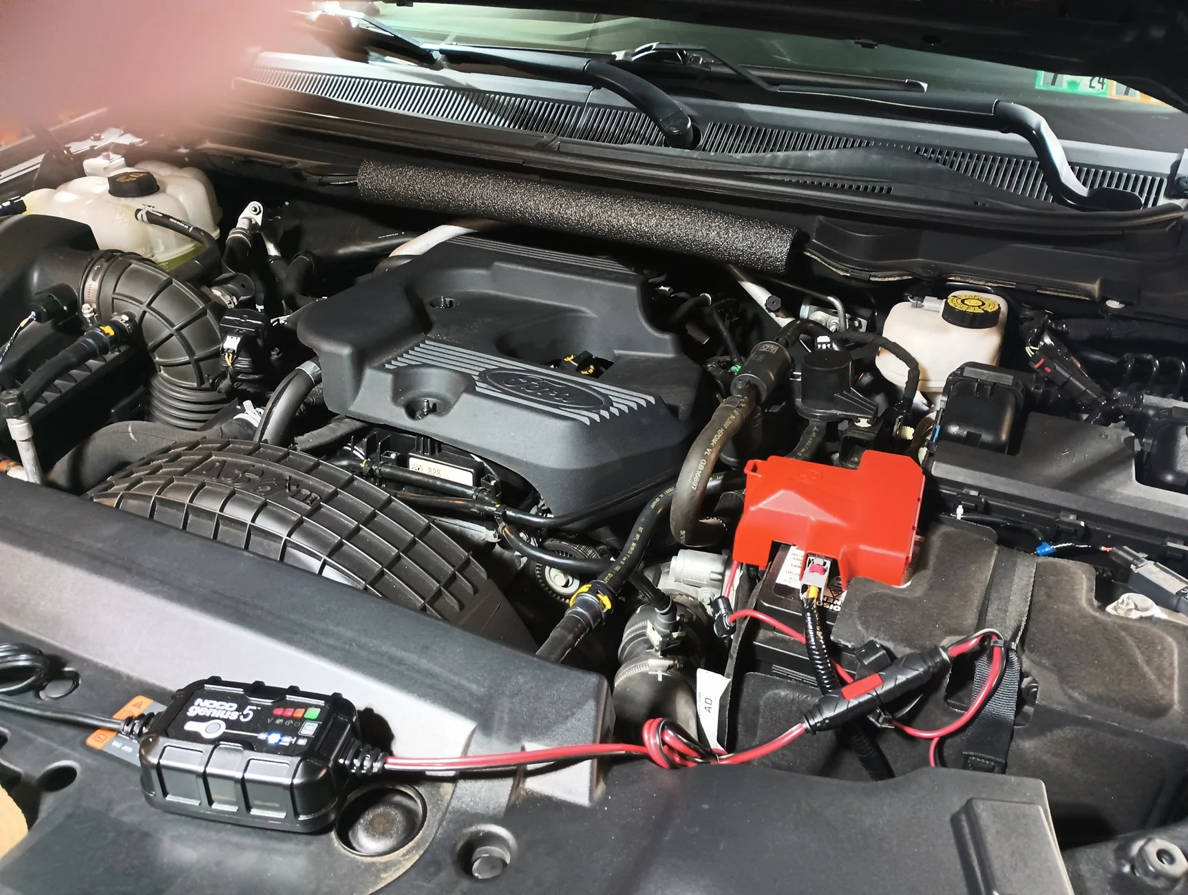

So yes I had seen the Bulletin on water intrusion in I am guessing 2021 and did buy and install the engine cover but still water in #1. I had not seen the pipe insulation trick but will get that installed for sure and will also do some water tests to see where it is going. There is only a thin ring of the threads left inside the hole and I assume the one side of the spark plug electrode. All given in a way it seems best to pull the head as can you be sure any partial pices of the porcelin or something may have dropped into the cylinder. The bottom of the rubber spark plug boot was even discolored red from the rust. Alert to you all and be proactive in gettting this addressed t onot have this happen to you.

I bought my 2020 ford used in 2023 with 22,??? Miles on it. When it hit 26,??? The # plug blew out, they said it was from water intrusion . I did luck out and ford replaced the entire long block under warranty . That is the reason i have the engine cover and pipe insulation both.

That pipe insulation does not interfere with the hood closing or cause any damage to the hood?
