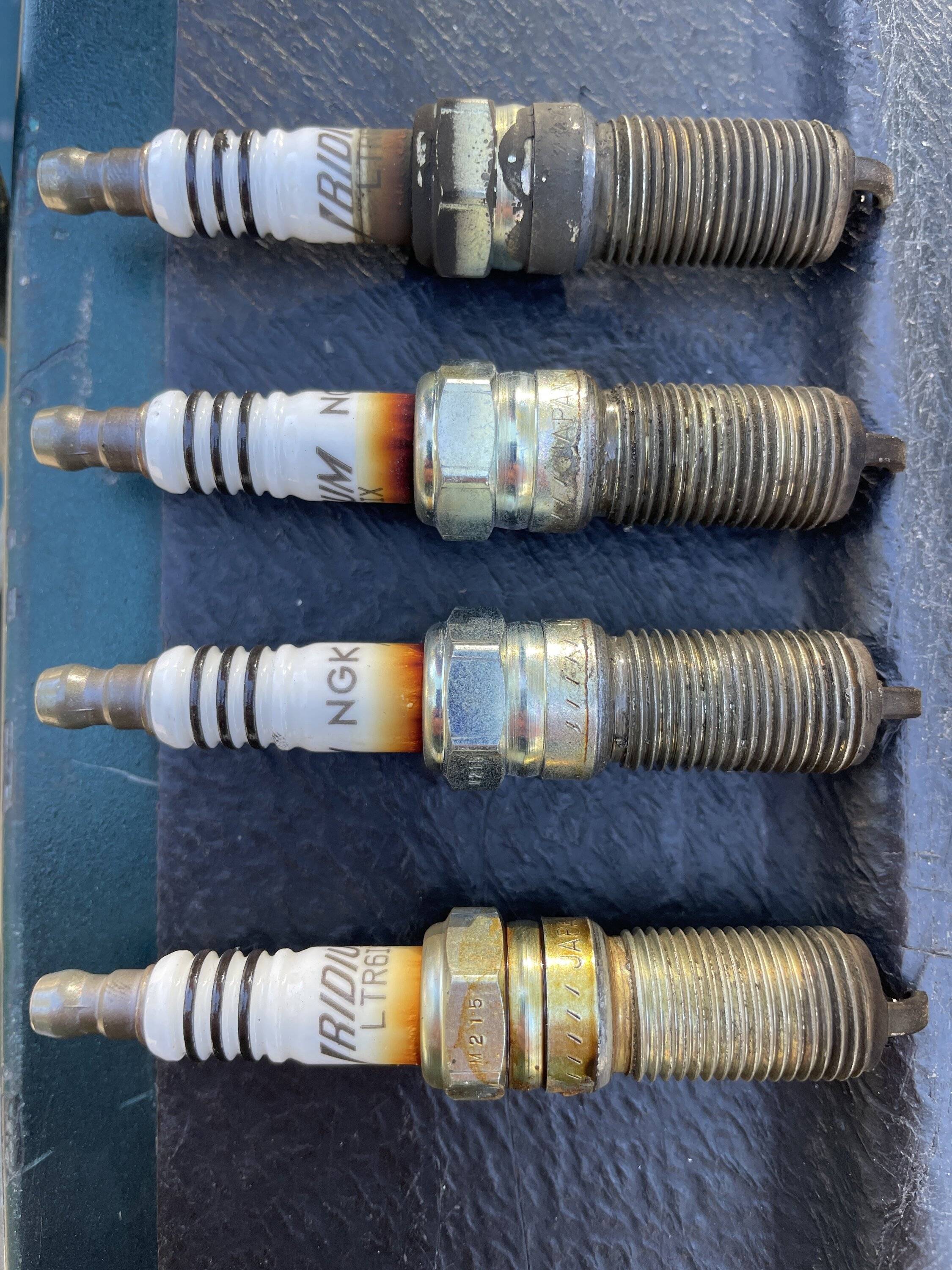

Had signs of bad spark plugs over the past week. Pulled out the NGKs after about 40k miles. All of them had the gap increased from .03 to .035. They looked worn but much better than the stock ones. I decided to just replace them with the NGK 90495 and I gapped those to .028/.029. So far so good. We will have to see how the plugs hold up with the tune. I’ll post a picture of the old NGK I pulled out too. Plugs are in order one at bottom and four at top

Well just an update for those looking at the ruthenium plugs. I would not suggest them. They lasted about 25k before I got the symptoms. They looked fine coming out but after replacing I could feel the difference. Gap increased as expected. I’m running autolite iridium this time around so I’ll update when those come out.
Short description of plugs when I pulled them:
Scorch marks on ceramic. Some buildup on plugs but not as bad. By just looking you would think they were fine.
