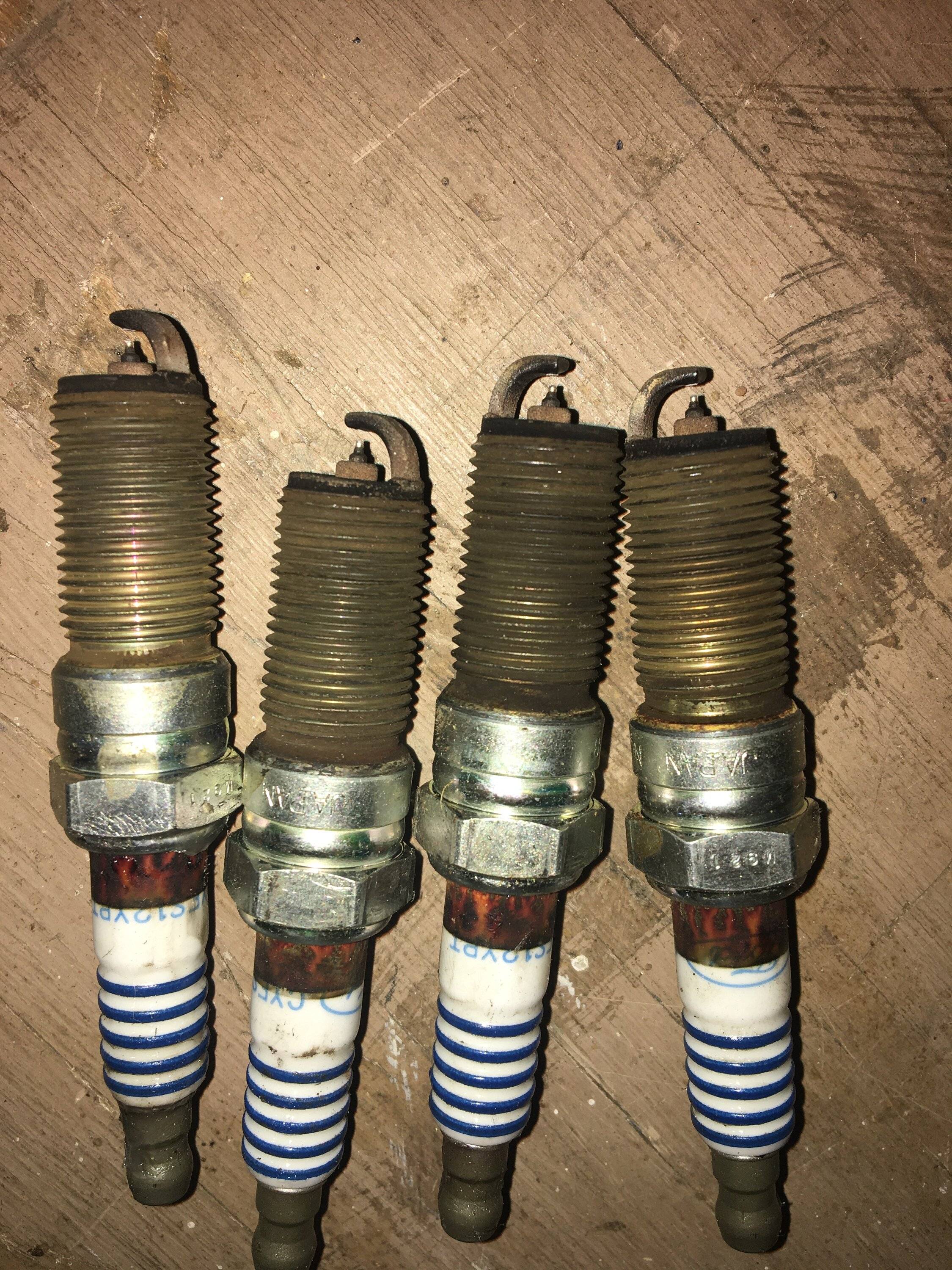

Factory plugs were pretty dirty but didn’t show any wear.

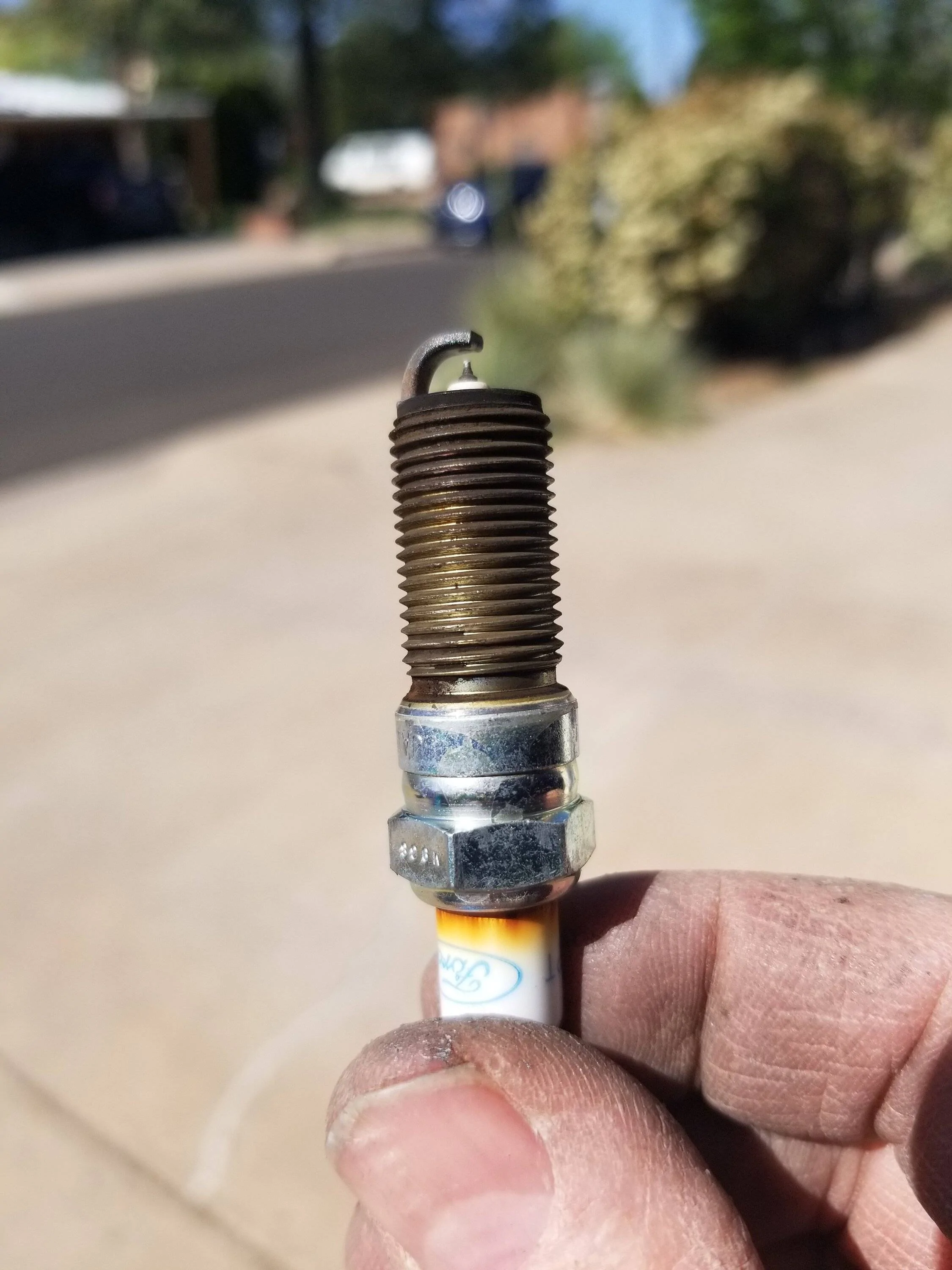

The picture shows corona stain from the presence of high voltage, not rust. This is a normal condition not caused by water.
I’ve never noticed this on other plugs. You think this is common?
RangerBill
Bob
Jun 8, 2022
1,962
2,783
PA
From the shop manual:
Corona Stain
    • A brown stain near where the insulator joins the metal shell of the spark plug is often called a corona stain and is produced when oil particles present in the air near the engine adhere to the insulator surface. Corona discharge occurs when high voltage applied to the conductor on top of the spark plug causes an insulation breakdown of the air gap between the insulator and metal shell. Corona stain does not affect spark plug performance. In the upper right photograph, tracking marks are present indicating evidence of flash over on ribs, but stop once the corona stain is reached. This suggests the corona stain is not conductive, even in the presence of high kilovolts during normal operation. The lower right photo demonstrates corona staining on the inside of a boot.
    • No corrective action is necessary if only a corona stain is present.

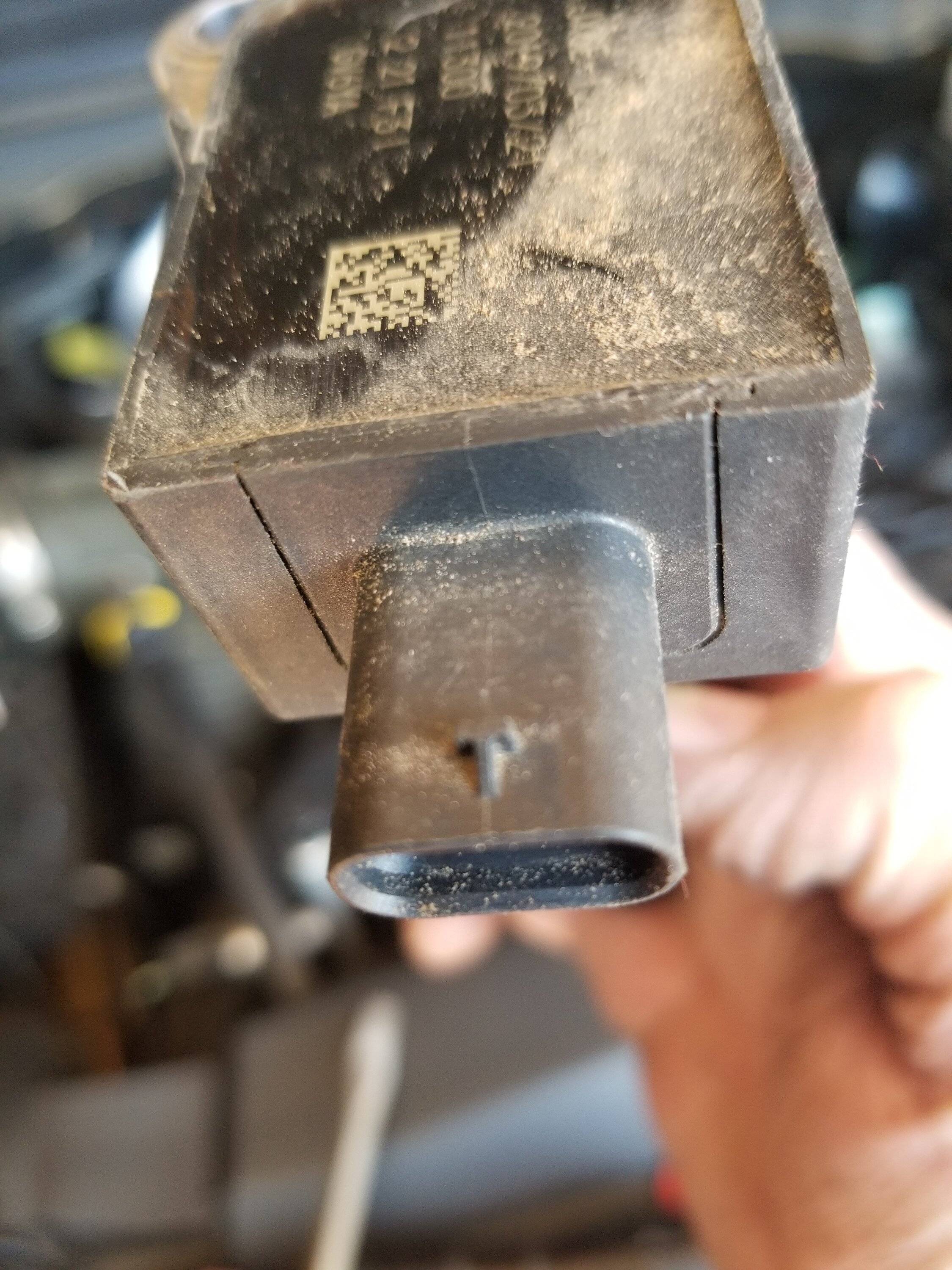

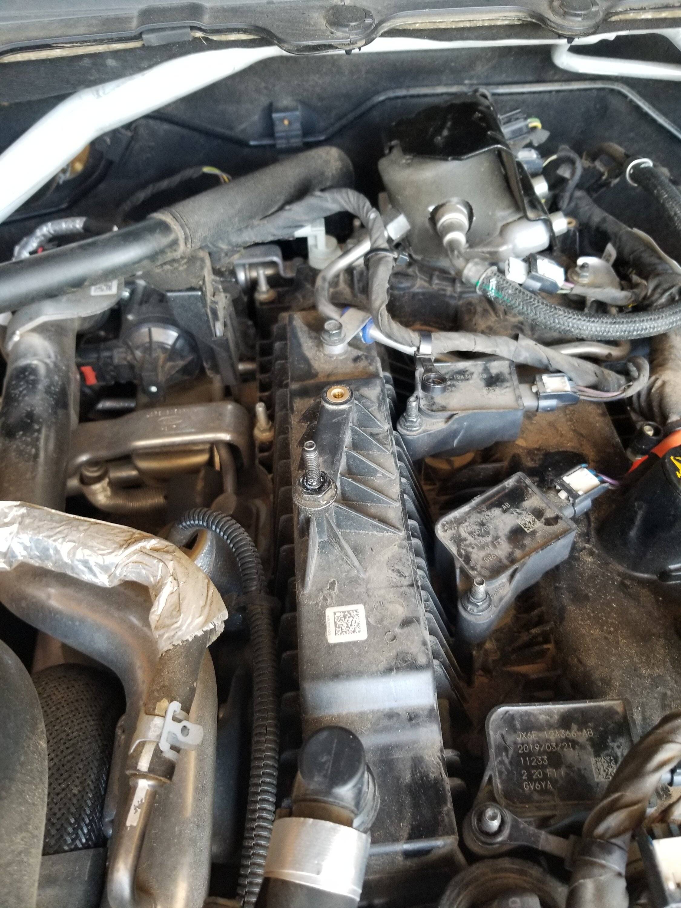

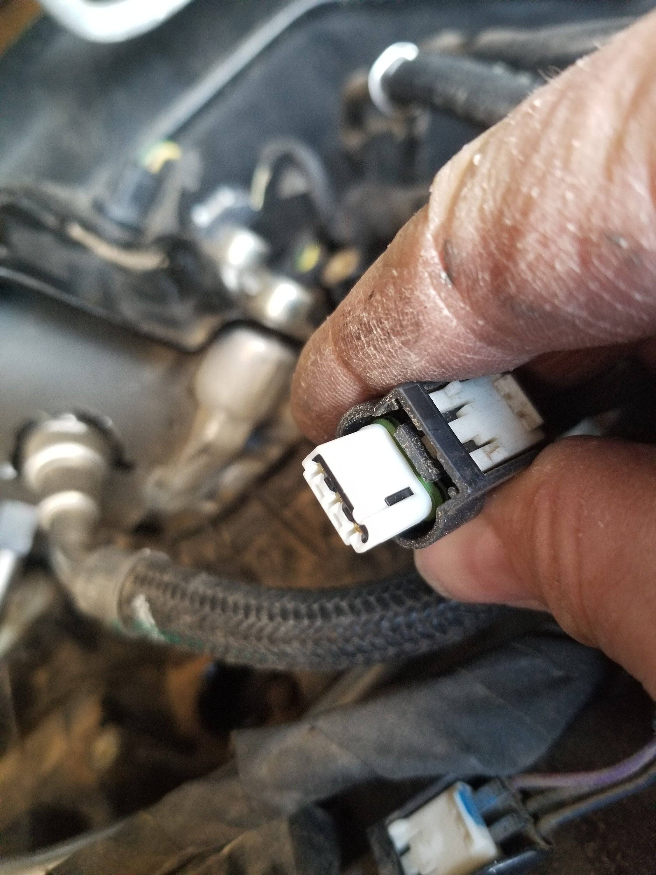

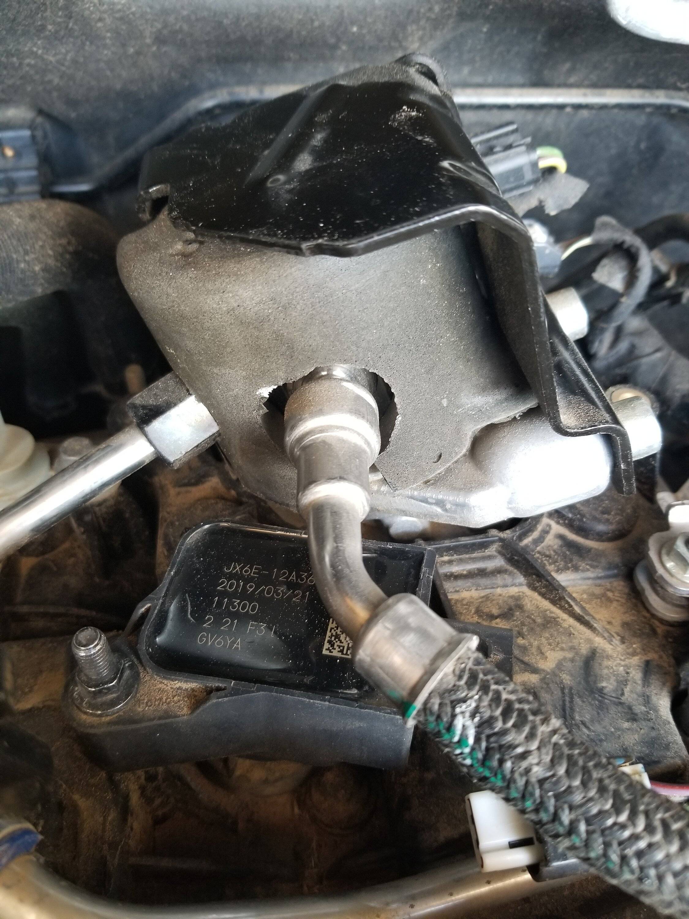

After all the talk of water in the spark plug wells and thread seizing I decided to check my plugs and install anti seize. With 21k miles plugs look fine and no water issues. Plugs were easy to remove but were very squeaky so I used never seize to protect the threads going forward. It's an easy job of 15 or 20 minutes but a few notes to make the job easier. Get a 5/8 spark plug socket to speed the removal since the wells are very deep. Look down in the wells before removing just to ensure no foreign material, mine were clean. The rear plug sits under the fuel pump(I think) so it is best to unhook the wires from the coil so you can turn it to remove. Mine was very short and I couldn't get it off without unplugging it. When replacing that rear coil, be sure it lines up. Because you can't push it straight down, so the first try it missed the plug. I had to angle it in the well while pushing the boot straight to catch the top of the plug. A few obligatory photos to finish off. You can see the plug on the coil has a white tab that slides back, then a gentle lift of a clip under that.
