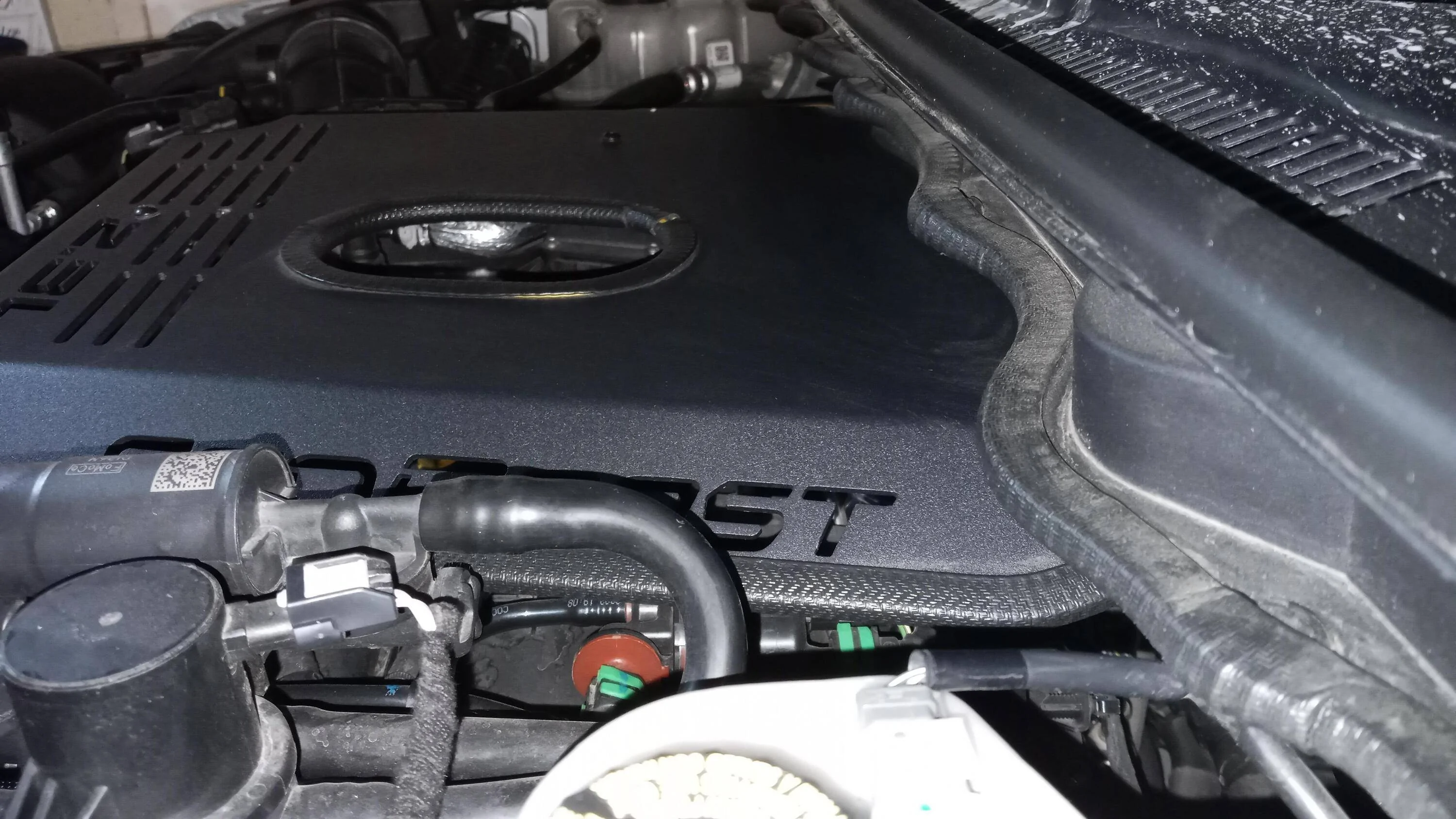

Not gonna do much to shield from water. Glad I got my (overpriced) jrc offroad cover which goes under the cowl ridge.
Personally I replaced that garbage foam strip they put between the cowl and plastic panels with 3m tape for extra protection.

I've had a few minor issues.
Aligning the holes of the cover to the threaded holes of the brackets was a major pain in the butt, and as mentioned the screws need loctite(blue stuff should work) or they will loosen over time.
It's not worth the absurd $190 they charge but it beats getting water down the plug wells.
I installed a edge guard seal to dress it up, and act as a channel should water drain onto it.
The cover does indeed go past the cowl unlike the OEM unit.
Some clearance concerns, but I think it's ok.
Heat isn't much of an issue, the cover sits high above the engine and has plenty of ventilation.

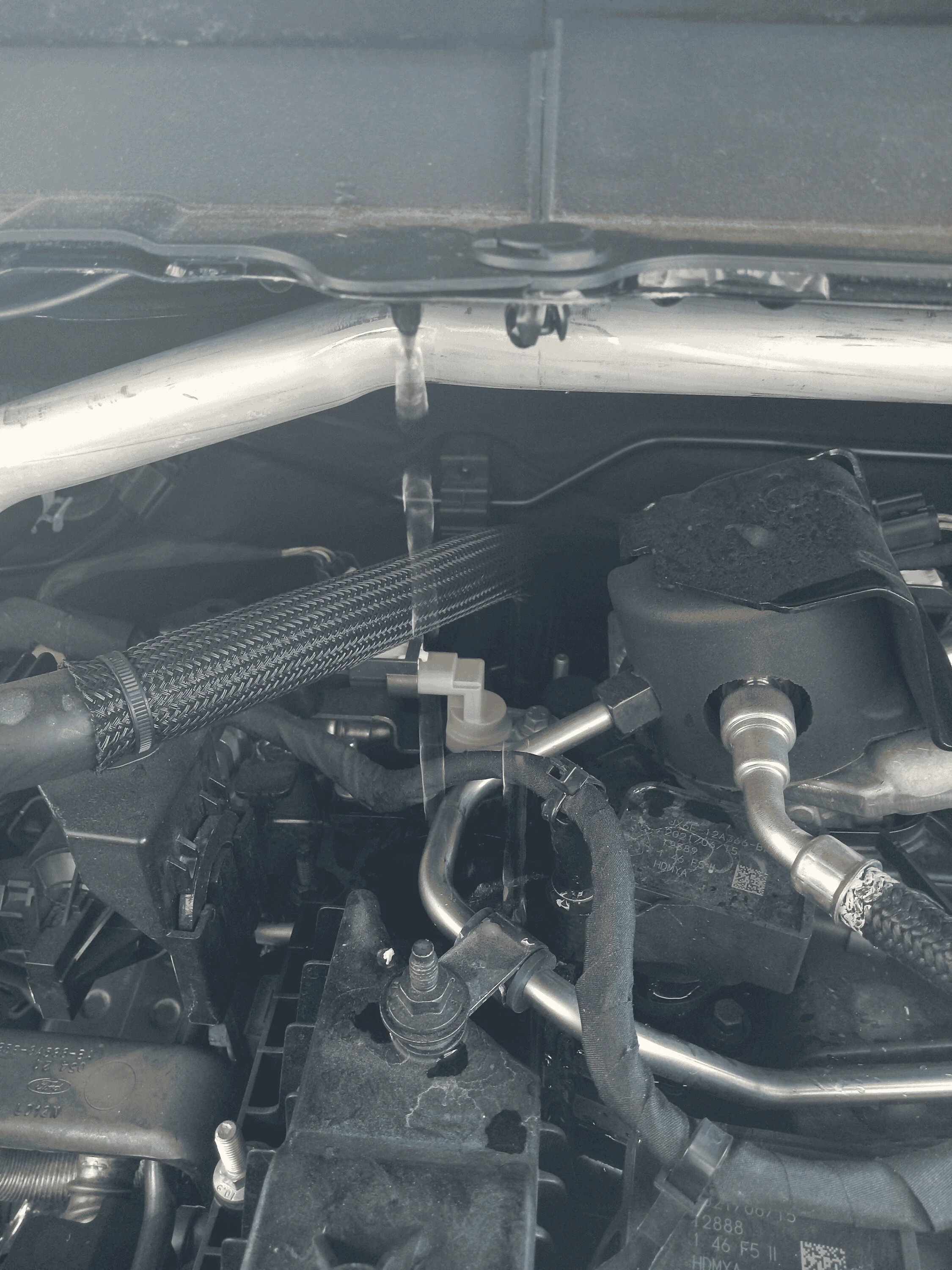

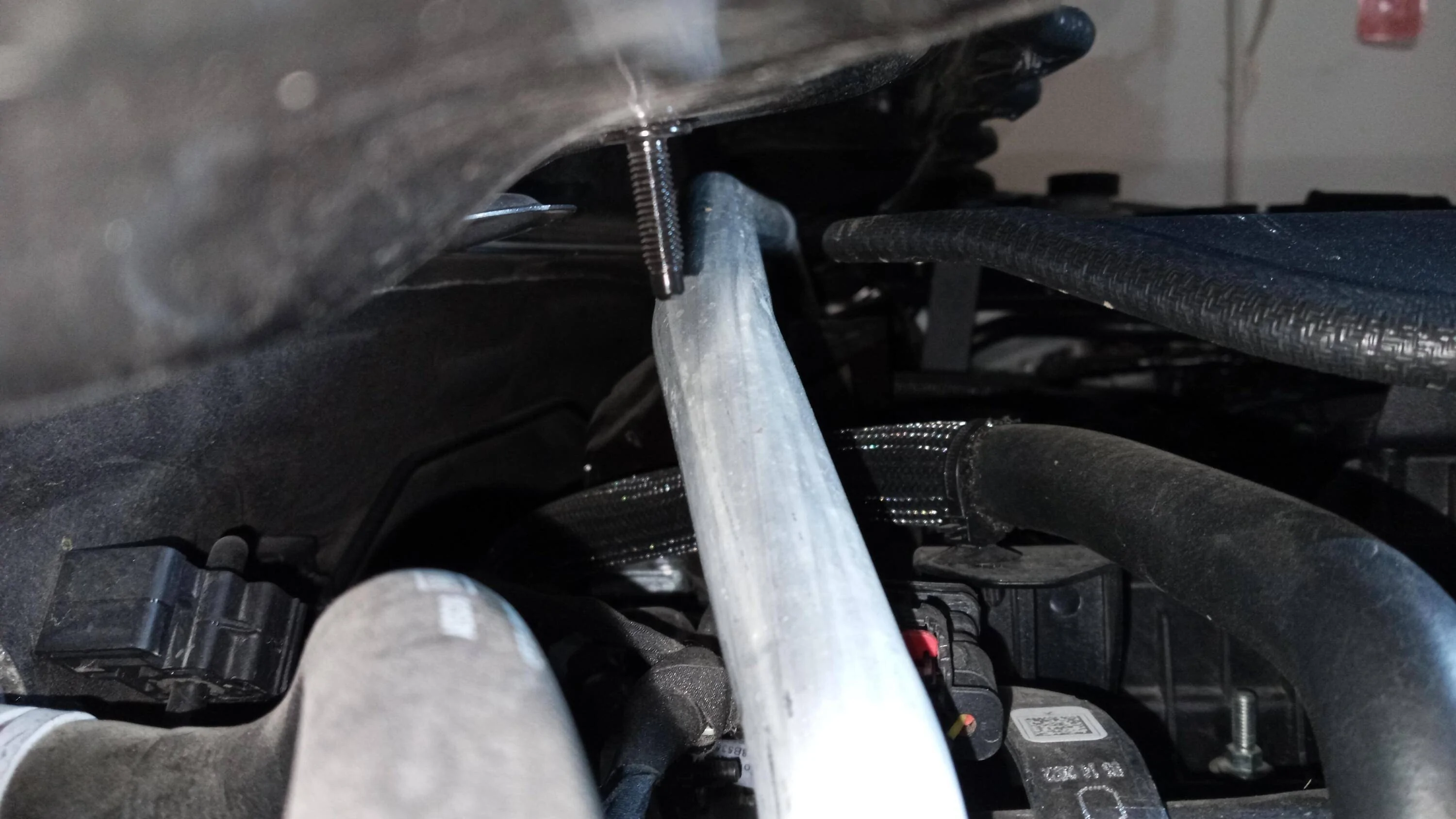

I will try and get one tomorrow. I just used black high temp RTV and squeezed out a dam around that one center clip (I cleaned the plastic on top with alcohol before applying the RTV). That center clip sits exactly over #4 cylinder and just a car wash will result in a puddle of water on top of the #4 coil pack (and down in that spark plug well). You don't have to divert it very far, before it falls harmlessly on either side.

When you see some guy, cleaning his engine at the local car wash with a high-pressure sprayer, you've got to ask yourself.....

Thanks. That edge guard you installed looks pretty good. Question, is the oil dipstick really accessible from thr top cut out? Can't really tell from the picture.
Nah it's kind of a pain in the ass, lol.
You can reach it in an awkward manner, but putting the dipstick back in is a challenge due to bad visibility. hard to find the hole(insert immature giggle here) once you pull the dipstick out (insert another immature giggle).
I uhh... use my finger to feel my way to--you know what I can't keep this mature. It's a pain but not impossible so there.

I don't think the cover will help based on it not being under the cowling where the water is coming in, the water will simply run down the head and fill the plug wells along the way, especially if your parked front end downhill, I also used silicone and pressure sensitive tape to seal up the cowling for a couple feet over the engine. Check under the hood after a good rain, you will see the gasket is wet between the two piece cowling, Good luck, it cost me a new head and an even bigger headache dealing with Ford.

All of the design software they have , the years of trial and error , testing (i assume) and this was the cowl design they came up with ? Crappy fit where it seems together (directly over plugs with deep wells) , then angle it slightly downward and put a nice plastic rivet dead center for a precision drip point ... for the fix ? a sponge on top the engine , but not really in the right spot and not really all that absorbent ...

I really can’t understand how that much water gets in and especially into the rear plug. Today I pulled the engine cover on my ‘19 Lariat after all its life outside and daily driven, and inspected for water intrusion underneath and especially in the back. Things were lightly dirty sure but no evidence of any water, damage or heavy staining. I blew out any small leaf, sand etc. road debris from on top of the cam cover and around the plugs. Put the cover back on and did a solid hose test on the cowl and rear hood to make sure I wasn’t missing anything. The top of the engine cover and the riveted cowl lip under the hood seal, all was totally dry after I tested.
So I suppose as they say YMMV but I could not replicate water intrusion on mine.
