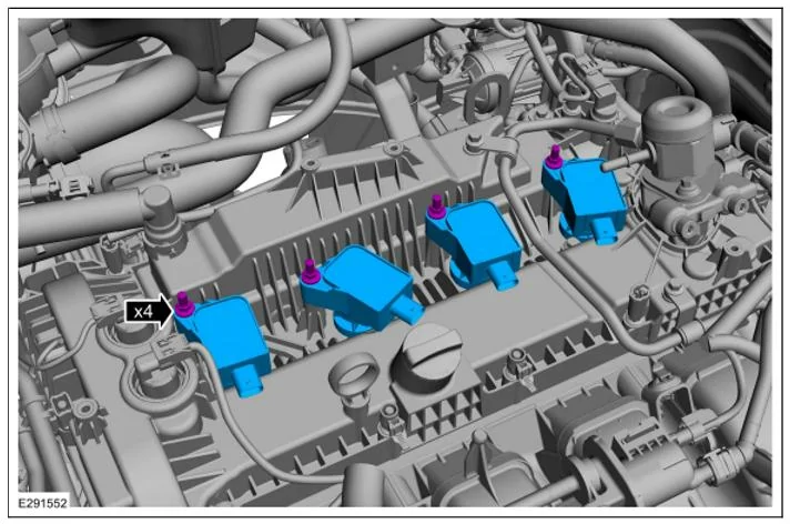

Hey...silly question...why doesn't some plugwire mfg make a proper boot that has a lip that is split and seals the plug from moisture? I am guessing there HAS to be some engineering reason why that wasn't done...but for the life of me can't figure it out...because Hondas are done that way like on my wifes car.
D
The cost is too prohibitive for cheap ass Farley!
D
From what I see, a proper COP cap/seal is already, mostly, built in... if it actually works. However, the plug valley (and then the plug well) is so deep, I'm wondering if it fills up and overwhelms the seal... would have hoped the valley would have a drain but I don't know...
