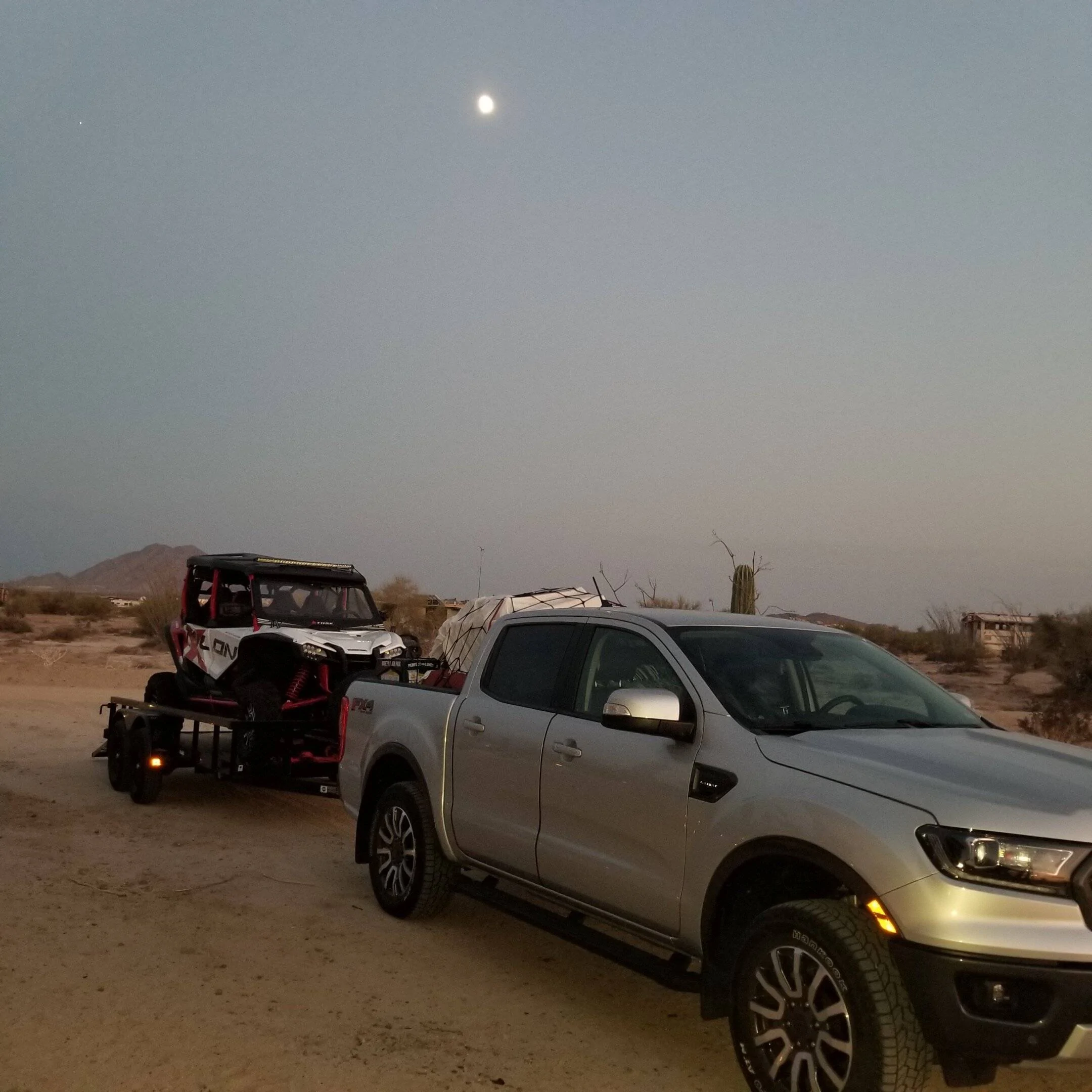

Thanks for the input! Glad people like you are giving feedback. Experience is what I'm looking for.

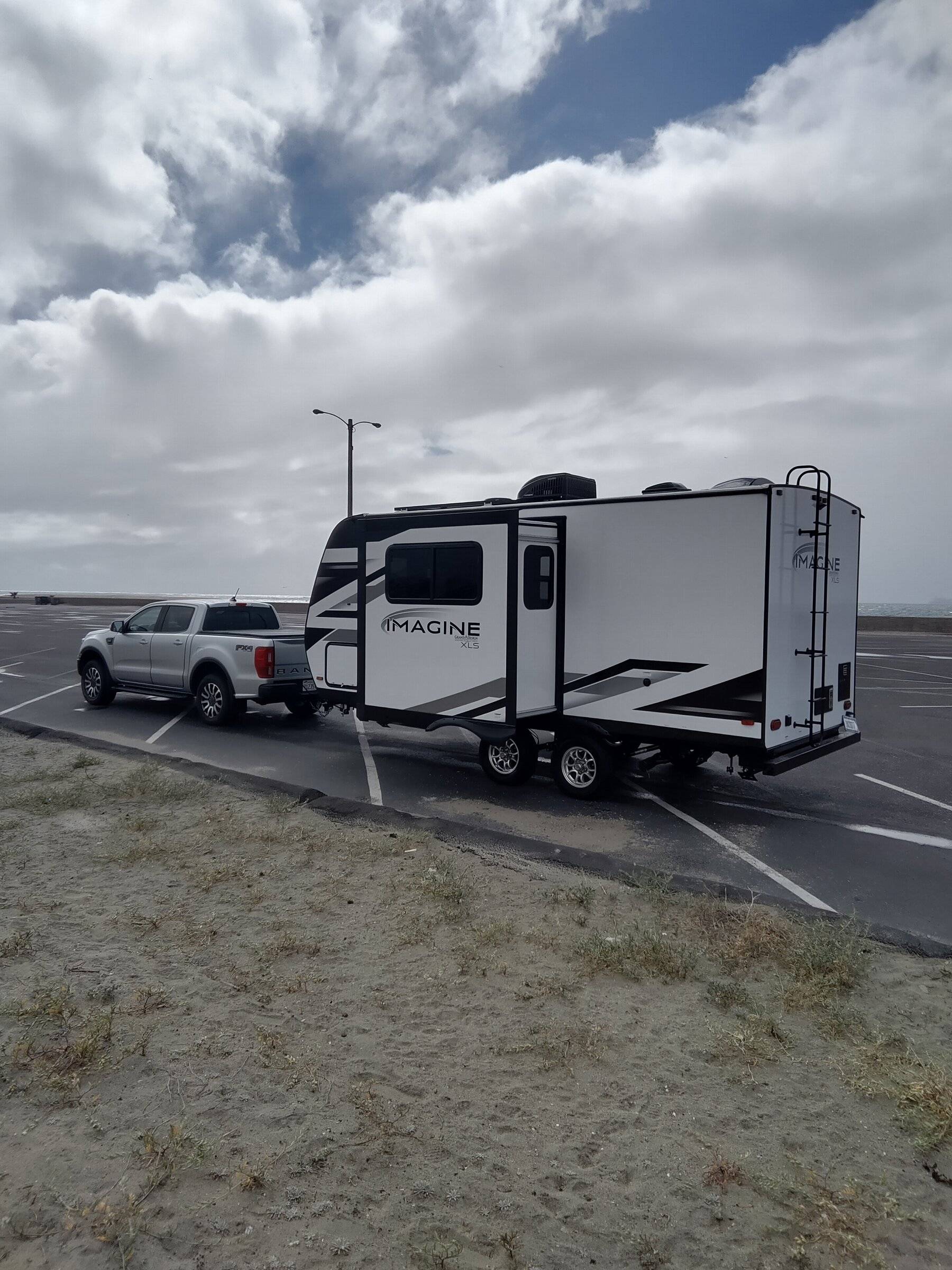

BTW, it tows this great @ ~3500#'s (trailer and SXS), with a fully loaded heavy truck

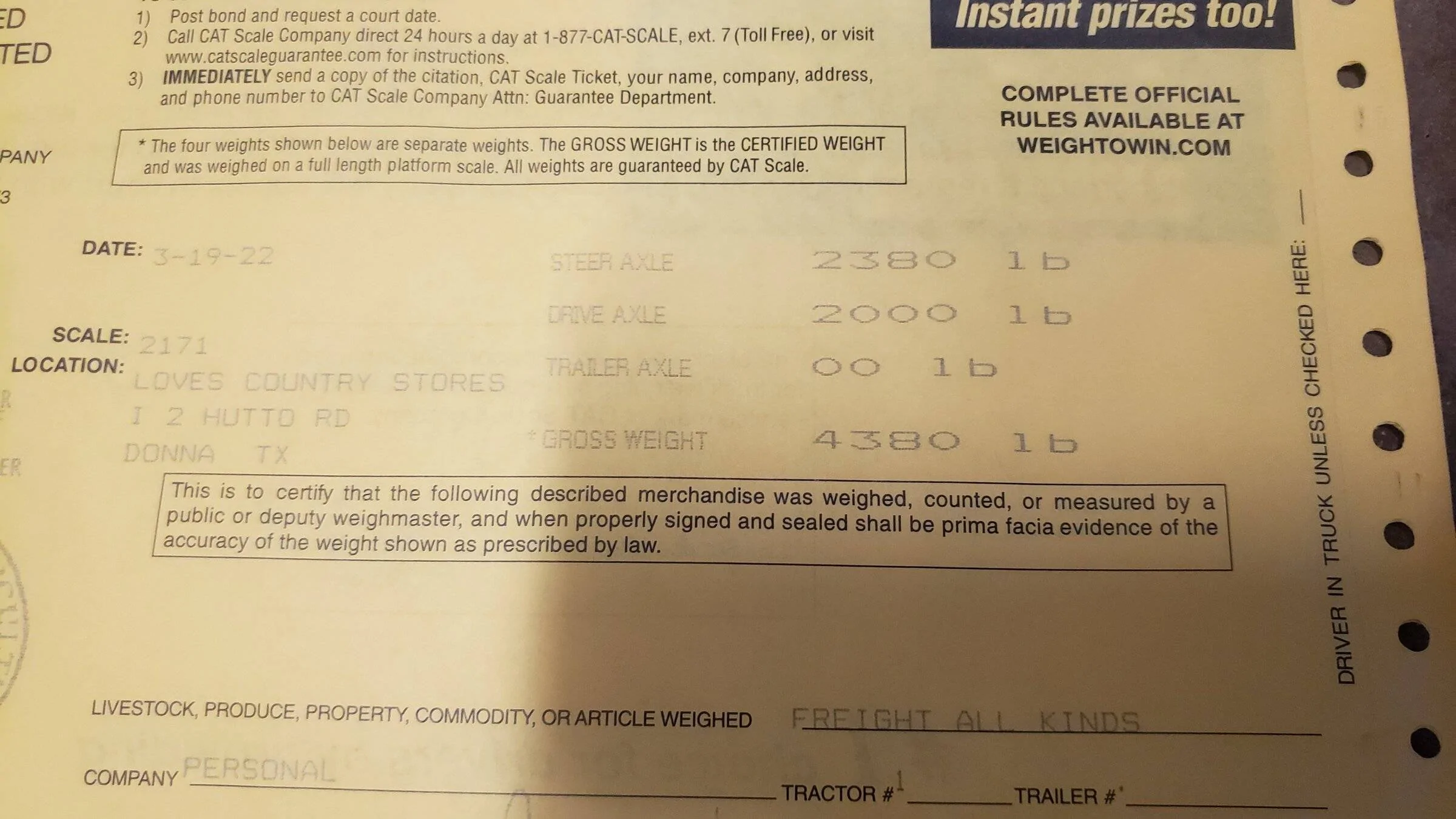

I have a xlt 4x2 2020
This is my weight as i have it with tunnel cover. My gvwr of the ranger is 6050. So that leaves me with about 1600k payload.

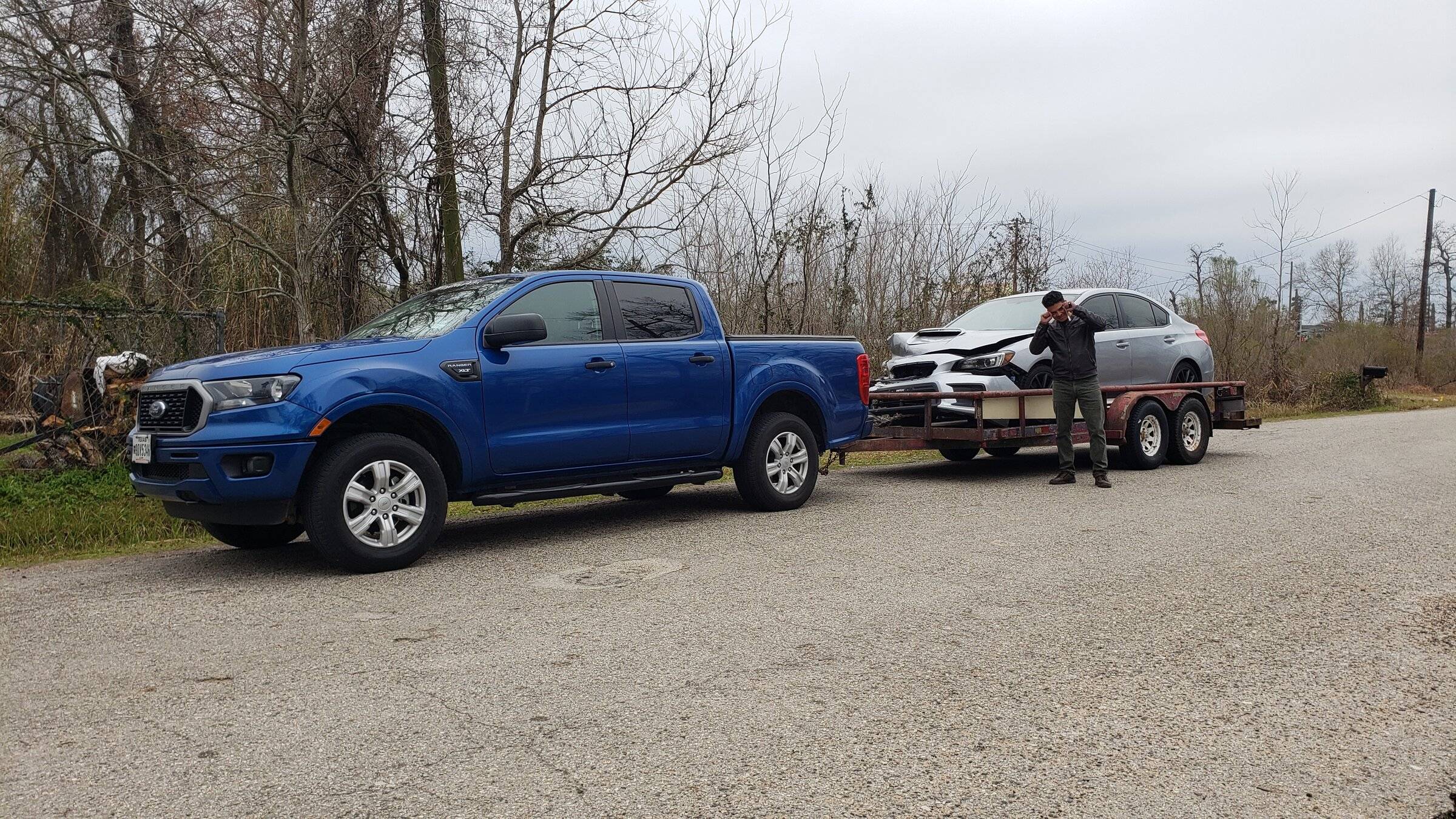

This was my last tow. About 1500lbs cargo to include luggage passengers and tongue weight.
Tow was about 5 to 6k. Dynamics are entirely different than a big giant box tt.
I do not use a wdh. I dont need one.
But if I had a tt, i would use one. Use proper equipment.
I personally never go above 70. No matter how little or big the tow. Always within 60 to 70 mph.
Just tow safe, use proper equipment. Take your time. I am getting old and dont tow at night either lol

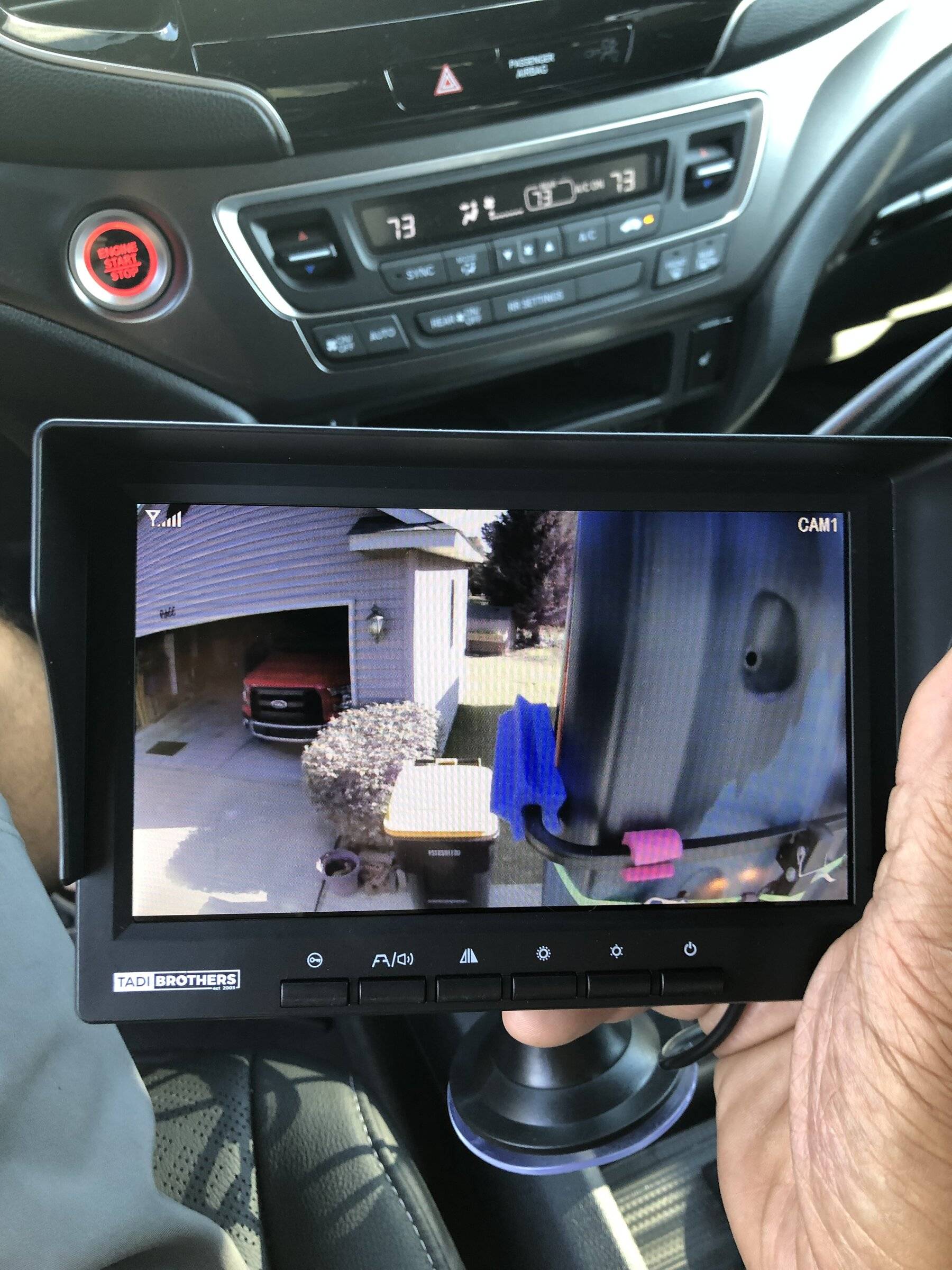

I have no blind spots whatsoever. Mirrors pick up traffic that also shows up on monitor. Towed all last summer with our Passport and never had any issues.
Passport width with mirrors is 78.6”. Ranger width shows 85.8”. So Ranger mirrors should work even better
Not really sure what you are trying to show here.
Most prewired rear view cameras are mounted on the back of the TT and show what is immediately behind you. The Rangers Blind Spot detection won't work for that wide a trailer and the Rangers are not wide enough to see the sides of the trailer so there is a big blind spot at the rear corners. When you need to lane change a rig that size in traffic you need to know exactly where the back of that trailer is. Believe me a gap that big will get filled real fast. No time to check 2 or three different places.

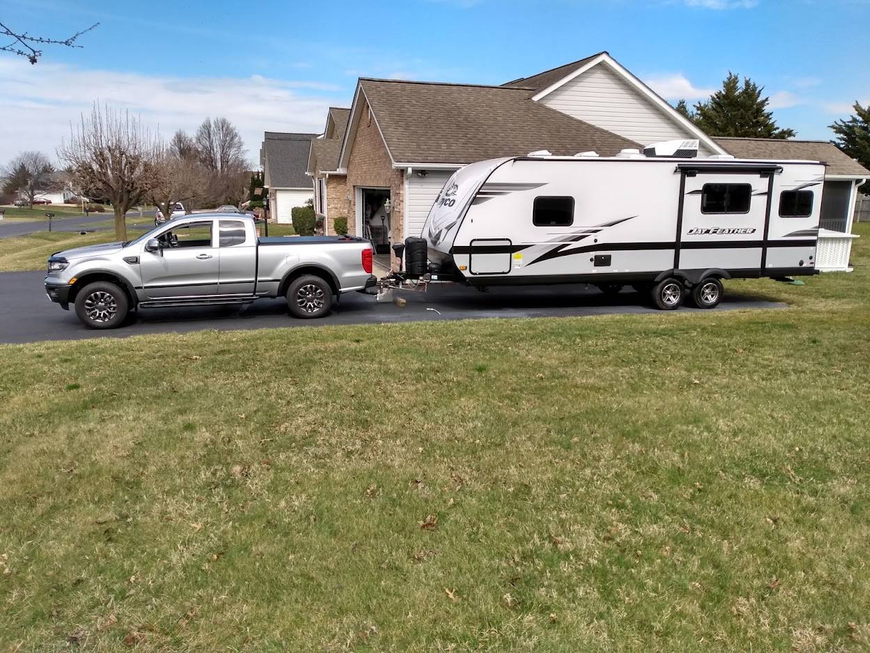

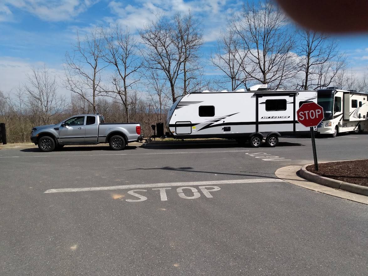

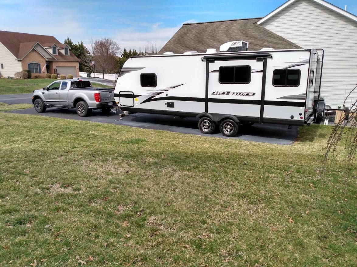

Just picked up our new Jayco 24RL....been on order since last July.
I have posted several times about our plans and the trailer and the Rangers ability to tow something as large...
Well to all you nay-sayers, the trailer came in at 5625 with a battery and 2 full 30 lb propane tanks.
Figure around 6200-6300 with our stuff and a partial tank of water.
As far as towing...I set my WD hitch up and it tows beautifully. Its listed as 29 foot, but its a 24 foot box and 5 feet of front frame. Took it right up on the interstate, hit 65, and it cruises just fine...no sway, no bounce, and the Ranger had plenty of power. Just a bit wibbily/mushy in the back but I think that will be taken care of by a better set of shocks.
Have you towed with the camera setup I’m talking about? I have and you’re telling me I’m wrong? Like I said it works great for me and if it wasn’t safe I wouldn’t be doing it.
Not wanting to get into an argument, but when did I say you were wrong? I just said I did not understand what the picture you posted was supposed to be showing me. I then went on to explain what my understanding and experience was of rear view cameras, and the Ranger mirrors with a wide TT.
Where is the camera(s) mounted? One for each side? Near the front of the trailer? If that is the case that is not a normal rear view camera setup.
