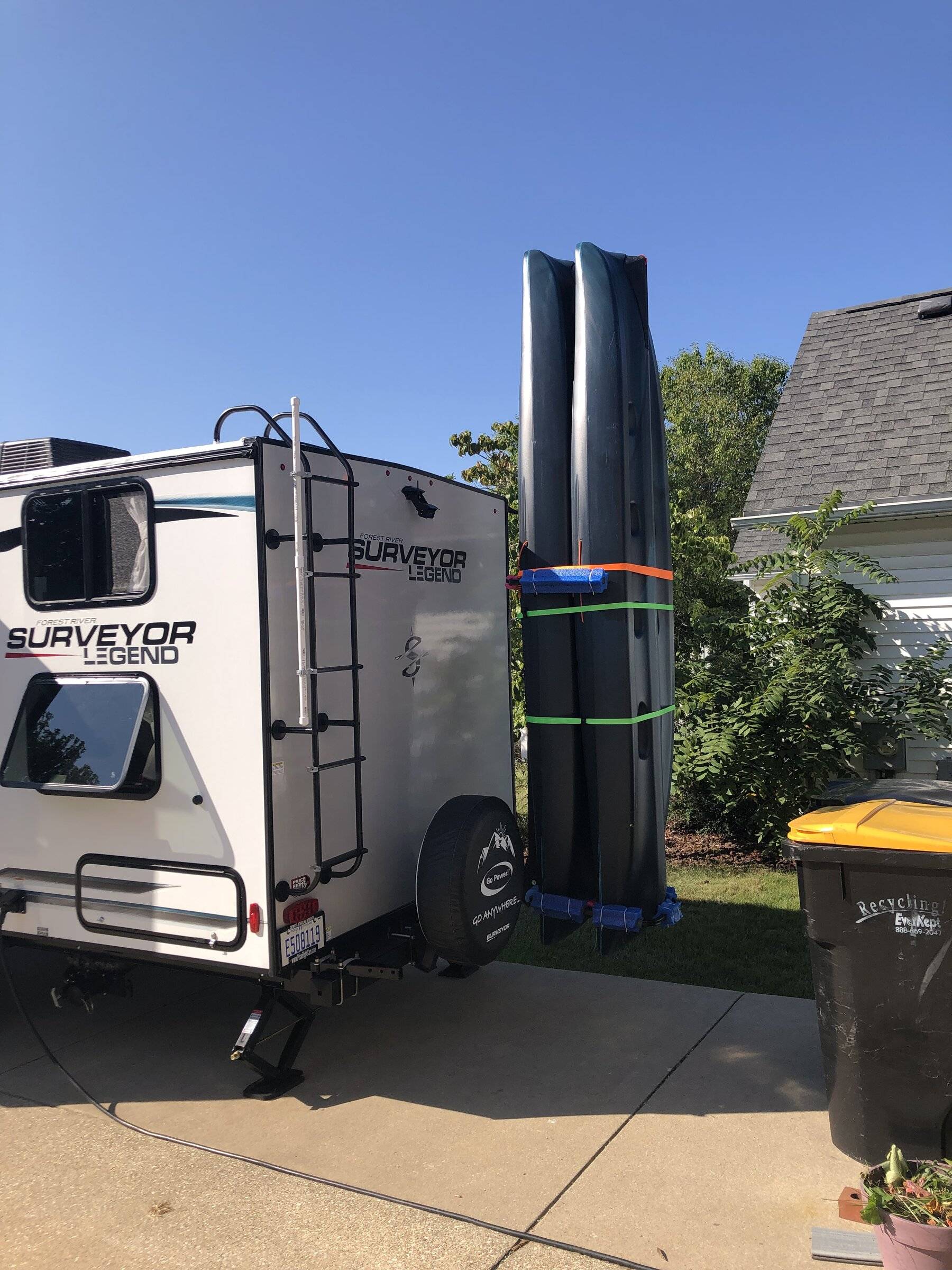

Not wanting to get into an argument, but when did I say you were wrong? I just said I did not understand what the picture you posted was supposed to be showing me. I then went on to explain what my understanding and experience was of rear view cameras, and the Ranger mirrors with a wide TT.
Where is the camera(s) mounted? One for each side? Near the front of the trailer? If that is the case that is not a normal rear view camera setup.
Camera is mounted up near roofline at rear of trailer. Angled down with 120 degree view. Pretty much shows me everything off the corners of the trailer. So anything the camera doesn’t see is in my rear view mirror already. Saying that vehicles are in my rear view mirror before leaving camera view. It takes some getting used to but so does everything else. So the picture the F150 in my garage would also be in my mirror if that makes sense. Sorry if I came across harsh.

That makes sense. Now that I look at it again with your explanation. The picture you posted is a liitle confusing as it looks like you have the trailer backed up to something on one side, blocking that side of the camera, and I don’t see any part of the trailer for reference.
Yeah that is a VertiYak kayak rack with 2 11’6” kayaks trailer bumper mounted. That goes away once we’re pulling with the Tremor. Kayaks will be on a bed rack instead.
For reference

That helps even more. I also can see where it would take some getting use to though. Having a single monitor showing vehicles coming at you. While the view out the front window is vehicles traveling with you. Also still need the wider mirrors with a wider trailer.
