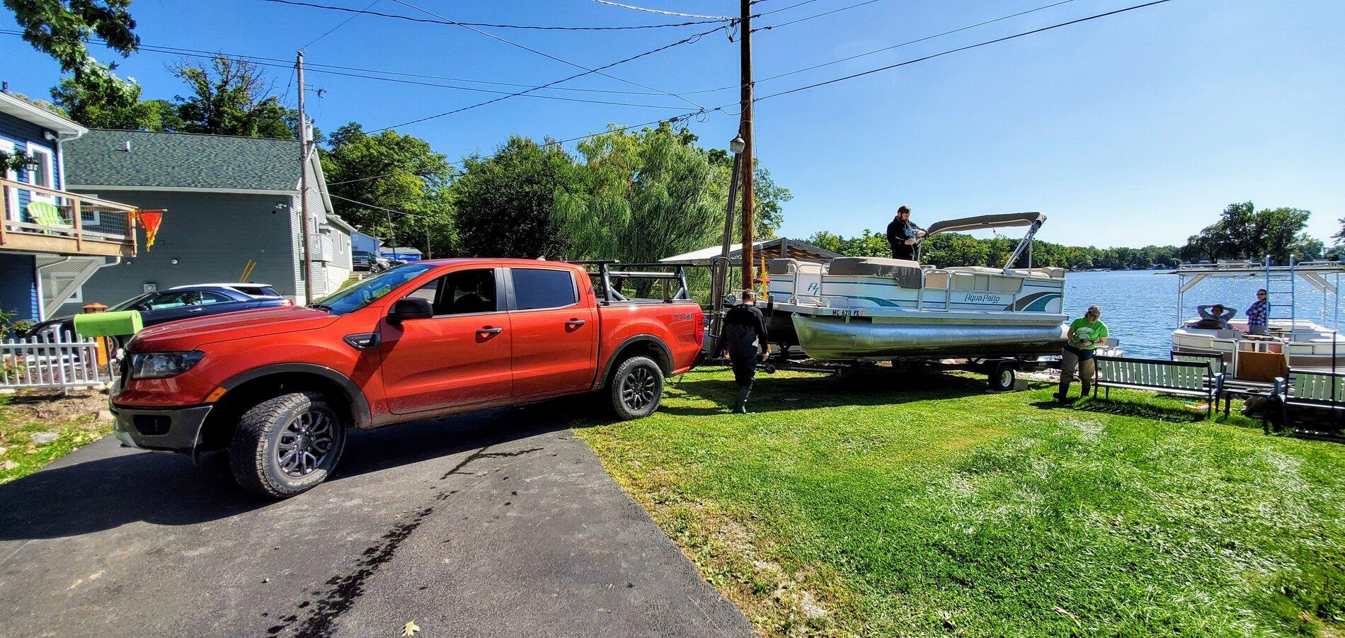

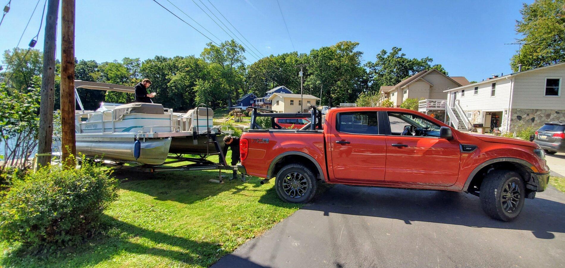

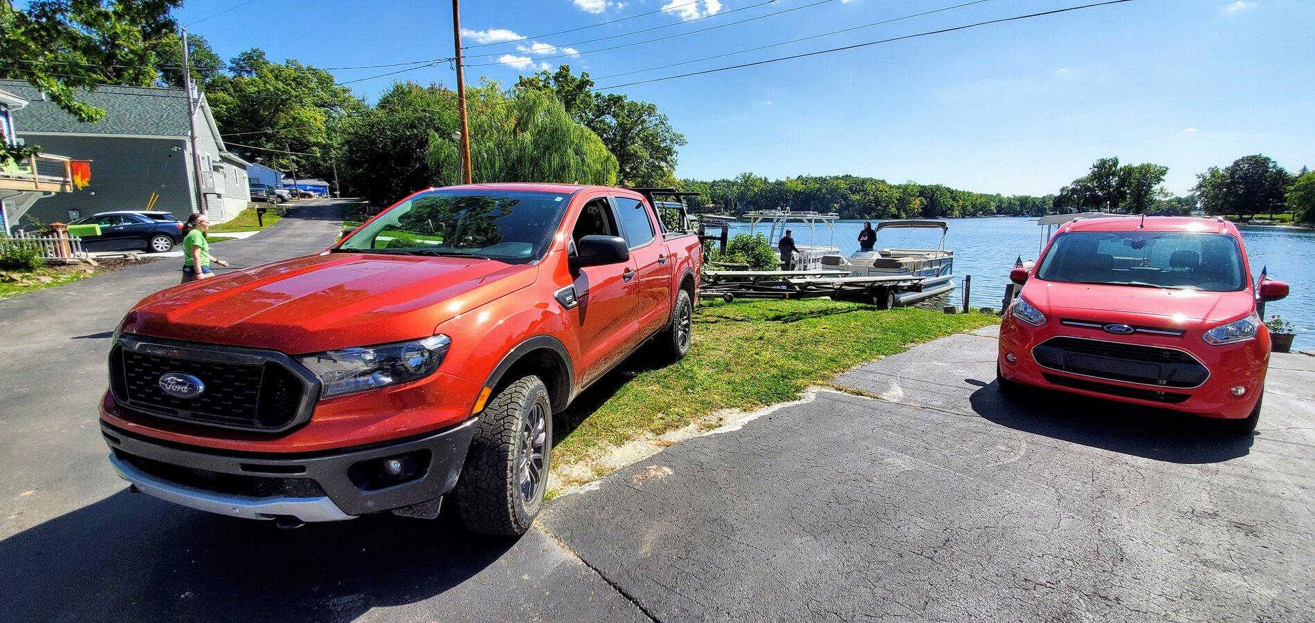

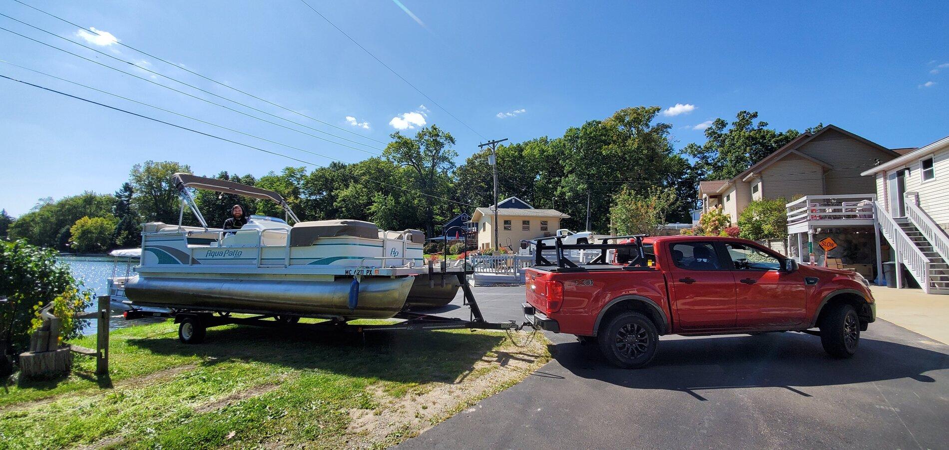

Not towing far, but still using the hitch! Moved a few boats around and getting them pulled out of the water for the inlaws this weekend! Ranger once again did awesome and barely even broke a sweat! And being that the space ya have to work with on their street is so small, Ranger was the perfect size and strength for what we needed to do! Moved the small speed boat over to the driveway and didn't even notice it was there, and then pulled the 21'/22' pontoon out of the water and moved it over out of the ramp! And the pics don't show it either, but the boat ramp was on a fairly good angle (forgot to check in inclinometer in the dash) and you are either some soft mud/sand or loose gravel. along with the a steep drop off about 12' off from the shore, so definietly not an easy pull! But no sweat for the Ranger!

As you can see, not a lot of space to be working in, but Ranger was the perfect size to get it done! Additionally, had to do some strap work and rigging and drag a pedal pontoon out of the lake from the ramp and an 8'x10' swim raft which neither were light! So the truck definitely got a very good workout in this weekend! And did it flawlessly! And it also hit 20000 miles too!

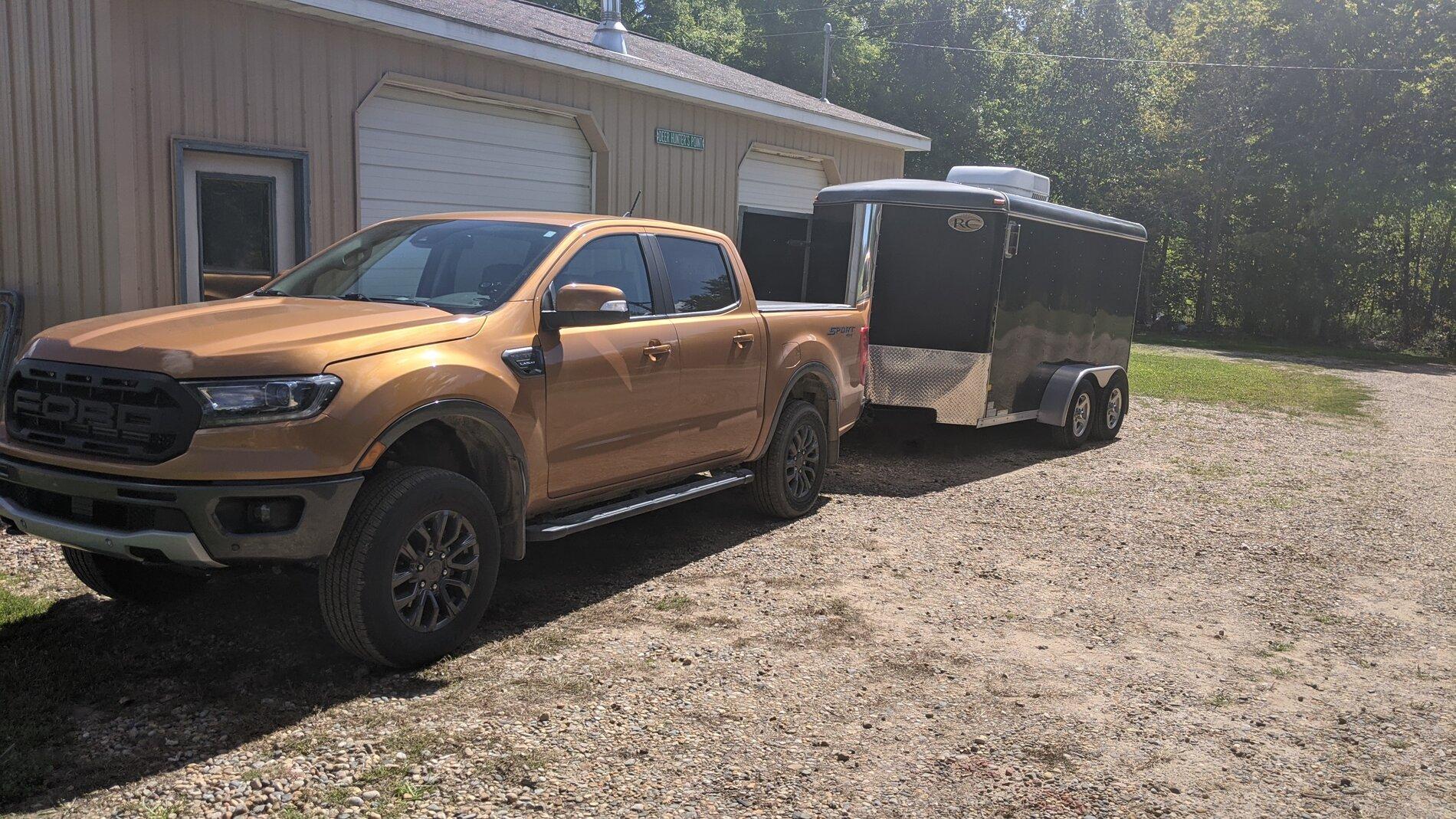

I've got a 6x12 v-nose RC brand enclosed for hauling my motorcycles to the track anywhere in the country. AC unit on the roof and, as of last weekend, its own electrical system. Trailer is like 2400# empty. The weight distribution hitch makes a WORLD of difference in ride quality. As for power? No problem

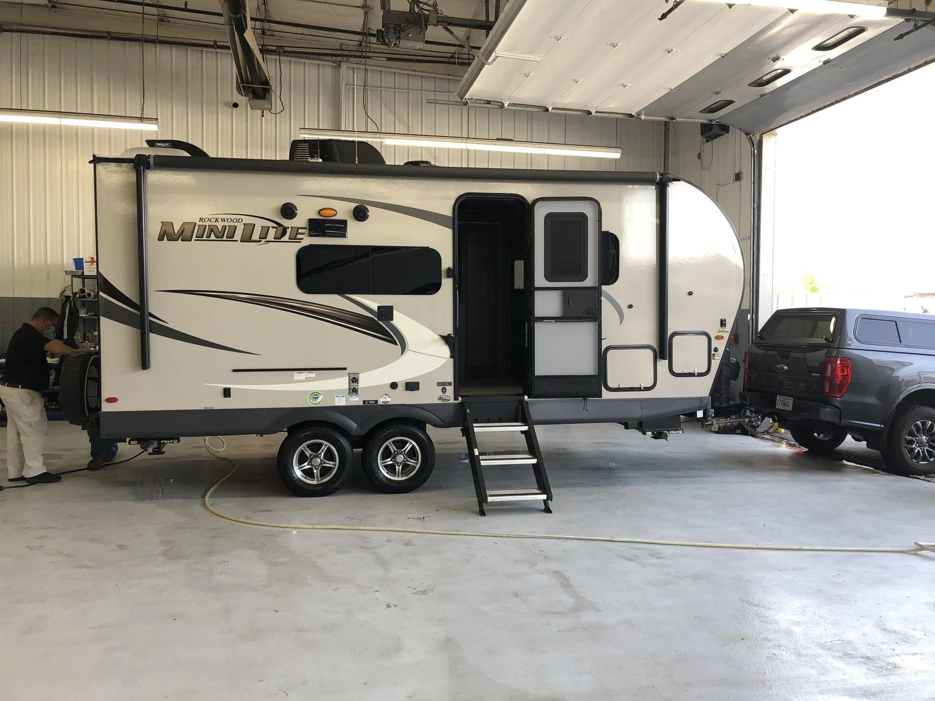

Just brought home a 2021 Rockwood Mini Lite 2104S. Dealer installed the weight distributing hitch and it towed nicely. GVWR is 6k lbs. Truck pulled OK and 65 mph wasn't a problem, though mileage on this first run was 10 mph. Hoping for better. Maybe have the wife get out and push a little.

I don't know. 10mpg is pretty much on par with what I would expect for pulling something that heavy and in the wind. My father-in-law has a similar size and shape camper and gets around 9mpg towing it with his Silverado 1500.

I would try locking out the top gear or two and certainly slower highway speeds would help MPGs.
Edit: My previous truck was a 2014 F150, 5.0 FX4 with a 4" lift. I towed my toy hauler with similar GVWR and speeds so I got 8 mpg. I locked out the 6th gear and hwy speeds were 55-60. The MPGs went to 11-12 almost instantly. Tail winds helped a lot but they always seemed to be head winds. Go figure
