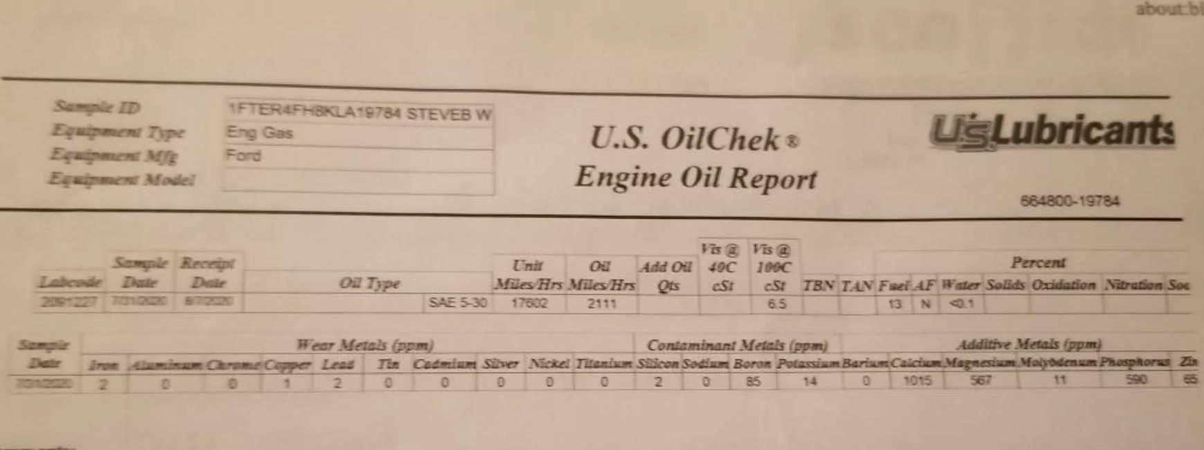

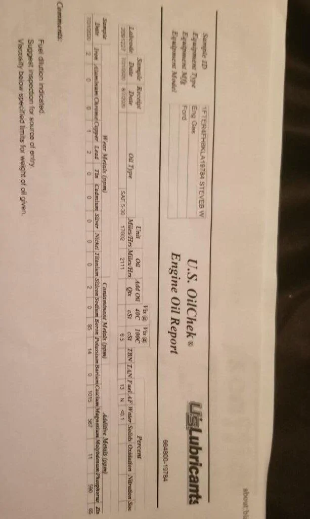

Update, I picked the truck up this past Thursday. They replaced all 4 injectors for a second time and the service report indicated they had done both a compression and a leak down test as well as inspected the HPFP, which was replaced this past May. The tests all came back within spec and Ford just recommended changing out the injectors again. Of course, they did not have time fix the AC, I will need to schedule later for that. I also got the latest oil sample report that they sent out. It was the oil that was changed right after the first time they changed the injectors and HPFP and had 2100 miles on it. The sample indicates 13% fuel dilution which was worse than the last sample that was 12%, but that oil only had ~500 miles on it.
Well, I've got ~200 miles since Thursday and the oil level has risen again to the max hole, about a 1/10" each 50 mile round trip to work and several weekend trips. Ford customer care told me if it was not fixed this time they would initiate a buyback. This stinks, I really like this truck. I will drive it another week and see if the oil continues to rise. I am wondering WTH is going on, how is it that they cannot figure this out? Anyway here is a copy of the oil sample report. It clearly states high fuel dilution, but I do not know if the other numbers are worrisome or not as I do not know what they should be?

Wear metals look good. Viscosity is low for a 5w-30 or even a 5w-20. It should be around 10 cSt. Fuel dilution is high as you know. Should be less that 2% and lower is better. I didn't see flashpoint but would assume that is low also because of the fuel.
Thanks for the info, yes it says the viscosity is below the specified limits, but I am assuming that if the wear metals are low, it has not harmed the engine yet? I sure wish Ford could diagnose the cause in my case. Unfortunately, the Ford Customer rep told me that if it wasn't fixed this time, they would initiate a buyback and with ~250 miles on since the most recent fix attempt, the oil level has already risen to about an 1/8" over the max hole. Even though there are a few of us on here with this issue, it does not seem to be widespread, and I like the truck so much, if I have to go the buyback route, I will push for a replacement.
Based on the wear metals I suspect your engine has not been harmed yet and would likely be fine if Ford could ever figure this out. The 2.3L EB engine has been around for a while. You would think the bugs would be pretty much worked out.
