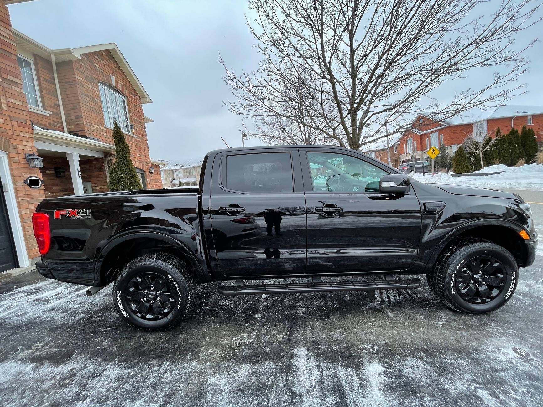

Hey folks. So I've done a lot of searching and have come up with whole a lot of inconclusive. Wondering if I could get anyone with a similar spec's perspective.
I've got a '20 Lariat FX-4 with the BAP 18s. I'm going to level the front with ReadyLift 3" and lift the back with the 1" block. I want to put a set of KMC545 Trek 17x8 +18mm offset on Falken Wildpeak 285/70/R17s.
What's the rub situation here? Anyone with a similar spec?
(how she looks currently)
I installed the 2.5" leveling kit on the front of my my 2019 Lariat and I'm running 285/65-18 without any rubbing issues once I removed the plastic air dam. Crash bars are intact and my rims are a +30mm offset. The 285/70-18 are about an inch taller, so might rub some. Hope this helps.
