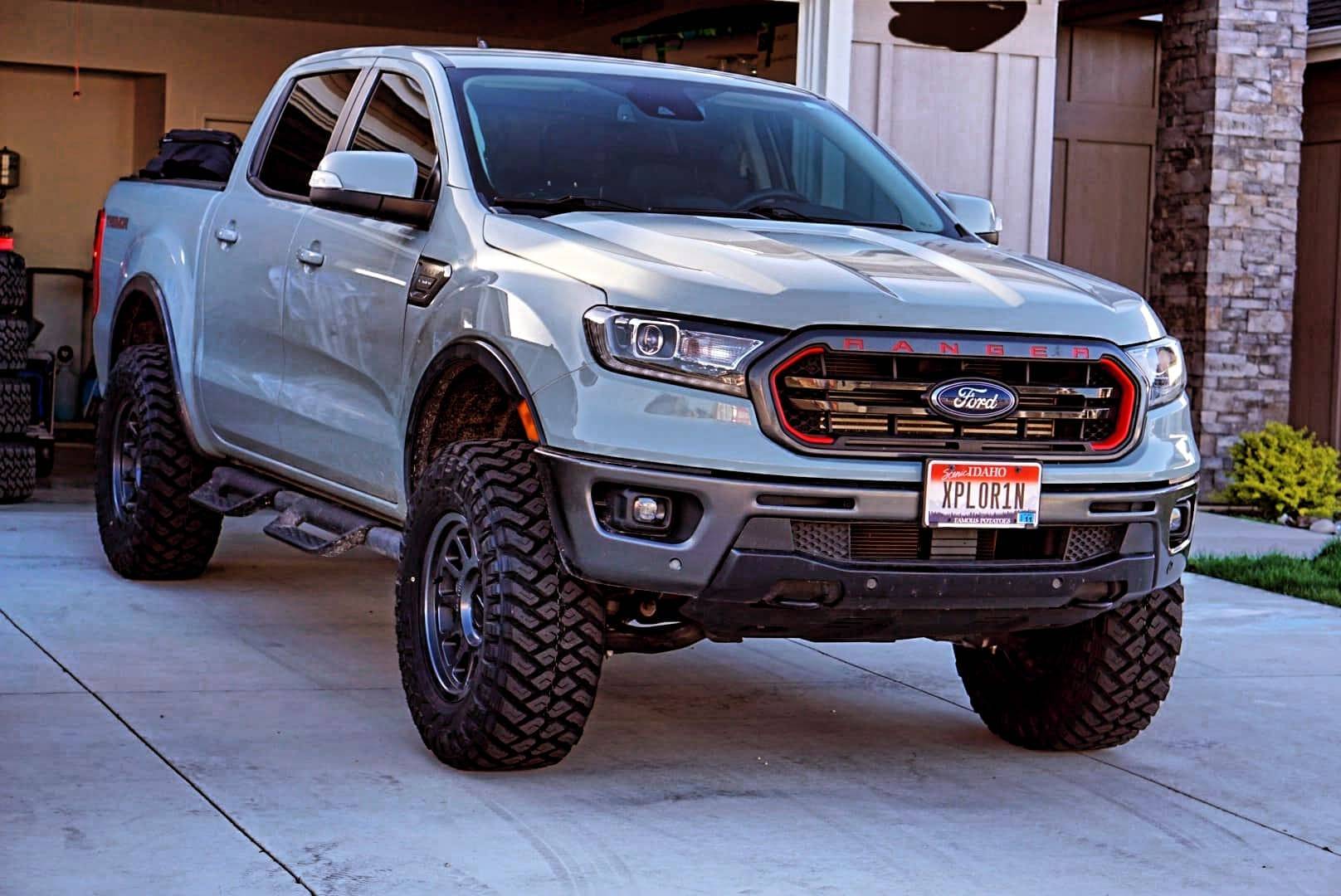

Love the pizza cutter tires!! Much more contact front to rear vs side to side. The longer tire works for me anyhow, does not seem to eat my mpg either. I have a smaller 255 75 17. Its an fx2 all stock, except for my tailgate assist, and they make a huge difference

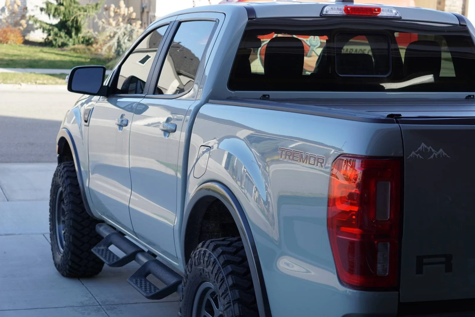

Truck looks awesome. What tires are those? Red tow hooks and black ovals and you would have the perfect Ranger. Just kidding-sort of. Super looking truck.
Thank you! The tires are Maxxis Razr M/T.
Red tow hooks would look pretty good. ?

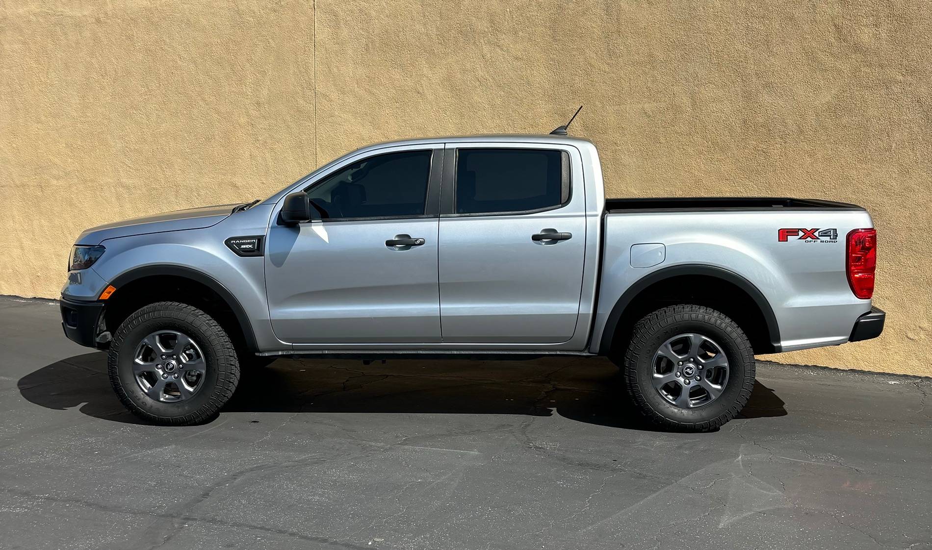

255/75/17 on bronco wheels. Front has the SVC collar which gave almost 2 inches if I remember correctly? I’ll have to find my measurements. Rear is stock height.
No rubbing, no crash bar mods. Should have gone bigger. Next tire with be 255/80/17 and hopefully new front shocks with a little more lift.

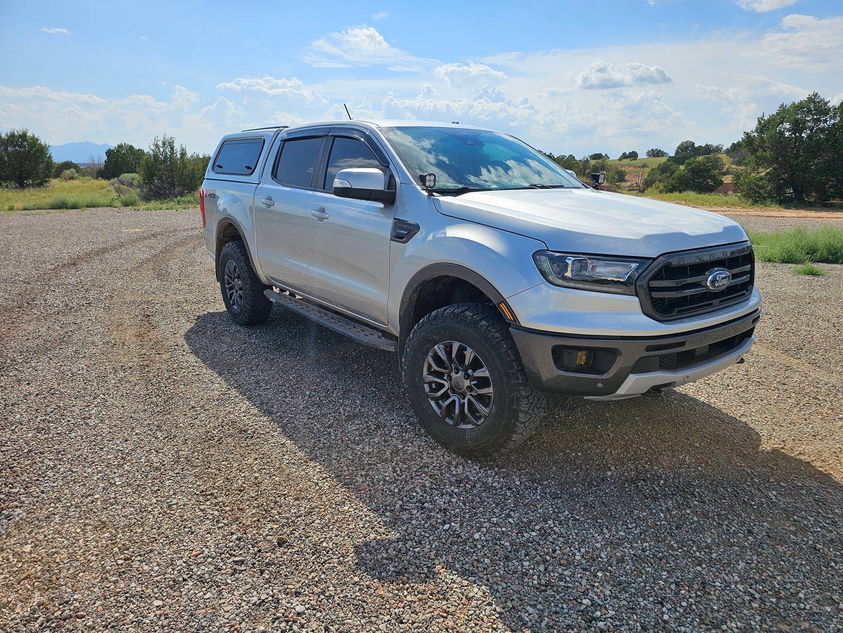

I almost went with the 255/80/17 setup, but ended up needing tires sooner than later and opted for 275/70/17 KO3's. So far quite pleased with them especially compared to my worn duratracs... although the duratracs don't know nearly as much gravel
Have you had any issues with rubbing with that size? That's the exact tire I was considering for my '21 Tremor...
Also, how's the road noise with the KO3's? I've got the General Grabbers on my truck right now and it's terrible.
Good news, road noise is not an issue with these. I came from worn duratracs and those things were singing at anything above 35. These KO3's are about as silent as you could want from an aggressive all terrain tire. I forgot what it was like to have a quiet truck on the freeway...
The bad, I did have a bit of rubbing. I'm running 1.2" spacers (approx. 30mm), and i had rubbing on the front crash bars (also my old rokblokz mud flaps, but those had a nasty curl so not really the tires fault), and I just threw in a set of the ReadyLift intrusion beams and everything is good to go now. It seems that these new KO3's are running at their advertised size more so than the KO2's did. I slapped a tape measure on them and sure enough they're sitting right at 32.2" best i could tell.
