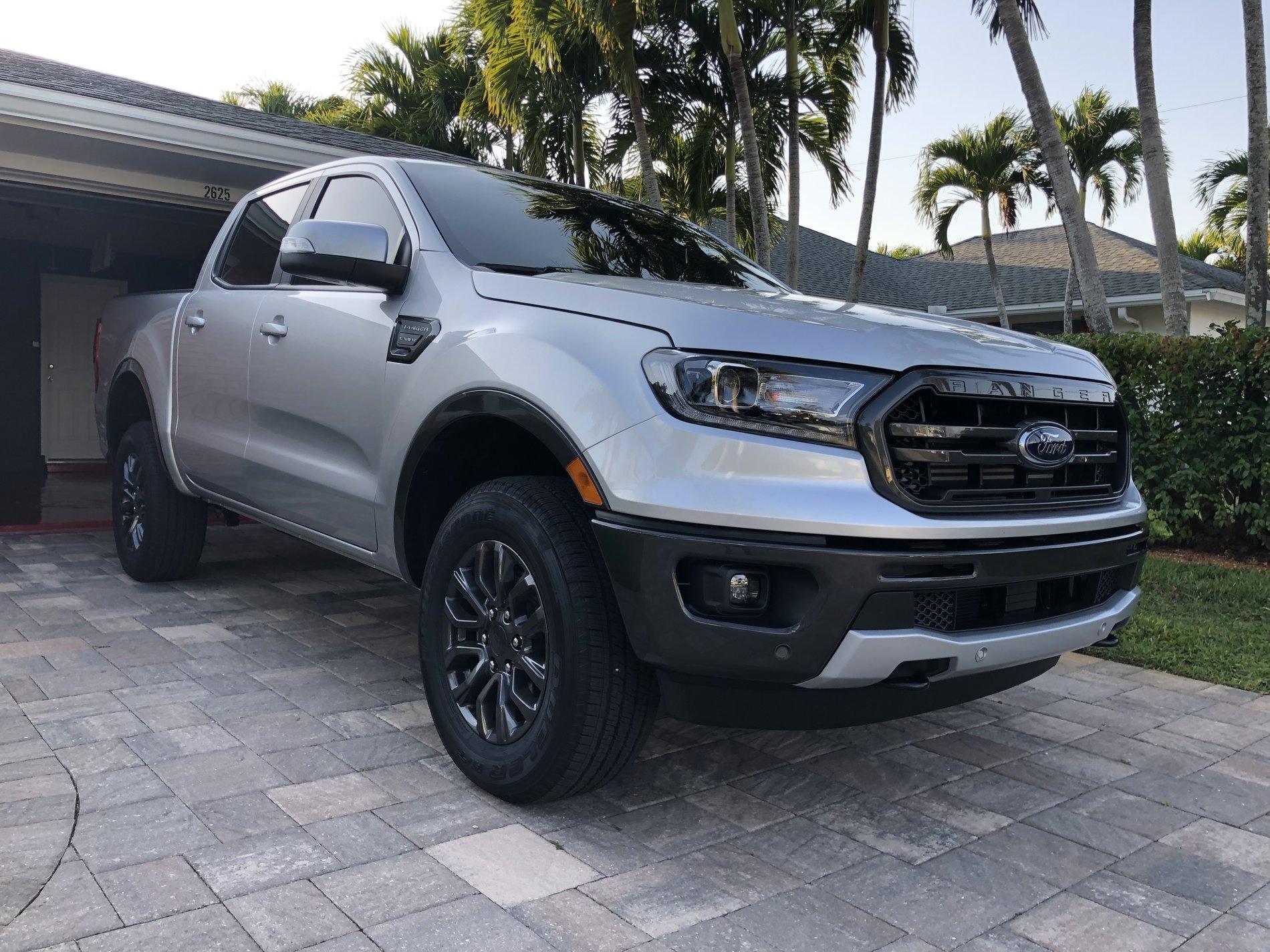

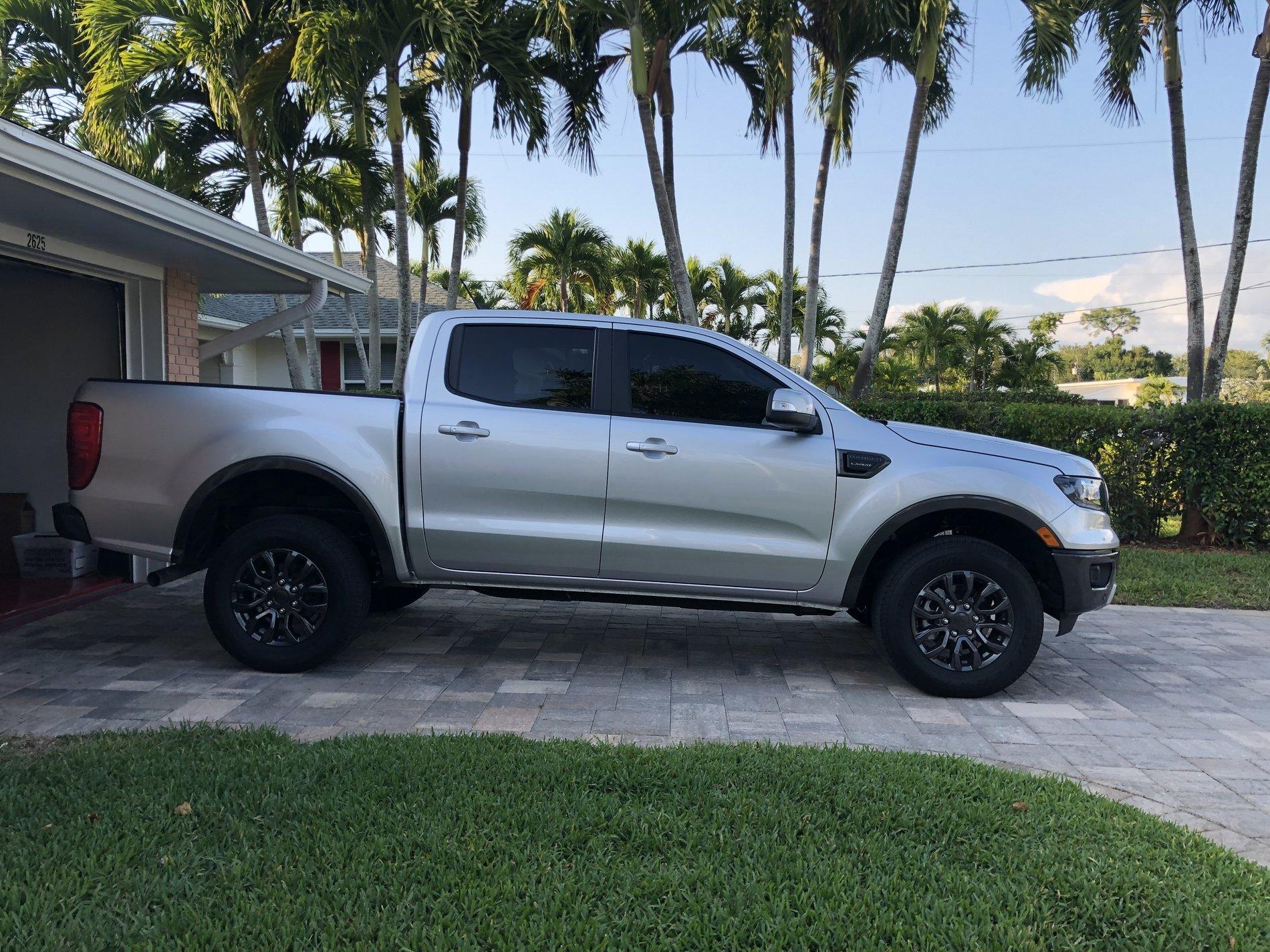

FlRanger
Apr 4, 2019
183
305
South Florida
2019 Ford Ranger Lariat
Interested too. Should have my truck in about a week. Tires will be the first thing.
Let us know! I like my color match rims but would definitely like some beefier tires.
