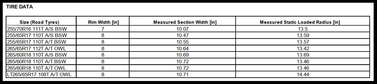

To bring it to the same clearance as factory, you need a half inch spacer or a wheel with +40mm offset. Factory is +55mm.
Your Tiresize.com report shows a 255 factory tire going to 285, but the factory tire is 265, so it's 20mm up-sizing to go 285, not 25mm.
A 10mm (3/8") spacer, or +45 off set rim will put the 285 tire, back to the same space from the spindle as factory. I know it's not a big difference, just pointing out the 255 type-o.
