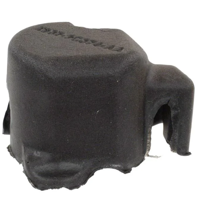

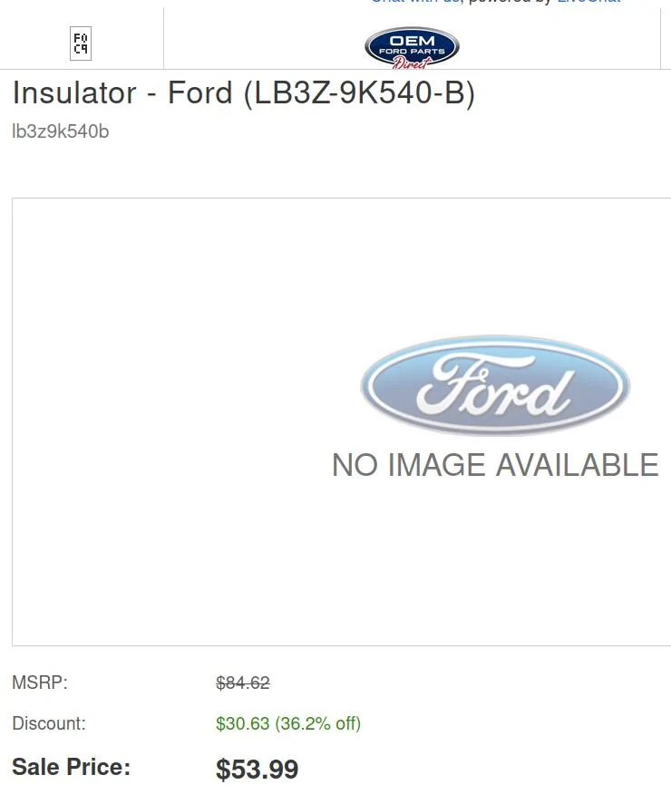

Saw this on Facebook where someone noticed the new rangers have a cover on the high pressure fuel pump. lt supposedly fits the 19-23 and drastically reduced the pump noise. It's made of the same material as the engine cover. Might also p
rotect that area from the famous drip onto the engine.
Ford Part LB3Z9K540B

Just priced it at several places $85 list, and found it for $60 shipped to my home. I'll pass and listen to the sewing machine.
Where $60 shipped?

Hmm - So the 3 questions are.
How much does it reduce the noise of the HP Pump?
It is worth the investment?
Will the cover hold heat (internal) to the HP Pump and be a detrimental factor in the electrical function of it? Even though it has (cool) fuel running through it, it may make it hotter by encasing the heat from the engine. (just a thought) and wonder if engineers tested this theory.
The pump itself has a cover. It's the same material as the engine cover. I can see it on my 2019.
It's this....
https://parts.ford.com/shop/en/us/fuel-injection-and-pumps/cover-opening-23l-p-kb3z9d440b
KB3Z9D440B
Since it's directly on the pump, maybe it's there for protection from heat.

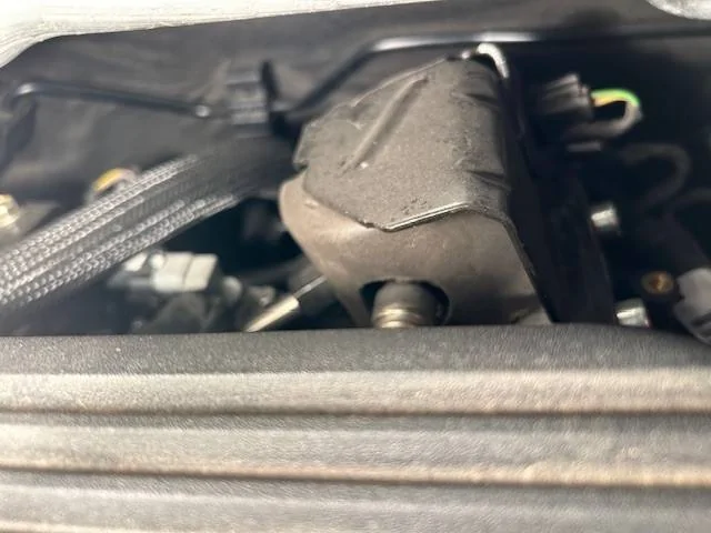

I never actually looked closely at mine until today, we do have a cover already, but it appears they either removed this one or they installed the (new design) cover over the existing cover and bracket.
Bracket Purpose? - Protect the pump is my guess.
I hit it with my Stethoscope and the bracket actually enhances the sound (makes it resonate)
so, I am thinking they added the cover over the top of the whole thing to tamper down the resonation as I cannot see engineers removing that bracket.
A quick shot of mine on my 22
Heat shield
https://parts.ford.com/shop/en/us/heat-shield-23l-p-kb3z9a397a?pdp=y#/sectionId:141076126
