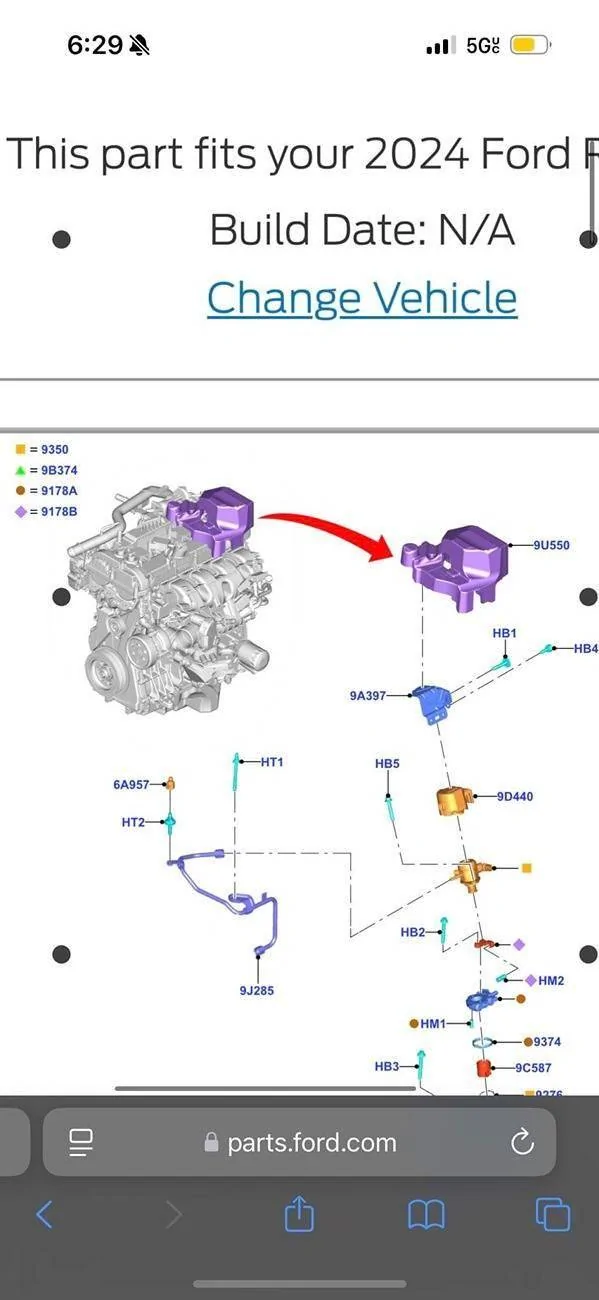

The new rangers have a cover/insulator over the high pressure fuel pump.

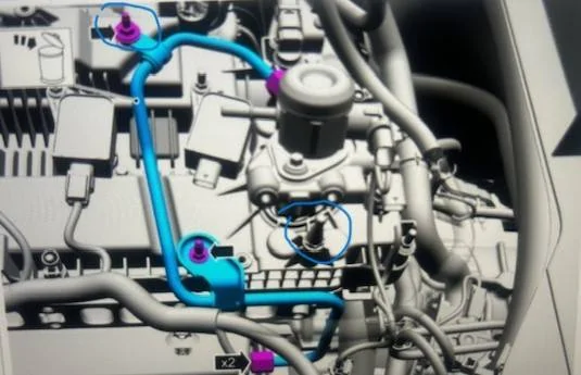

I see the same part number in the 1st post. It hasn't been removed.
Figarou
Mar 22, 2019
2,408
13,795
The tube/fuel line assembly is not the same. Look closely at the 1st picture. It looks longer so it can have space for that cover.

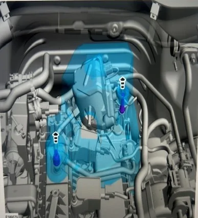

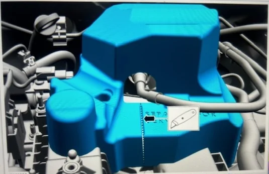

Ok, I dug a little deeper and I should have done this prior to my last post.
I looked at the 2024 Manuals, they indeed added a newly designed cover over the whole assembly.
Ref: The Pic below, to replace the HP Pump they have you cut the cover (as depicted)
and below this cover is the bracket assembly and the existing HP Pump Cover.
So, the PN posted above is for the same cover we already have installed (the smaller cover)
So, the first post P/N appears to be the correct PN - just cannot find a true parts pic of it in the IPC's.
And if you are paying close attention to what that cover is covering.
It is covering #4 COP
So will the rainwater drip on top of this and roll off? or still find its way down the sides and end up in the same (well)?
Either Way - They are addressing it with this cover - will it help?

I dug deeper, and pulled up - COP Replacement
It appears that it mounts down over studs, like the engine cover, they do not have you cut it for this (COP Removal)
The Manual Calls this: Fuel Pump Shield
Note: It mounts over the existing (as installed) parts and covers #4 COP

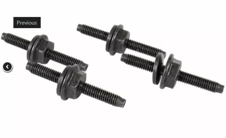

My question is....are the studs for the engine cover and the fuel pump cover the same?
I did some digging of my own and it seems the studs are different.
These are the engine cover studs.
And these are listed as the studs for the 2024 Ranger
I hope it DOES come with studs. If not, and the ones for the engine cover are to short, you may have to order these.
https://parts.ford.com/shop/en/us/stud-m6-x-60-105-p-w720987s437?pdp=y#/sectionId:1020065487
Part #: W720987S437
https://parts.levittownfordparts.com/oem-parts/ford-stud-w720987s437

That IPC pic does not show the installation studs for the (New Cover)
The IPC shows the studs for the existing HP Pump & Cover (Only)
It is lacking that information

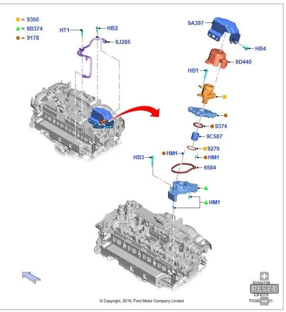

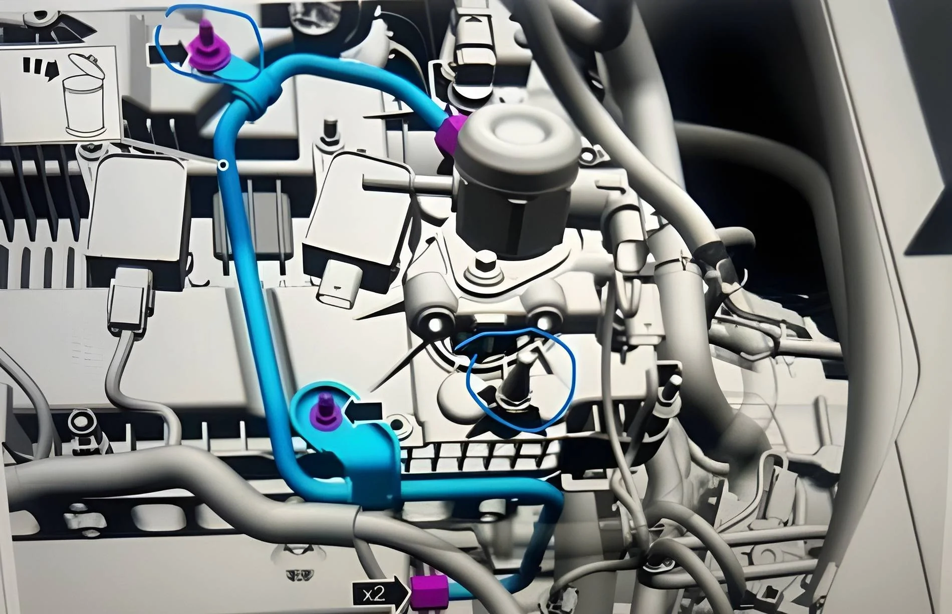

I don't know what happened, but my post got cut off and auto posted before I was finished. GRR
If you Ref both of these pics, you will see the mounting points.
New Cover IPC
2022 - IPC
The 2022 has an existing stud at location HB2 (in the 2022 IPC) the IPC has is as a bolt
Verified (on truck) and has available threads for the (Nipple Top - Special Stud)
2022 - PN: W720386S450B
The 2024- Location: HT2 - PN: W721333S450B
So are far as the studs go for this location - it should not be an issue.
Now the 2024 (IPC) does not appear to show the other stud (next to the HP Pump)
But the 2024 IPC - (6A957) does show the (Nipple Top - Nomenclated as - Special Stud)
and it lists as 2-part numbers, being that one looks longer than the other.
I am almost certain that these are the correct PN's for those.
Special Stud: PN: MB3Z6A957A & MB3Z6A957B
Now the other stud not depicted - I am suspecting that the engine cover stud will fit, or the stud listed on the passenger side (fuel tube clamp mount)
New Cover IPC
2022 - IPC
Ok....the other picture you provided helped out a lot. I can clearly see where it goes now. Thanks.
Here's a higher resolution.
