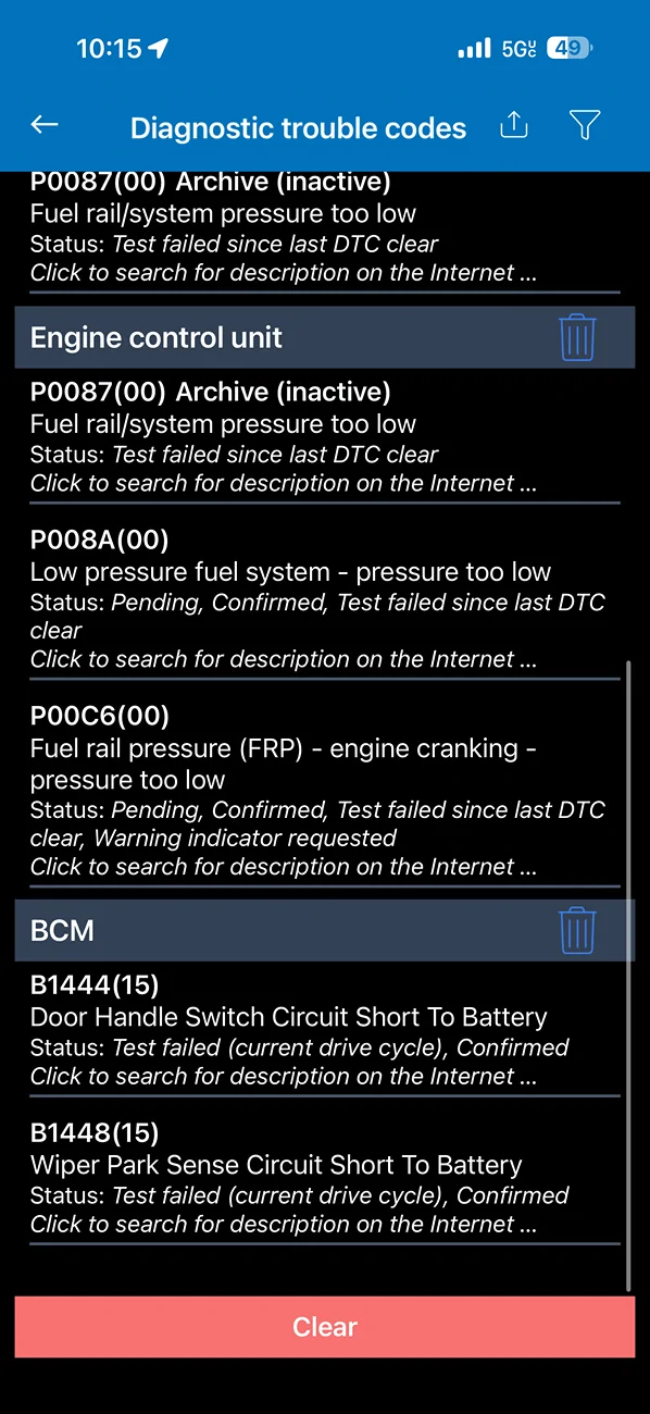

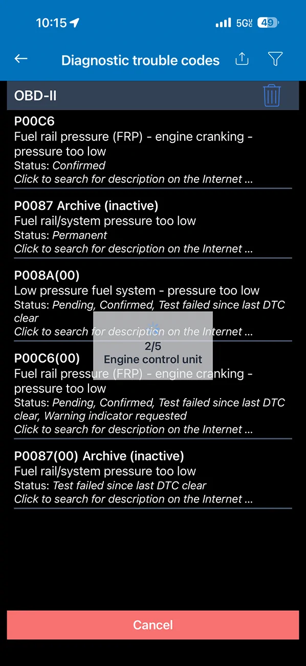

Hi friends was out driving with my teardrop trailer today. When out of nowhere after stopping, my truck started misfiring horribly. And shutting off and throwing codes. Eventually, the truck was not shifting properly and not maintaining power. Had to get it towed home….
A few few notes I’ve only had the truck for about a month. It has 140 K. So far the transmission has been great lol
I have noticed a lingering low fuel pressure code. And the fuel pressure it’s asking for is definitely lower than what it is getting. But I’ve noticed the duty cycle of the pump is normals
The unfortunate fact is, I just drove the car off the tow truck and it started up perfectly no issues and drove into the garage. 😭😭😭
Wondering if anyone else has run into this issue. I’m thinking it’s a fuel pump issue. This truck was used a lot in construction.
seems like the issues only happening when the truck is at operating temperature in the hot Vegas sun.. I put 87 in it BTW

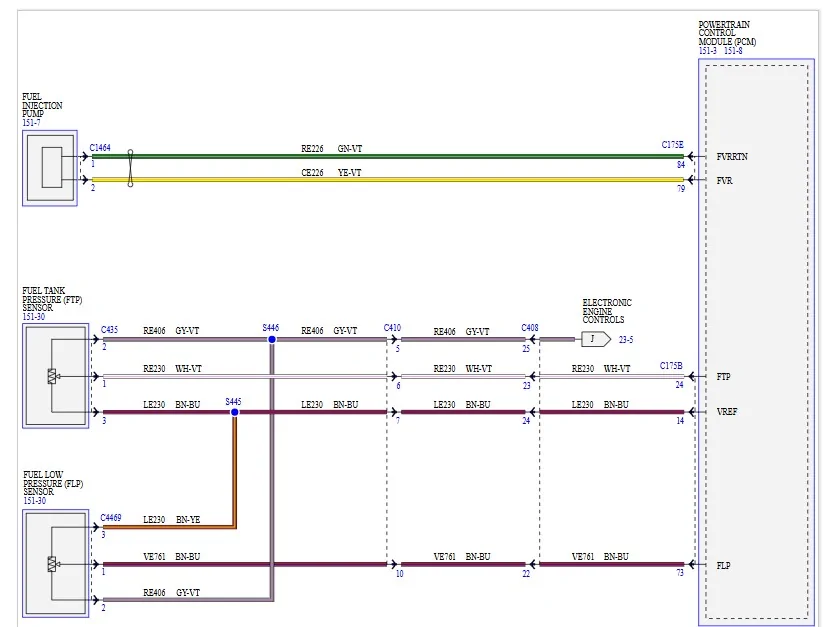

Before you condemn the LP Fuel Pump - Get an actual (Gauge) on the system to verify that the pressure reading is accurate.
Note: A Pressure difference of 15 PSI (is within acceptable limits) - Gauge to PID
The TAP in - = The HP Fuel Pump Feed (QD)
Ref: Normal Readings (Approximate) @ Hot Idle
LP Pump Press - Actual / Desired - 69 PSI
LP -Low Press Voltage (Sensor) - 2.80 volts
LP Pump - Duty Cycle - 25%
Fuel Pump Module - Duty Cycle - 40%
Fuel Rail Pressure Actual / Desired - 229 PSI - this will vary depending on load
The Fuel Low Press (Sensor) is what gives you the LP Fuel Pump (PID)

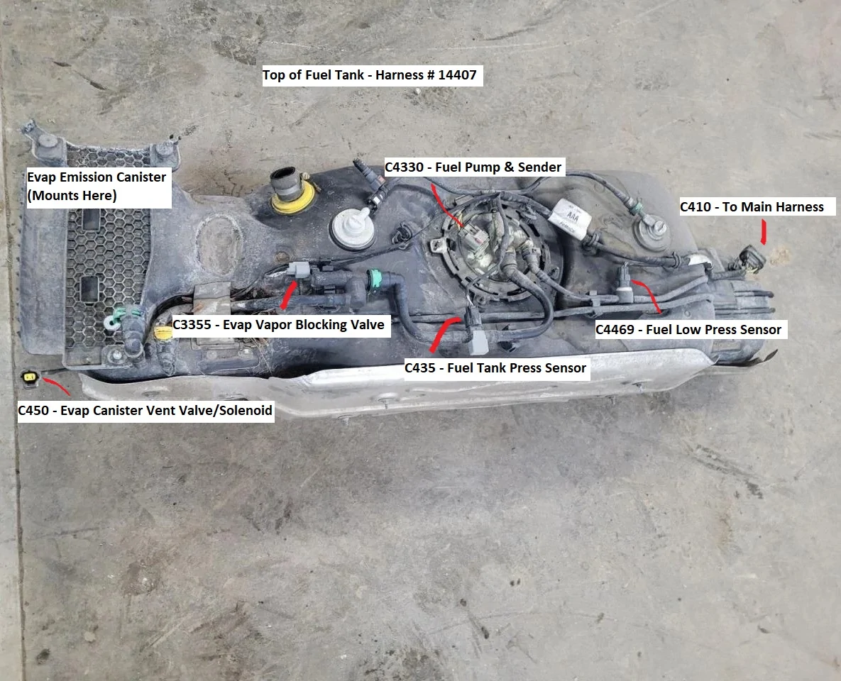

Being that you are stating its more noted (Heat Related) - (?) is it from pump heat or bad connection heat
I would pull (inspect & clean) the related connectors

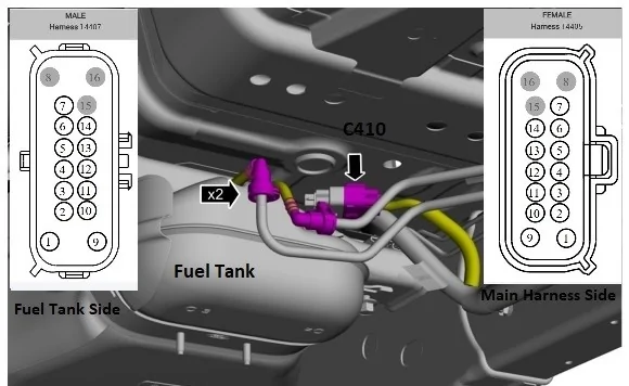

1. The Fuel Pump Module Connector - it's the module mounted just above the spare tire
2. C410 & C408
You do not have access to the top of the tank - so you cannot reach the Fuel Pump Connector or the Low-Pressure sensor connector
C410 and C408 are known to have corroded connections (moisture intrusion)
For Reference:
Top of tank ref
At 140K - it does appear to be the pump itself, but it may be a good idea to either verify with an actual gauge and or replace the (Low Press) sensor along with the pump - which I think comes with the tube - reason is to avoid pulling the tank again (if it's the sensor) - this is my reasoning for the gauge test - Verify the Press Reading is accurate

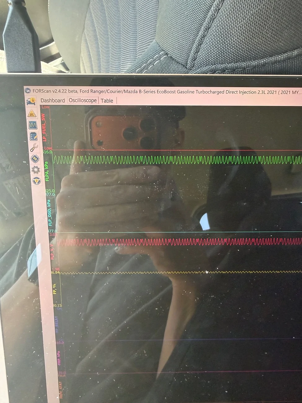

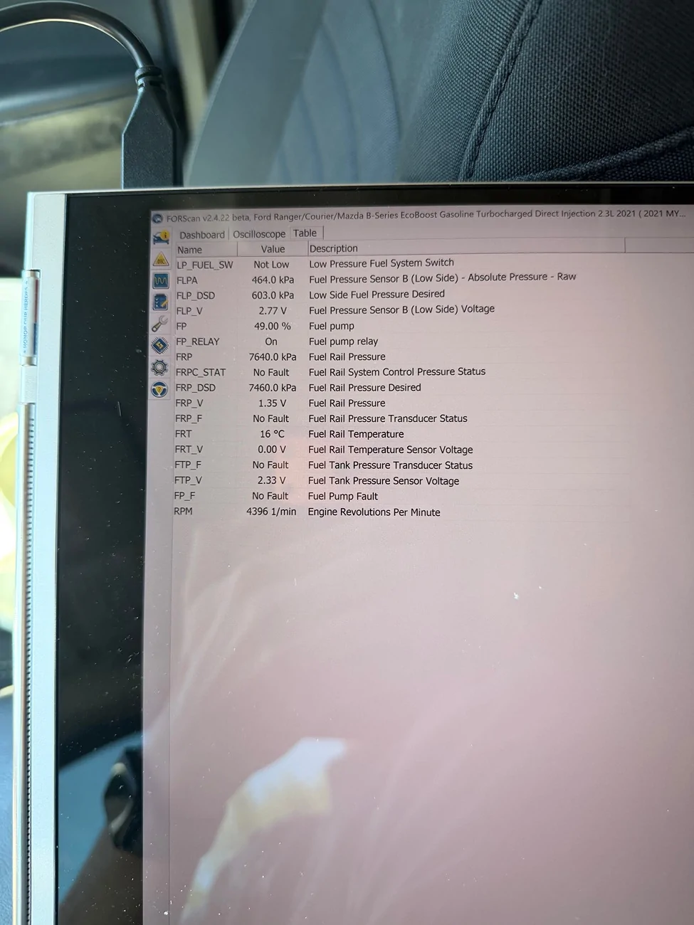

So just ran the truck up a long hill, few things that stood out after getting the truck up to temps the fuel pump is constantly oscillating in pressure… it’s not maintaining one constant pressure.
As well as after climbing this mountain pass and then letting it sit for a bit and revving it, the pressures are about 100 K PA below desired. On the low side….
But ofc no misfire or other codes now 😭
I’m heavily leaning towards the fuel pump being the issue. Just with that lingering code before I have these issues. Some lingering occasional misfire is at idle.

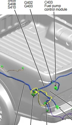

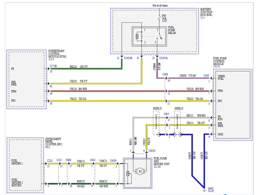

The Duty Cycle - is maxed out - in an attempt to reach desired
So that leaves - Weak Pump (most likely) or Dirty Ground (as a possible)

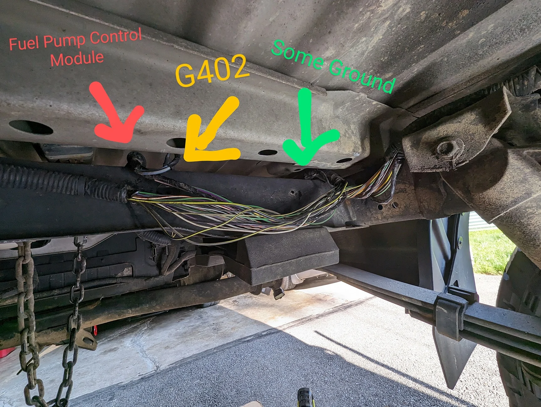

G403 - General Location
Note: These location diagrams (are) only general locations and are not always 100% (exact location)
Example: From another member - note that G403 may be the (Some Ground) listed here
A verification would be disconnected C410 and this ground and (meter it) for verification
So, while it appears to be the pump - since it's not a simple R&R, it may be a good idea to just verify you have a good ground circuit - before actually committing to replacement
So, this would be C410 and this ground point G403
and C410 - Closely Inspect Pin #2 for corrosion
Noting that - The Pump (Itself) - Routes to the (Pump Module) - then routes to ground and ties in the (Shielded Ground) for the harness - these are the only 2 things on G403
Granted - it does have high milage and the pump may be just weak and worn out as the most likely issue.
