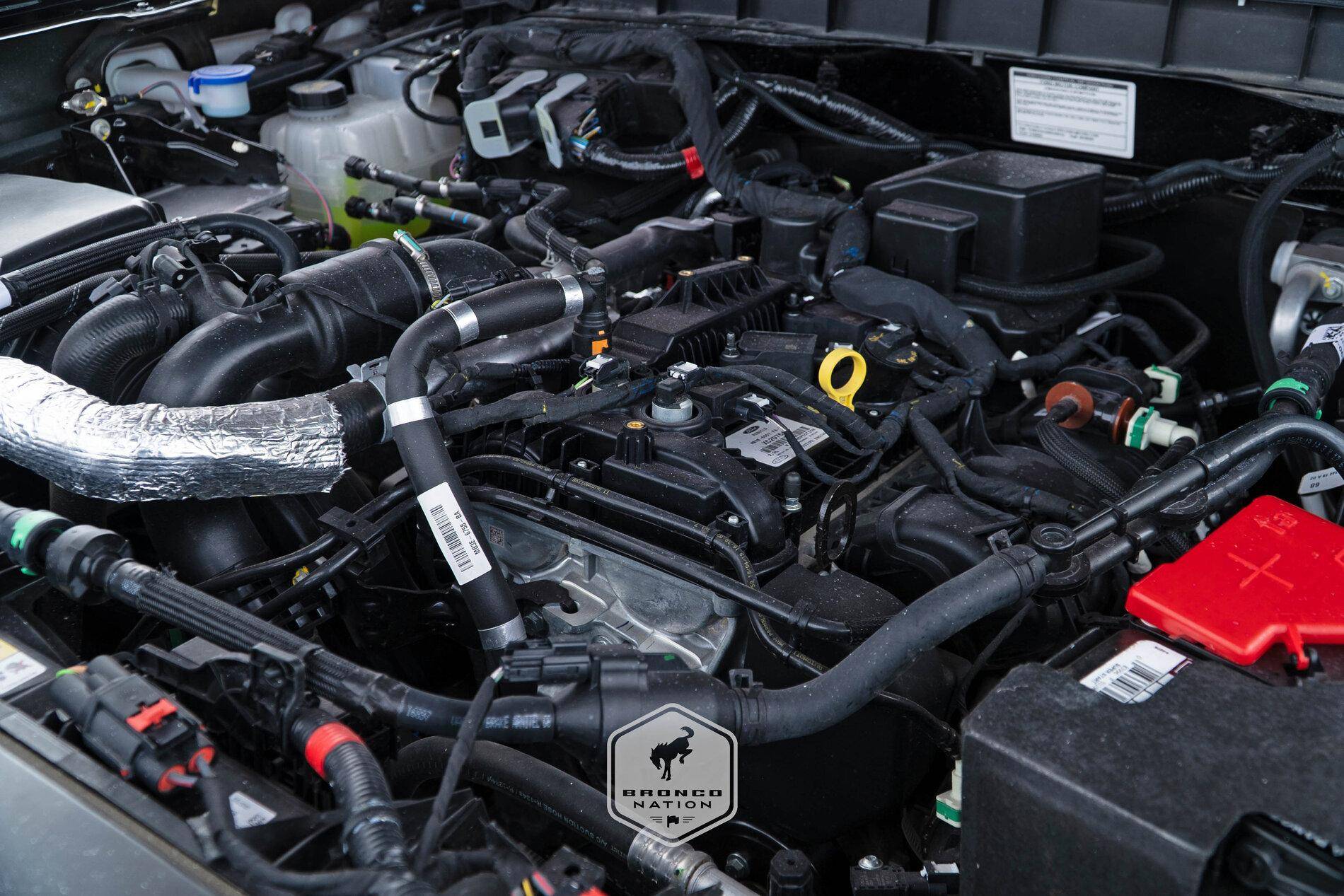

Below is a picture of a 2021 Ford Bronco with a 2.3L. Notice what is covering the fuel pump?

I don't consider the cover a deleted item. It's offered in a redesigned Ranger for 2024.
But it makes me think that the cover could have had an opportunity to be in the Ranger as far back as 2021.
Here's a thread that mentions it.
https://www.ranger5g.com/forum/threads/what-is-this-on-the-high-pressure-fuel-pump.12560/
Thanks for the info and pic. I guess I'll see what it does on the '22, probably the slit suggestion for the fuel line. Maybe this is a cheaper offering to the mice gods than the engine cover! =D

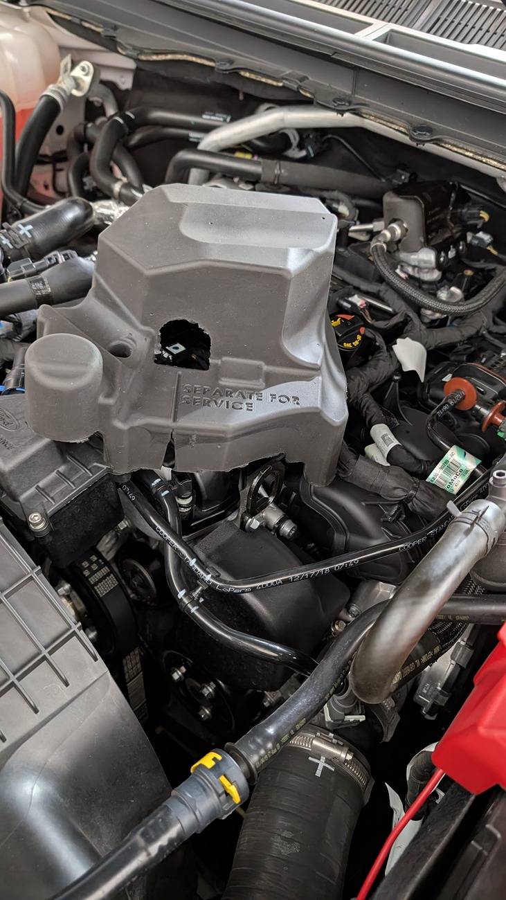

I have the cover. I'm trying to figure out how to install it.

W721333S450B Stud HT2
LB3Z9K540B Insulator
MB3Z6A957A Special stud
MB3Z6A957B Special stud
Just so you know, it doesn't use the same type of studs as the engine cover. It uses the type where you push down and it snaps in place.
The engine cover has one. I pointed where it snaps to on the engine. (See pics)
The last picture shows two places on the fuel pump cover where the special stud snaps to. I'm pointing to one.
If you cut it at separate for svc, you are taking away one of its functions - Cover the #4 COP.
You will need to disconnect the most fwd fuel line, it takes a disconnect tool and the pressure has to be relieved before that disconnect.
The only other way is to cut at the (Svc Line) to get under the fuel line. I do not plan on cutting it and will disconnect the fuel line.
The odd thing is: 2024 Svc Manual
1. HP Pump Replacement - Cut the Cover
2. #4 Coil - Disconnect the Fuel Line & Remove the Cover without cutting it.
Does that not make you go WTH? Who the Heck - Wrote These Directions? - Clearly 2 separate writers and proofreaders are in play.
