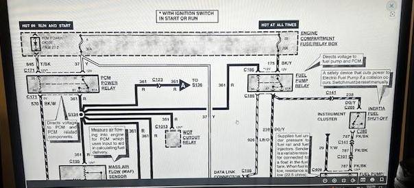

Two mechanics have gotten it to start by applying ground directly to the pump jumping/bypassing whatever electronics.
If this is true, then the problem is with the ground connection to the fuel pump motor. It would be easy to check with a volt/ohm meter.

I will say I am somewhat confused on this issue, but if they can get the pump to run by applying a ground (which ground) the Relay Ground? or Pump Ground?
Relay Ground - affects the Power Feed and is controlled by the PCM, so a power check at the Pump is it a constant (12 Volt) power, as a voltage drop, or fluctuating voltage will cause a low-pressure issue. (Pump not spinning fast enough)
The PCM also has to see (ignition - injectors) for that ground to get it to run.
Pump Ground - This will affect the pump motor as well and also cause a low-pressure if the pump is not spinning fast enough.
Fuel Pressure Regulator - I would have to dig in the manual to confirm, but this should be a mechanical (vacuum controlled) regulator. It controls the fuel pressure going to the Fuel Rail (Injectors)
A bad regulator would cause start / running issues, but it would not dump power at the pump.
A quick check (if vacuum) controlled is to pull the vacuum line and check it for fuel if fuel is in the line the diaphragm is blown in the regulator.
So, at this point just to see what the pressure is doing, is to check the fuel pressure at the rail and then compare that to the fuel pressure at the fuel filter connection
Basically this - The FPR lets the fuel pump build pressure from the volume output of the spinning pump, and it controls that pressure but does not affect the power / ground control for the pump.
This is one of the reasons I suggested, disconnecting the fuel line and have a bucket ready to catch the fuel. I wanted to see if the pump was actually not running.
Hopefully, they can pinpoint it down, but yes - I would shift focus to what is the pressure, possibly shot gun a regulator at it and then if still an issue, backtrack to (where are they applying the ground to get it to run) what circuit and then dig into a possible issue on either ground circuit.
From what I gather so far, and your latest post- I would say it's the Pump Ground not letting the pump to spin fast enough.
Which brings us back to the G103 - right next to the Starter Relay you replaced, which is where I strongly believe the ISSUE is as you were at this area and then the ISSUE started.
So, to eliminate factors here, I would shot gun a FPR and also cut the ground wire a few feet from the fuel pump connector and run a new ground to a good clean spot on the frame.
By-Passing the G103 at the fender or do a deeper dive into a wiring (resistance) check on that ground.
This way you are eliminating 2 sources of possible failure points and only have Fuel Filter Clogged, Fuel Line Issues as far as pressure.
and
The Fuel Pump Control - via the Relay side - Power Feed to the pump

When I swapped out the starter relay I remember there's two ground wires. I wonder if I may caused this issue myself by screwing up the ground. I don't understand what is meant by making a jumper to jumper the ground from the top of the fuel box. After installing the new pump my mechanic sort of ate his words and is bringing over a meter, a voltmeter I think. Thanks again for the help!!
Was the starter relay that you replaced located on the left fender apron? Were the two ground leads connected to one of the starter relay mounting screws? Are there two ground wires there now? The circuit diagram posted earlier shows the fuel pump ground connection on the top left fender apron center. I would double check your wiring done while replacing the starter relay.
