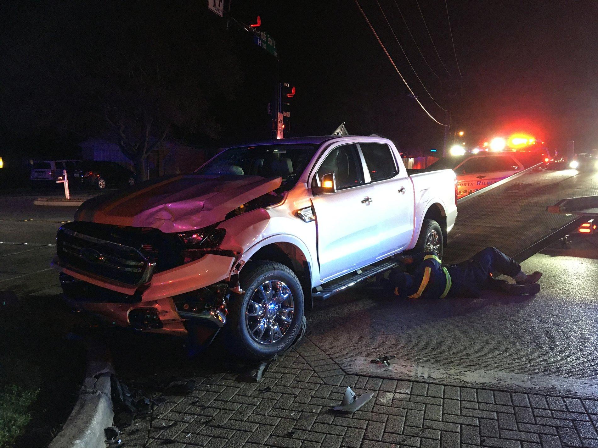

Well after 3 months I finally got my maps to update and then look what happened :-(
OUCH! What happened? That looks pretty bad - that is a lot of damage. Hopefully you (and anyone else that was in the truck at the time) are OK.
I'm sorry, Jerry. Let us know what happens with insurance.
