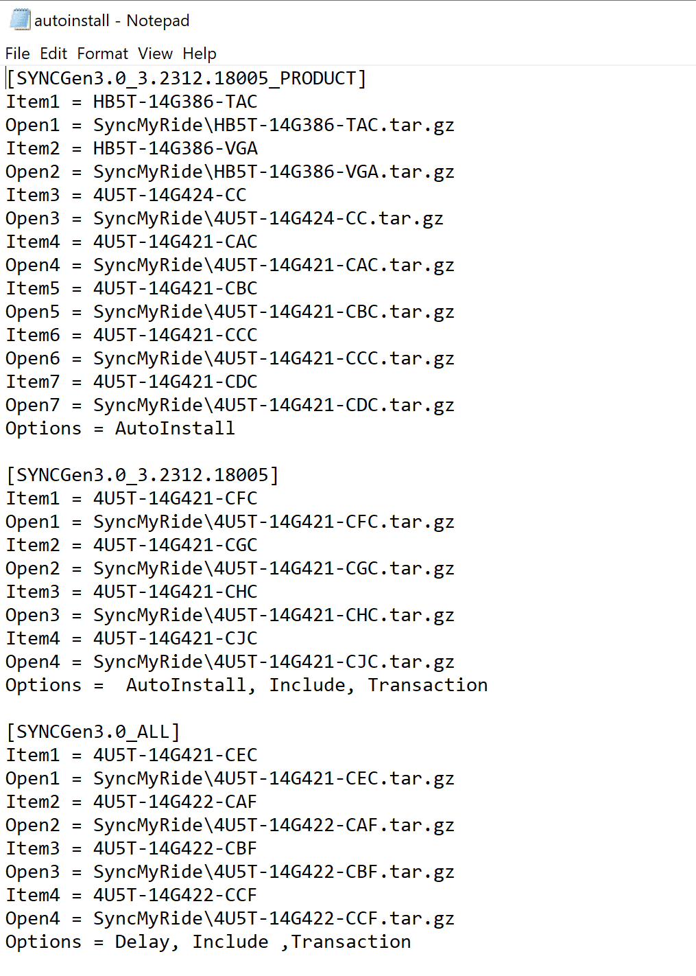

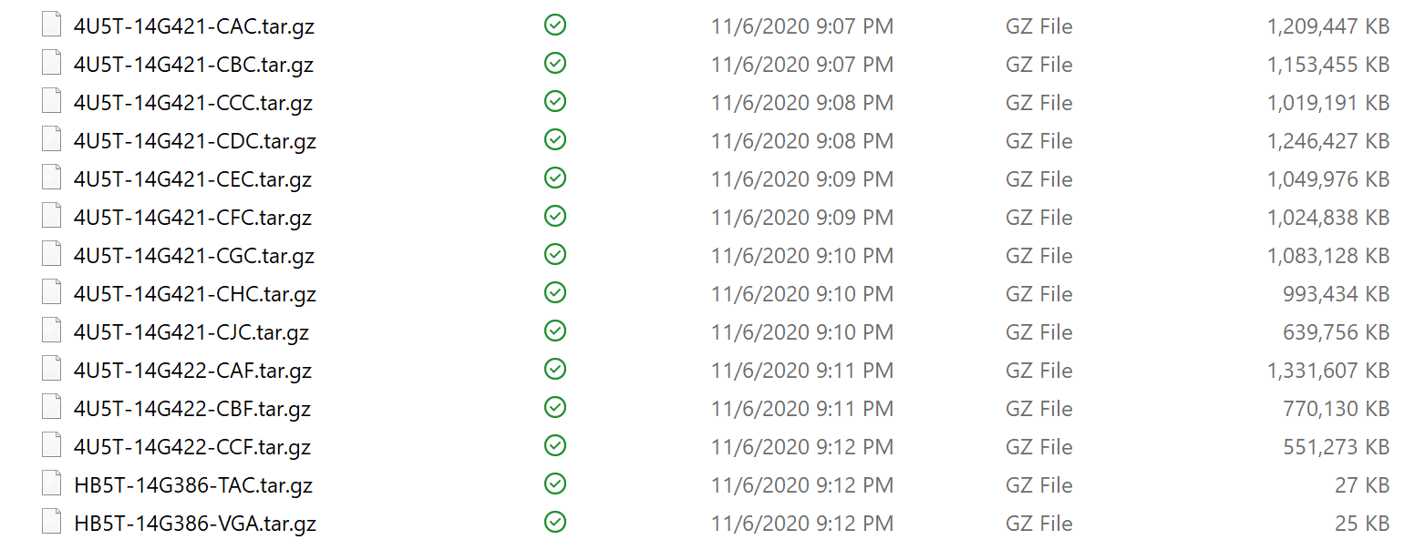

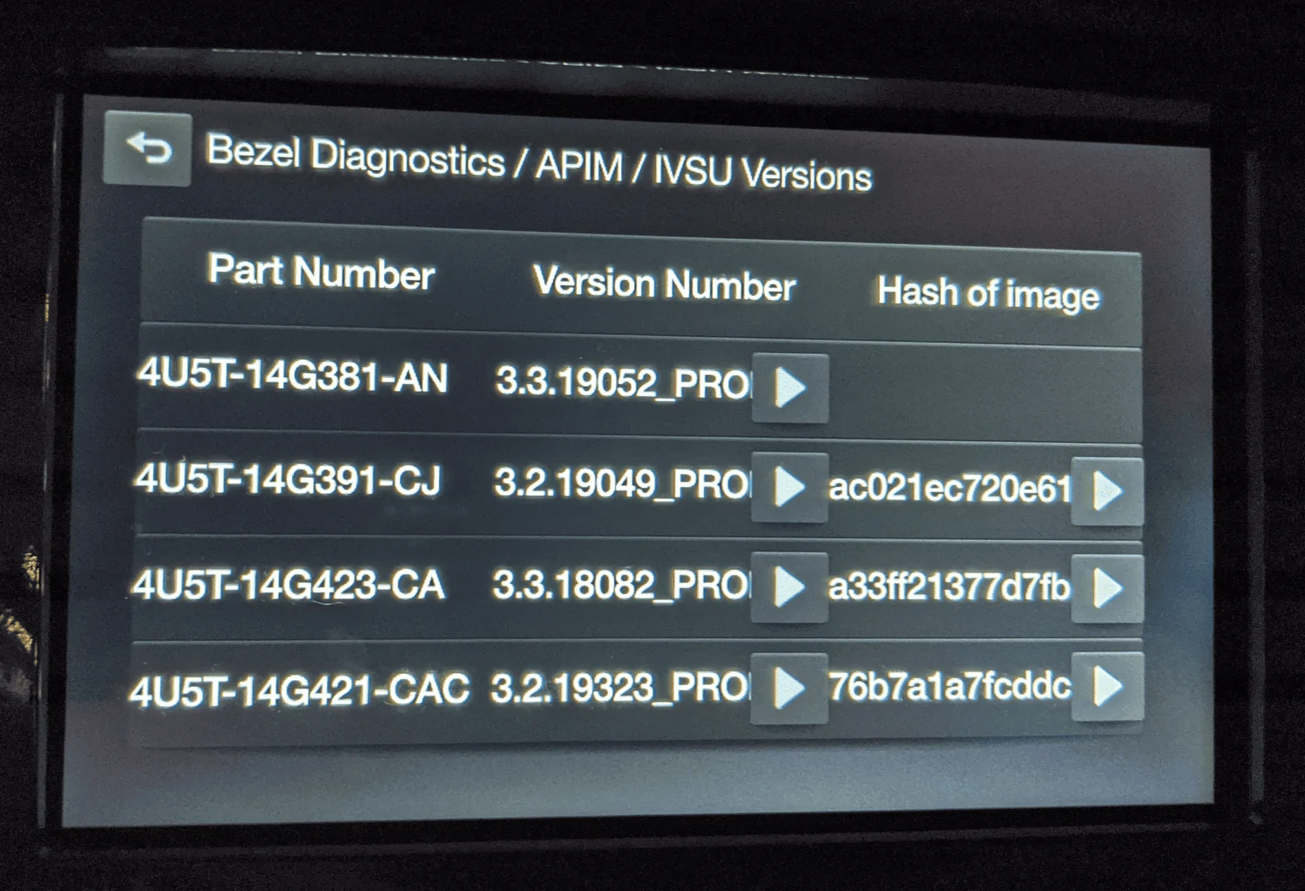

I've included screenshots of the contents of my SyncMyRide folder, my autoinstall.lst file, and a photo of the currently installed IVSU versions from diagnostic mode.
What strikes me as odd is that the total install time is about right, but the number of reboots is wrong. As far as I can tell, I've followed the Ford instructions to the letter. The only deviation from the instructions (that I just now realized) is that I did not set the volume label as 'SyncMyRide' when formatting the USB key.
Does anyone have any advice or input on getting this install to execute properly?
