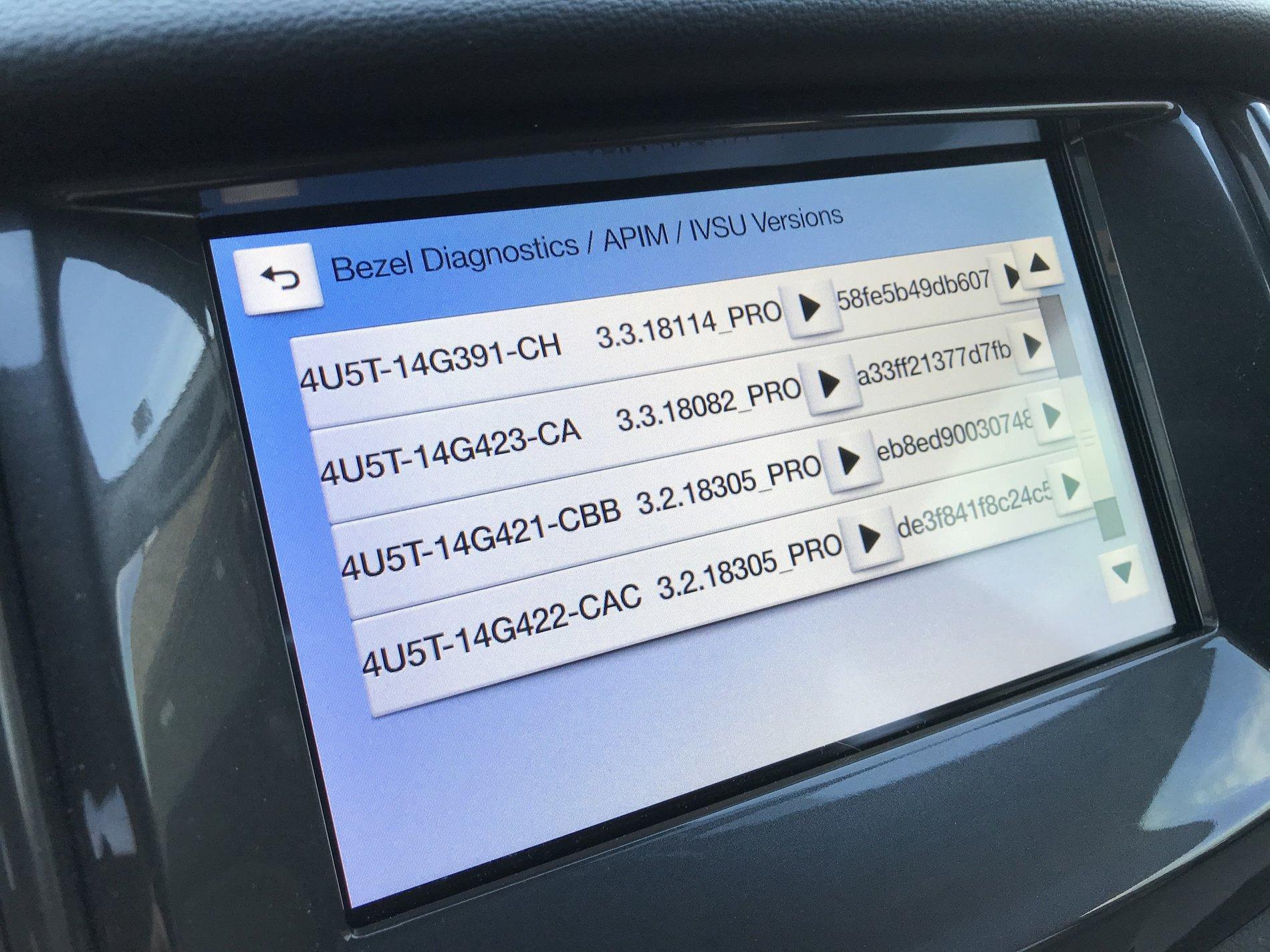

Check if anything shows up in the IVSU Versions menu. You'll look for the 14G421 and 14G422 items. Did you power cycle after running the map delete utility? I've personally never used that one, so it's not clear to me if it needs that reset first or not.

So, push and hold both seek forward buttons (steering wheel + IP panel) for ~10 seconds. End the speaker walk around. Select the APIM item, then IVSU Versions. It'll show you a list of what all is installed on the unit.

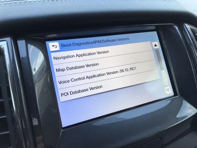

Forgive me for my acronym ignorance, but what is IP panel? I push both up buttons on the steering wheel but get no response. What am I missing? Never mind, just found it.

Looks like it's all there. One thing you can try is running a master reset in case it had some problem mounting the new images. You also see the 4U5T-14G424-CB listed as well, correct?

Not seeing the 4U5T-14G424-CB when it would let me scroll down. Doesn’t let me do that now.
