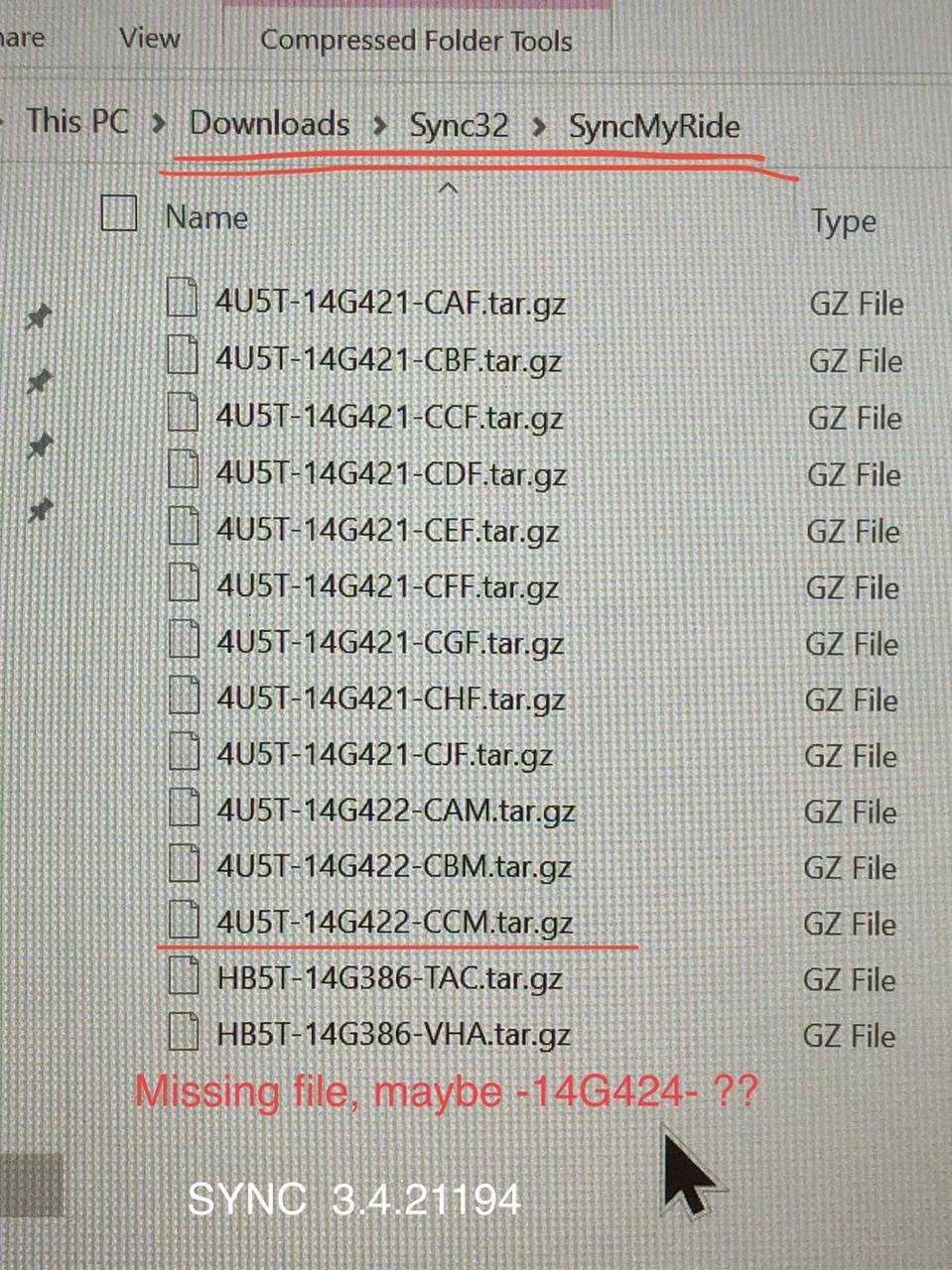

Did you get the 12GB Sync32.zip file downloaded (along with the License file) & then unzip it to see folder “SyncMyRide” and two files: auto install.lst & DONTINDX.MSA ?
Then following instructions we are to copy that folder + 2 files AND the license file onto a correctly formatted USB stick.
Did you get that far??
Then…
Install in truck.
I have a fast/solid internet connection & it took 3HRS to download the 12GB MAP file. The Ford servers are SLOW 😡
Then 30min for the unzipped files to transfer to the USB stick.
During the past 1.5 days I tried to download that MAP file 9 times ….NINE!
7 of those times the download failed after 2+ hours …very frustrating.
The two times I got the 12GB map file to fully download, unzip & copy onto a correctly formatted stick AND THEN attempt truck install >>> the same ERROR code appeared: LST_ERR05 …which means “the license file is not on the usb stick.”
Wrong Ford… my correct license file was correctly copied on the stick.
I called Ford Cust Support 800# and got transferred to IVT (In Vechicle Tech) support. They confirmed I did everything right, apologized for the slow download time saying their servers were getting slammed. Then the tech had me read the file names within the unzipped SyncMyRide folder (see pic.) Tech said that cuz my SYNC version is 3.4.xxxxx, there should be another file within there with a middle number group -14G424-
With that file missing the truck does not see the license file on the stick.
Solution? Can they just email me that missing file?? Nope.
Start over & try again. Arrrggh…..
So another 3hr download, unzip, copy files, and back to truck for the SAME result 😡
Called Ford again. They have now “escalated it to IVT Research.” I said great, in the meantime will you send me the pre-loaded $40 USB stick free? “Sorry Sir, I’m unable to do that; wait for the IVT Research team to contact you.”
There ya go, that’s my experience thus far trying to get an updated MAP file into my 2023 XLT.

I believe the ‘14G424’ is the license file. Are you sure you added the license file to the ‘SyncMyRide‘ folder on the USB?
You can also look in the ‘autoinstall.lst’ file to see all of the files it is looking for and the file names should match.
GManRanger
Greg
Sep 16, 2022
23 Ranger XLT FX4 18" AT
Pilot
Yep 100% sure I added the downloaded license file to the stick exactly as the instructions outlined. The missing 14G424 file is what triggers SYNC to recognize the separate license file that we have to download & copy to the usb stick.
OK, but I have saved every map update for my Ranger and my Fusion and the only file that has 14G424 in the name for any of them is the actual license file. The only one I do not have is this year’s Ranger update since I have to pay and I’m not sure it is worth it right now. I do find it hard to believe that they would have changed the file name structure this time around.
If you have the actual license file on the USB, but in the root folder and not the SyncMyRide folder, you get the error that you are reporting.
Do you have screenshots of the USB file structure (both the root folder and the SyncMyRide folder)? And, what is the name of your license file?
GManRanger
Greg
Sep 16, 2022
Pilot
YOU, friend to idiot me & all others reading this just solved my entire issue & likely helped others… I had the license file in the usb root rather than the SyncMyRide folder.
I'm a total dweeb…. Sorry everyone & big THX to alcohenusa 👍🏼
