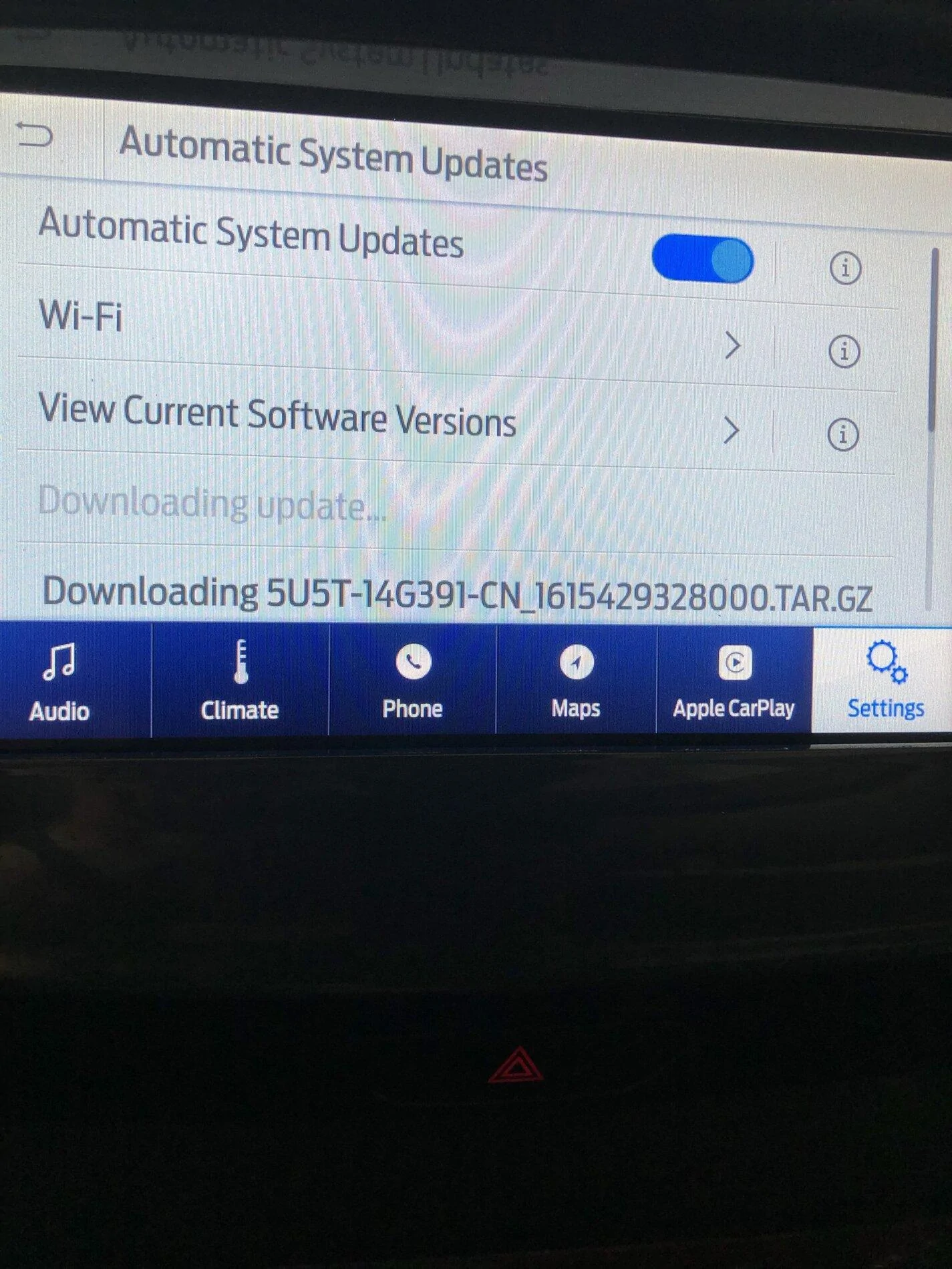

I just did this yesterday, via OTA update. I had no problem connecting to my mesh network. The whole process was painless, except I had to go out every hour or so to restart the update, since I didn't leave it in ACCY mode for that long.

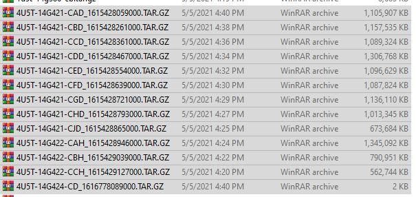

Has anyone downloaded the complete Navigation NA 2 20 update - no files left for download. If so, could you please post a photo of the IVSU files?

All I know is I downloaded the update from Ford site, installed it via USB. Then over the next few days did updates via OTA WiFi at home. I have a battery charger/maintainer installed so on the first day left the key cycle ON and went through the installs cycling key off/on for several days. I thought it was finished. Third day checked again and noticed it was still updating and installing. Two more key cycles. It was a long process!!

took a look at the sync today and have no idea what's going on...not using a usb stick prob coming over wifi.

Updated to 3.4 Build 21020. Since then, I connected to WIFI and been updating the map. So far I am on the forth file download. After the forth file the Nav updated to NA 220. Thought maybe I was done then the forth one popped up. Here are the files so far:
4U5T-14G421-CED_1615428554000.TAR.GZ
4U5T-14G421-CDD_1515428467000.TAR.GZ
4U5T-14G422-CAH_1615428946000.TAR.GZ
4U5T-14G421-CAD_1615428059000.TAR.GZ
4U5T-14G421-CHD_1615428793000.TAR.GZ
I think I read there are 9 of them.
