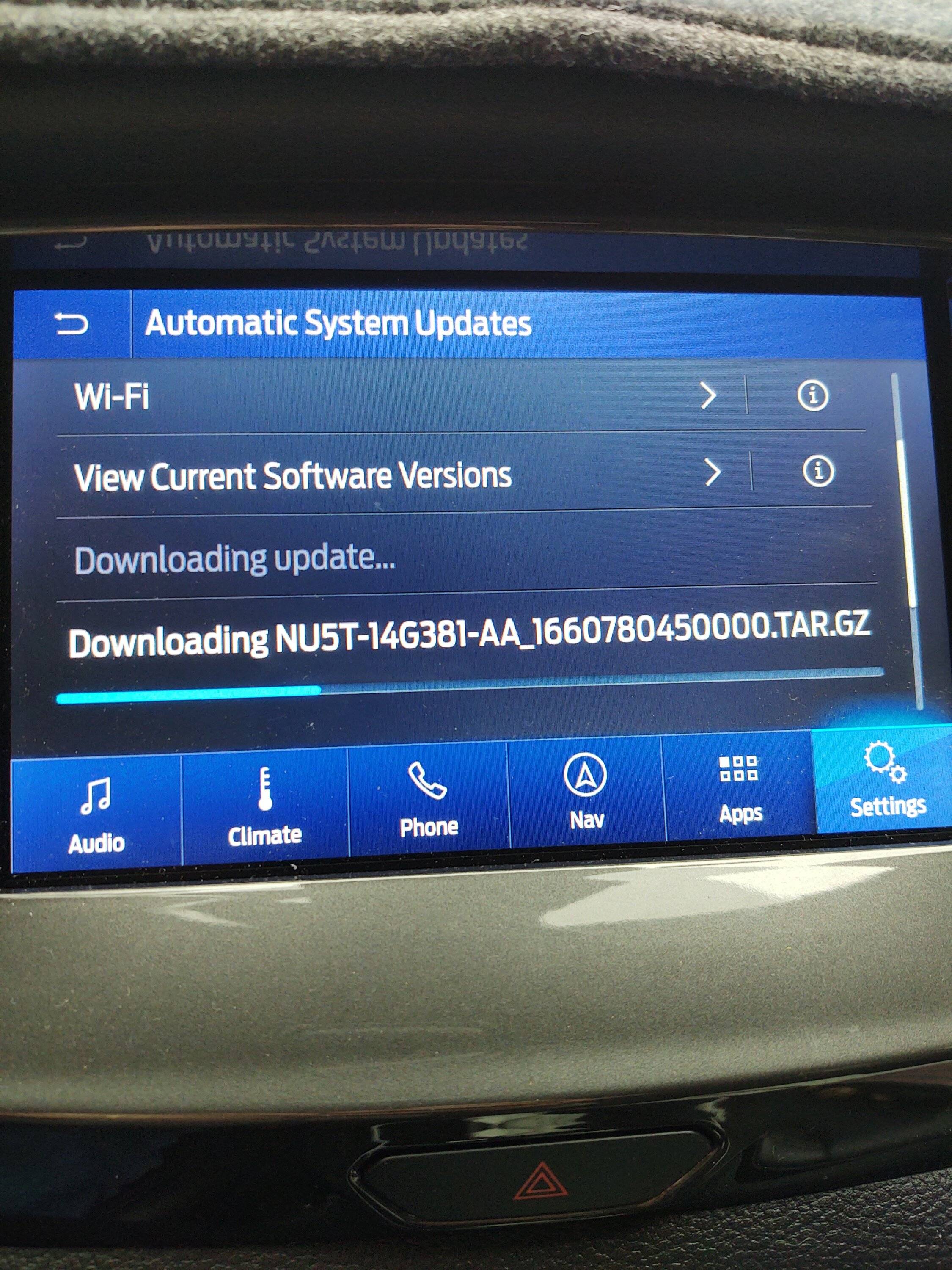

Mine did some update (tar.gz) today and although I cycled the ignition a few times my external touch locks (front and back - mines a 2019) don't respond. Just the driver's door and I have the 'unlock all' setting on which works I've lost the ability to unlock the back doors via touch.
EDIT TO ADD: with my ACC not working more than it works and my truck hitting it's third birthday I wonder if the battery is going. Not sure why it would have an effect but seems to be a common post.
