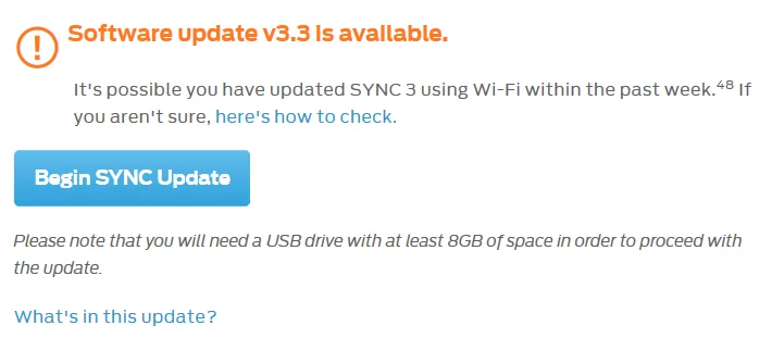

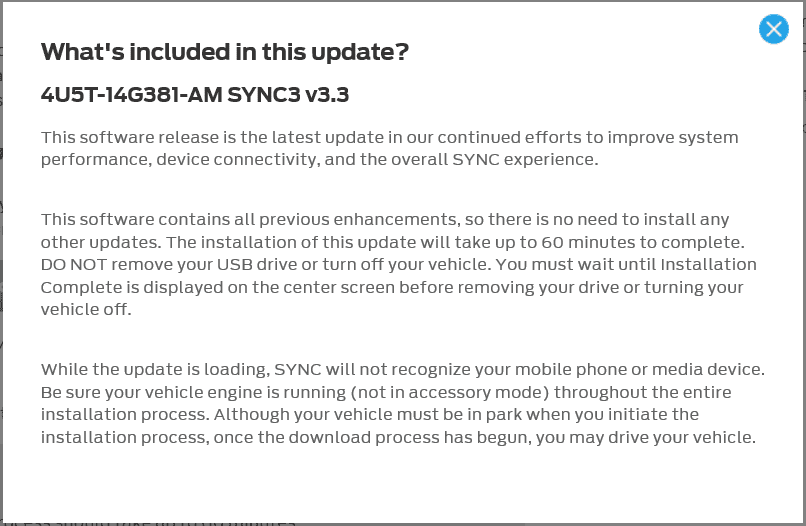

Here's what I see on my Ford Owners account. I'll be doing the update.
Keep Your SYNC Software Up To Date
Find or add a vehicle
We're committed to enhancing and improving upon the SYNC® driving experience. And to make it even better, we will periodically release software updates so you have the latest version of SYNC to keep you up-to-date and in-the-know.
Software update v3.3 is available.
It's possible you have updated SYNC 3 using Wi-Fi within the past week.48 If you aren't sure, here's how to check.
Begin SYNC Update
Please note that you will need a USB drive with at least 8GB of space in order to proceed with the update.
What's in this update?
Before you start:
  • This update process should take up to 60 minutes
  • You will need access to your computer or phone, and your vehicle, for this update
  • You will need to be parked in an open area
  • Mac users: You will need the Stuffit Expander application on your computer in order to extract the update
  • You wil need a USB storage drive that:
The last confirmed install of an update to your vehicle was on:
January 09, 2019
Full
