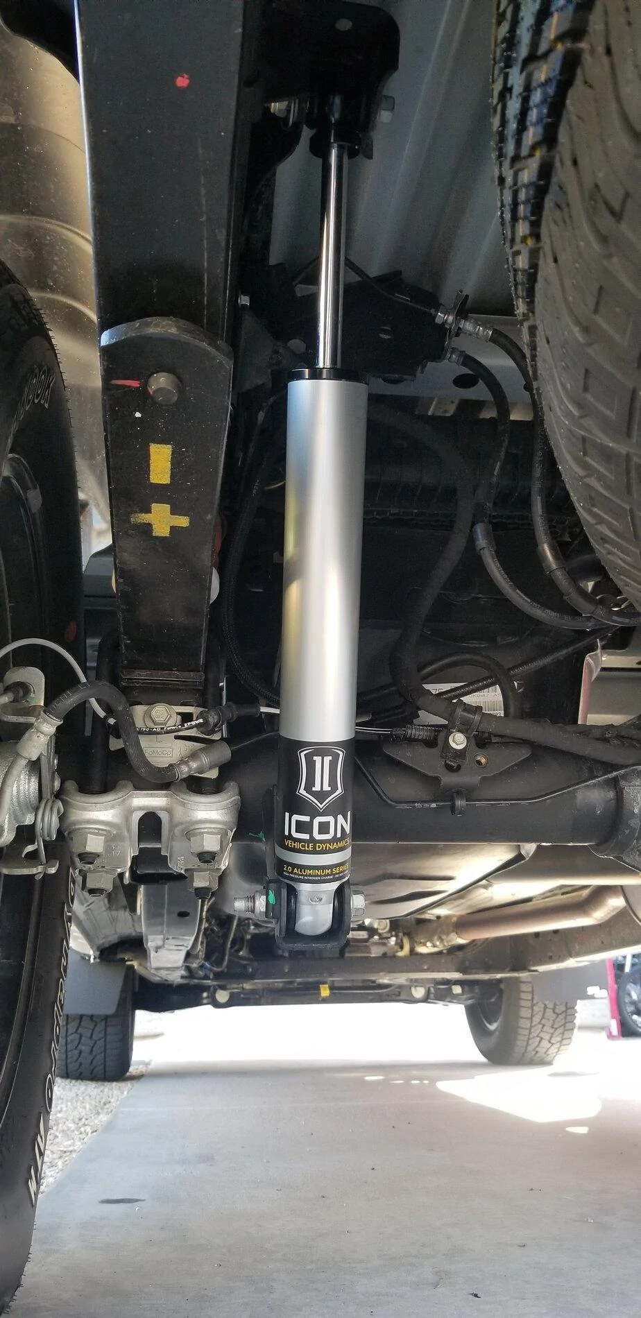

I have a tailgate damper and I was able to install rear Icon 2.0 shocks by hand with the truck on the ground (no lift/support). I just lay on my back and grabbed it by the sides of the tube and pressed it up so I didn't risk catching my fingers by doing it from the very bottom.
