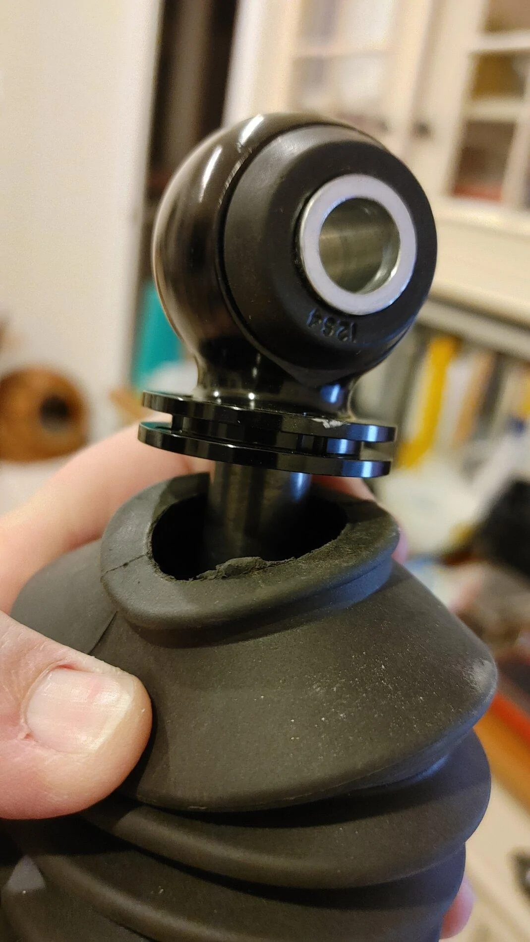

success! I got this big ass clamp and some hefty zip ties and got them all compressed. didnt even jack it up, popped them in. hardest part was getting the rubber boot back over the lip on the passenger side.

Certainly feels satisfying to get them in there after yesterdays struggles. I did not come up with the zip tie method.. found it from an old timer on youtube :)

Glad it all worked out Calvin ! When I had done mine a long time ago I was questioned about rear ride height as I measured before and after shock install and it raised it 1/4 inch. Poster didnt believe me. If your 200 plus pounds and cant get them to compress then its not so far fetched that it would provide a small amount of lift. Good luck you will enjoy them. Bret
