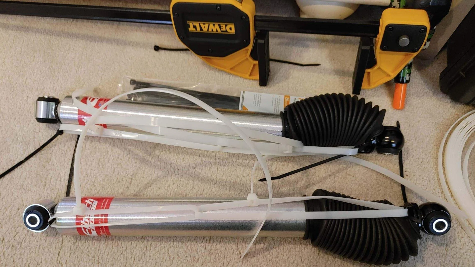

I had the same issue with my Eibachs.. i went to home depot got a big ass bar/squeeze clamp and some heavy duty zip ties. got it all compressed and zip tied and it went in easy. i beat my self up for about 4hours trying to get it in. I returned the clamp when i was done with it.. it was about $40.
