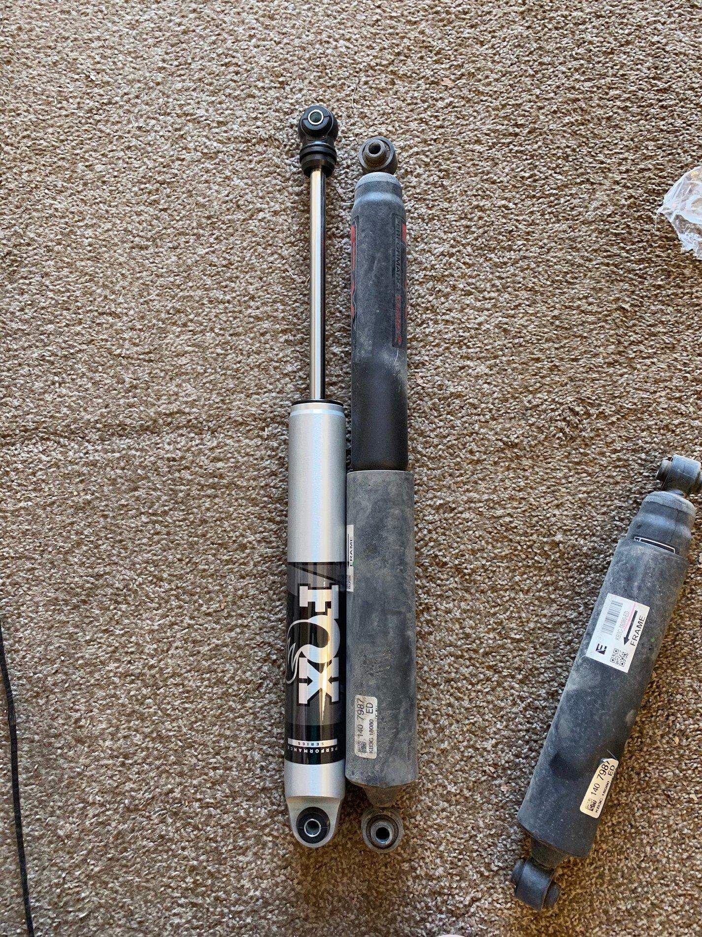

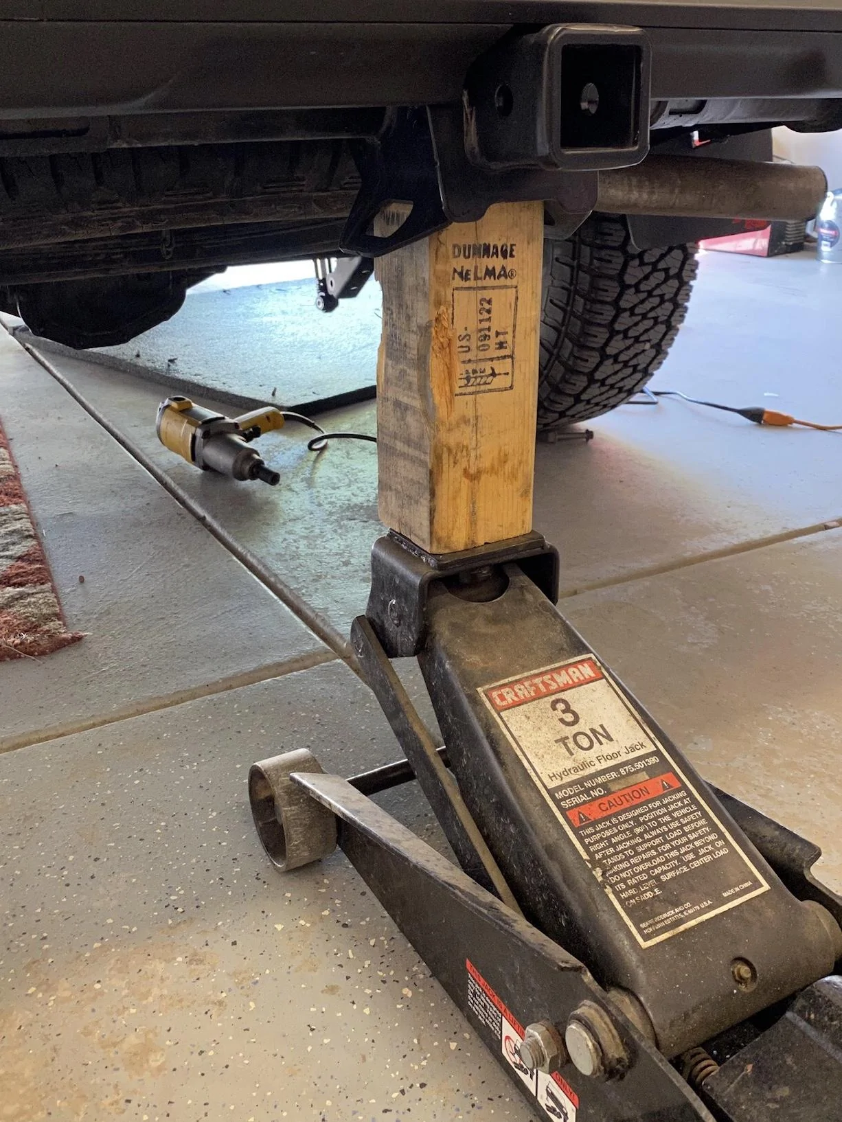

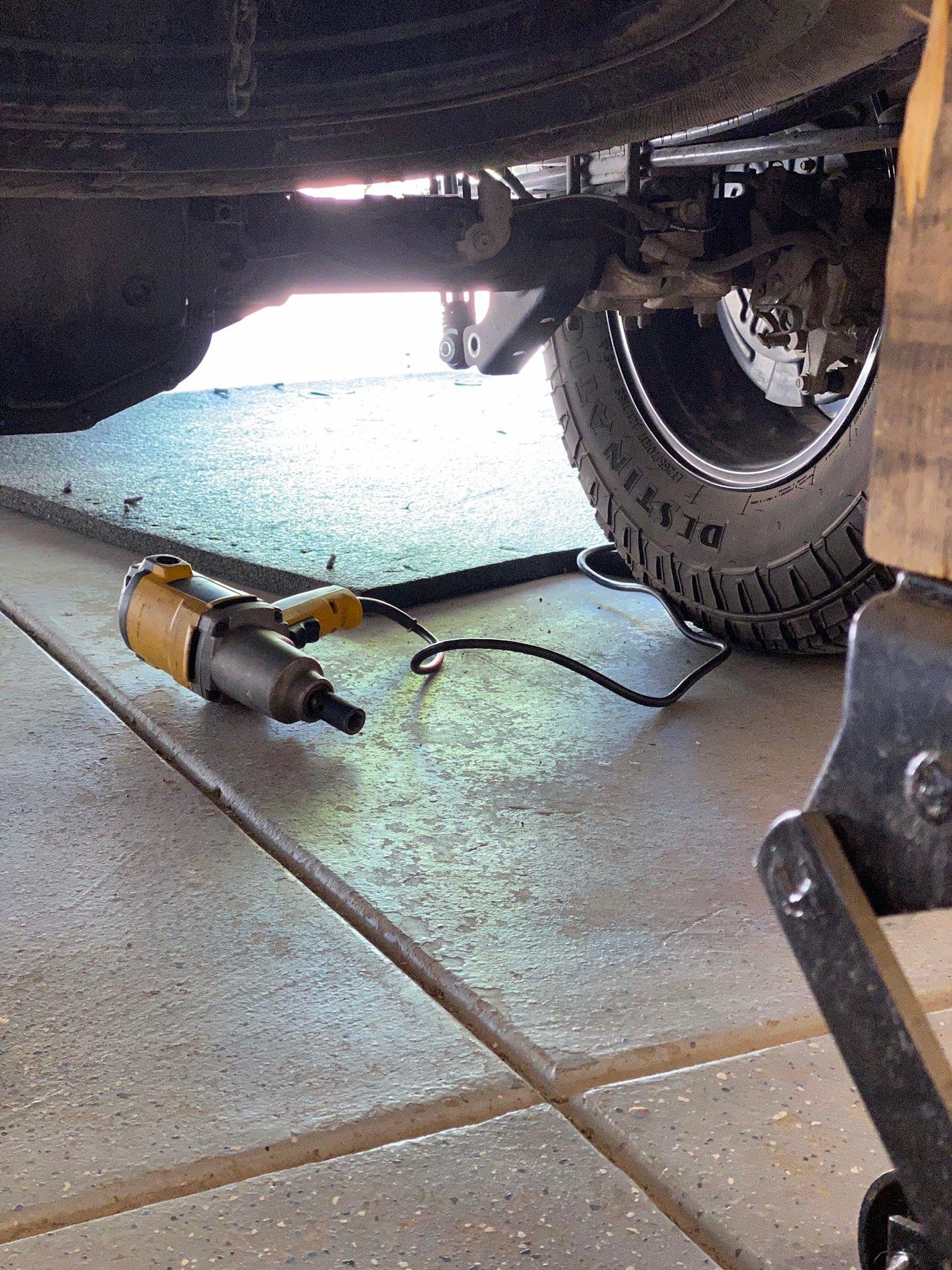

Decided to give these a try. Truck rides pretty good but a bit too much movement on the highway with the FX4. Quick install, about 10 minutes.
A little hint, leave the plastic straps on the shocks, install the upper bolt and raise the body until you can get the bottom bolts in. Then cut the strap and torque them down. done, no forcing the shocks up while trying to slam the bolt in. Easy peasy

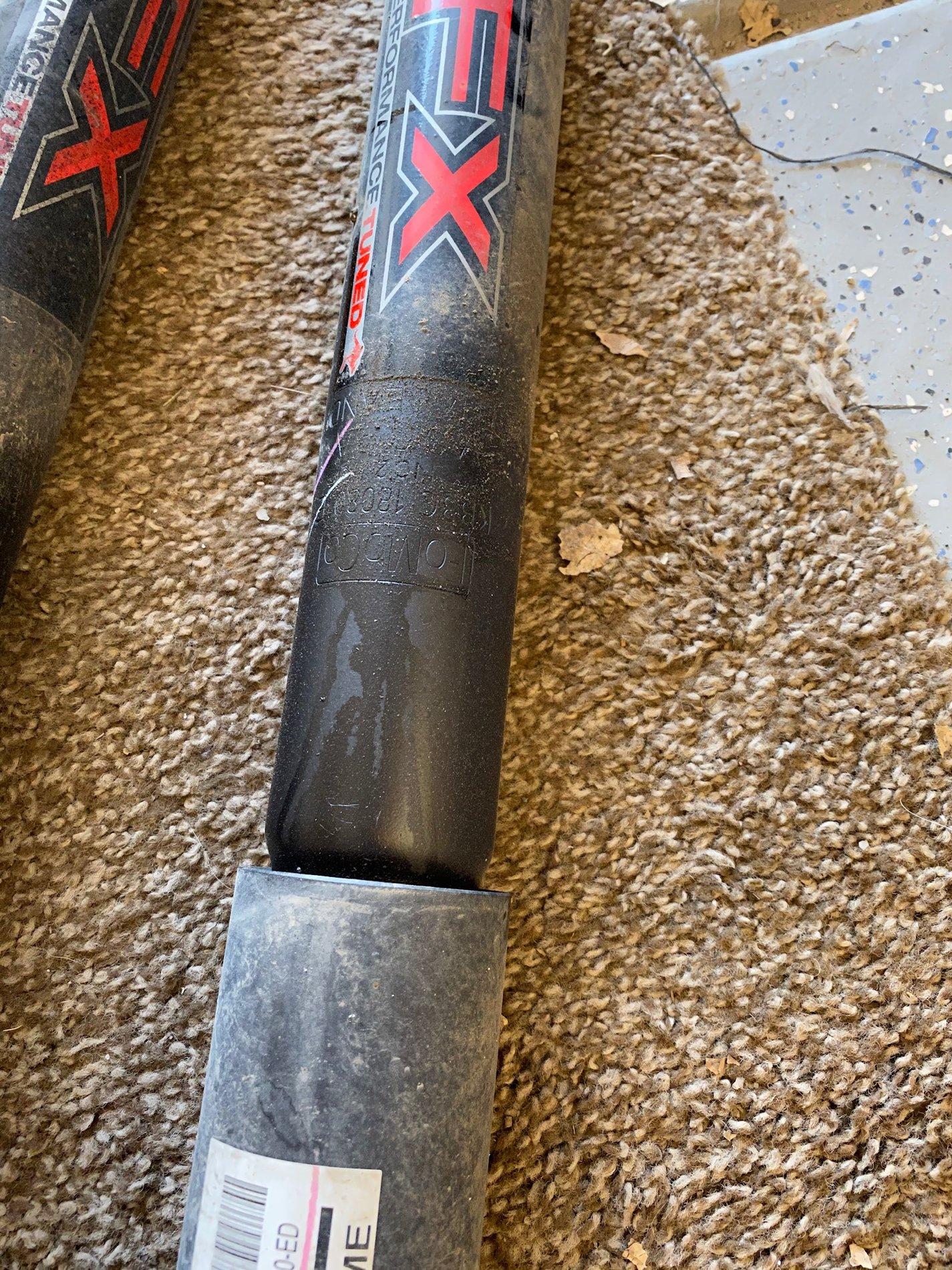

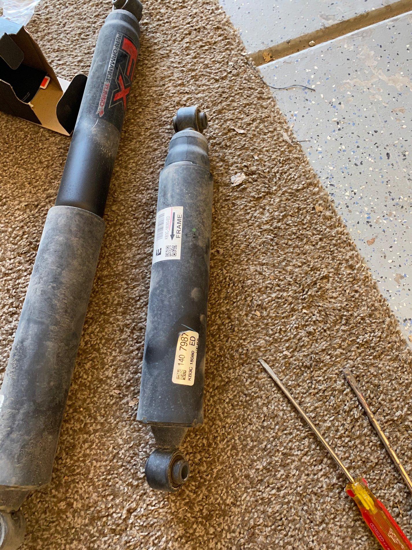

One of my shocks was already gone after 4500 miles. Sad. Here are some pics. Pretty large improvement other than wanting to do the fronts now. Lol
I took the strap off to show the difference in length. I reinstalled it to install in truck.

I am surprised the rear shocks are bad already. About how many miles are on the truck?

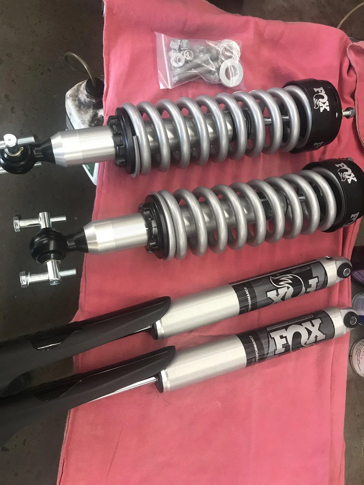

Damn, that sucks. So with you putting the fox rear shocks on are you considering the fronts as well?
I ordered Icon upper control arms and the front Fox’s. I’ll install them maybe next weekend or the following. I figured I might as well just complete the upgrade.
I think they are bad from the factory. My FX shocks had 13k on them and I could compress/extend them pretty easily with just my arms and I'm not a gym rat. I considered selling the FX shocks but I felt that would be morally repugnant as it would probably endanger the buyer so I tossed them in the garbage can.
