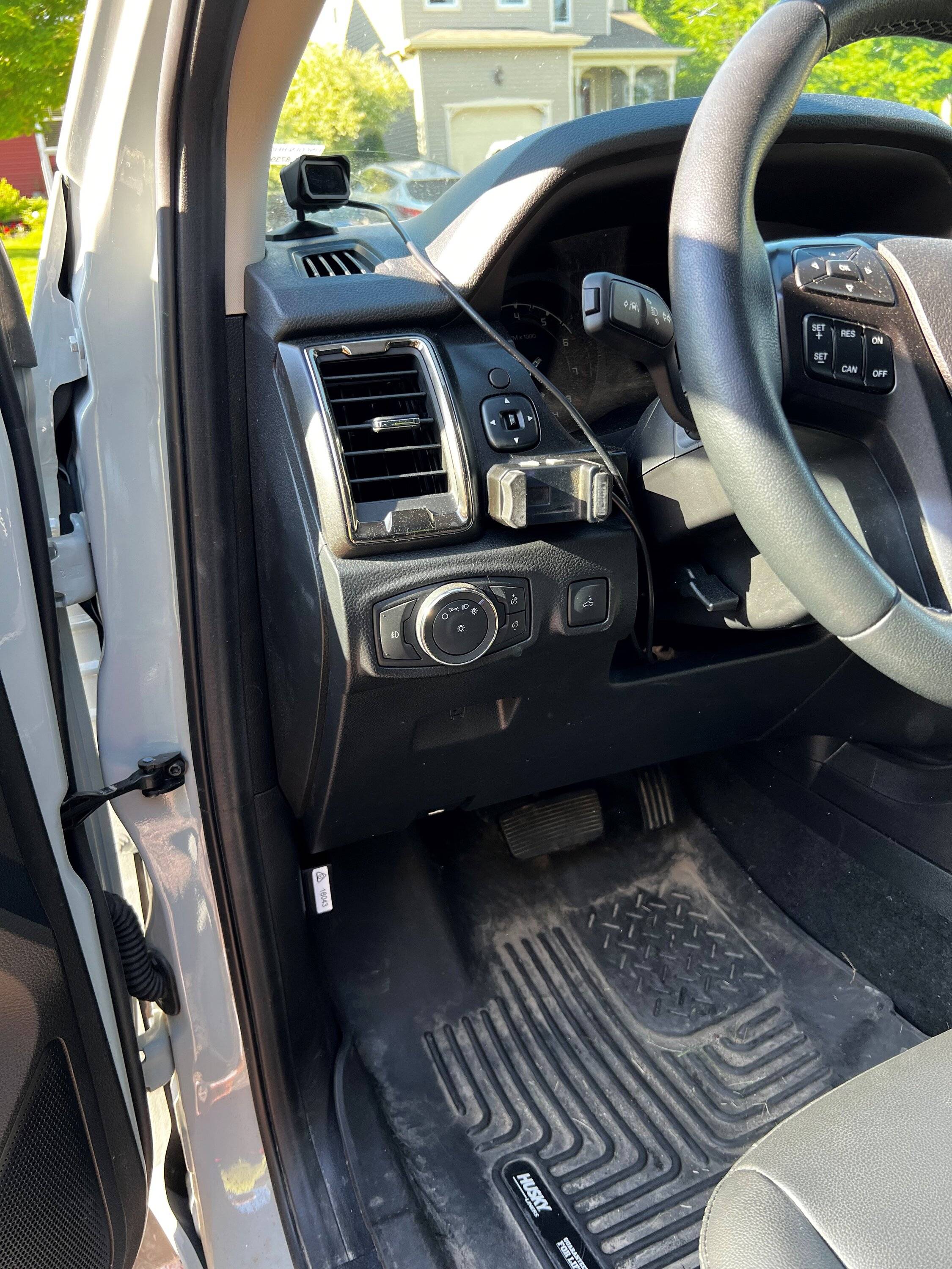

Installed an Hopkins Insight brake controller. This controller has followed me trough 3 vehicles and has never let me down.
Took me about an hour working in that small area :crazy: Connected it to the trailer and everything appears to be working.
