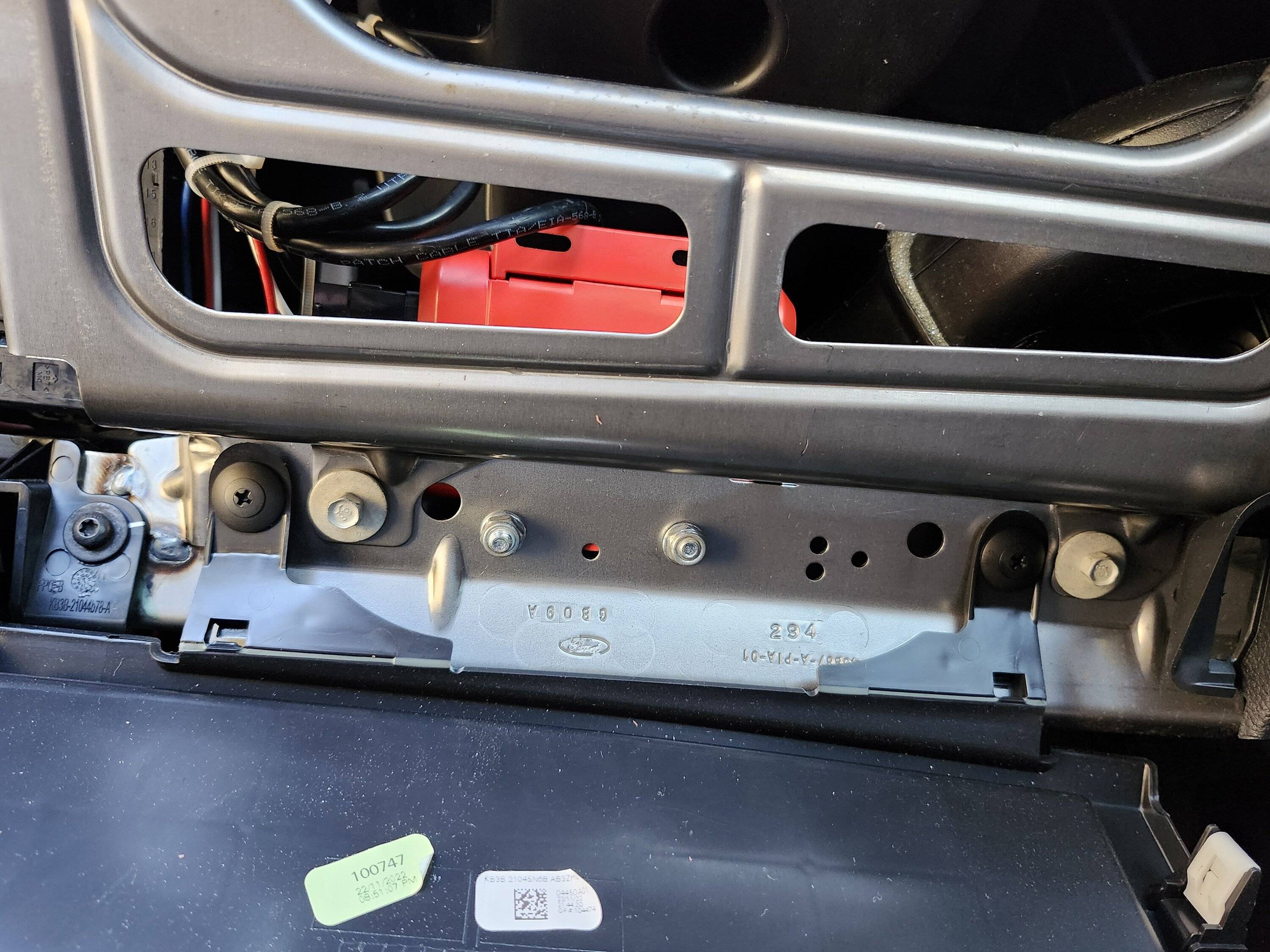

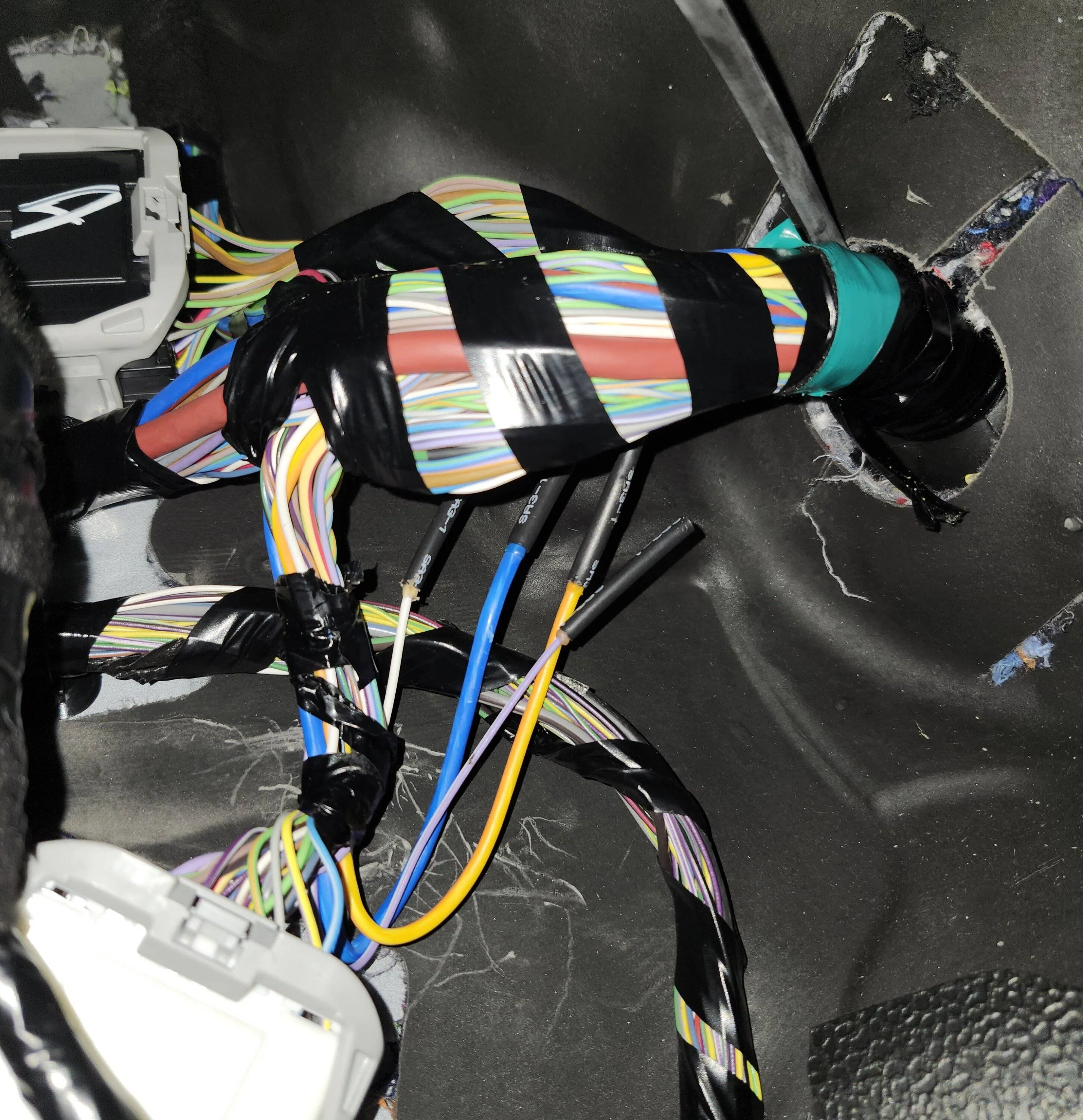

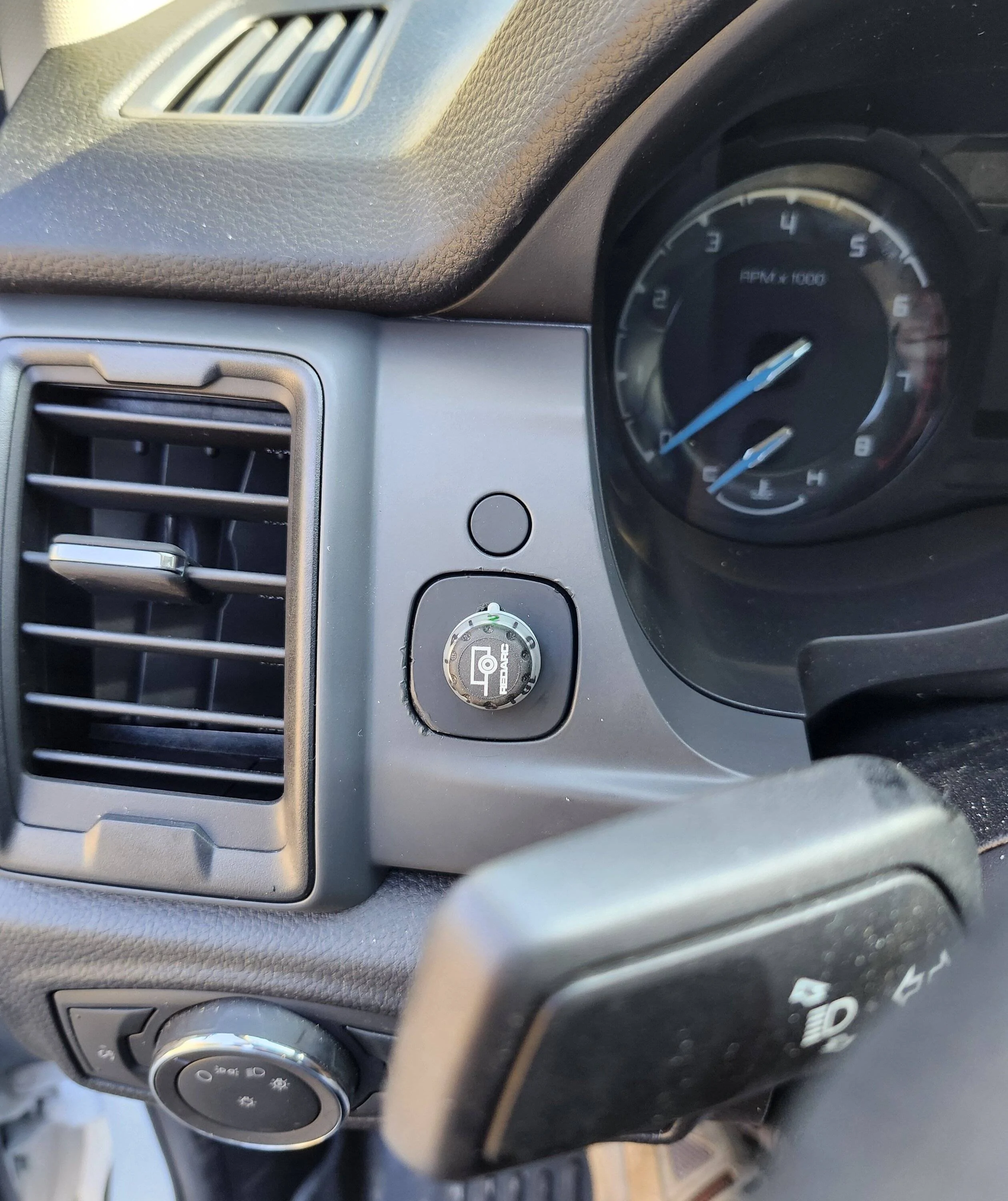

I mounted the controller on the stamped sheet metal plate behind the bottom fold down cover and used the posi-tap connectors to hook up the 4 wires. Call me crazy but I mounted the manual override in the blank switch plate to the left of the console kind of behind the left turn signal stalk. Its a proportional controller (and is the same one used in the much more expensive Ford factory brake controller kit). My enclosed trailer is 2000 lbs and the my drag ghia is about 1400 lbs so I'm only using 45% of the 7500 lb tow capacity. Having an automatic proportional controller I don't intend to be using the manual override ever but who knows, that may change.
EVERYTHING takes me longer than I think it will, I left the shrink tubing on the 4 wires I dug out of the factory harness that were wrapped in blue to use the posi tap connectors which made it a little harder to get the connectors installed (since I had less wire to work with). Mounting the brake controller on the 2 existing holes required minor mods to open the holes up on the brake controller and the same on one of the holes on the sheet metal panel. Lastly the blank switch panel to the left of the instrument console I thought would pop/pry out so after some minor damage figured this wasn't happening. Thanks to @airline tech the small upper panel pops out with 3 friction fit fasteners and you can access the backside easily. The panel, which is used on higher models than my XL for side view mirror adjustment had the factory connector plugged into it which meant the whole connector receptacle had to be cut/ground off to make room for the brake controller adjustment/override and led.

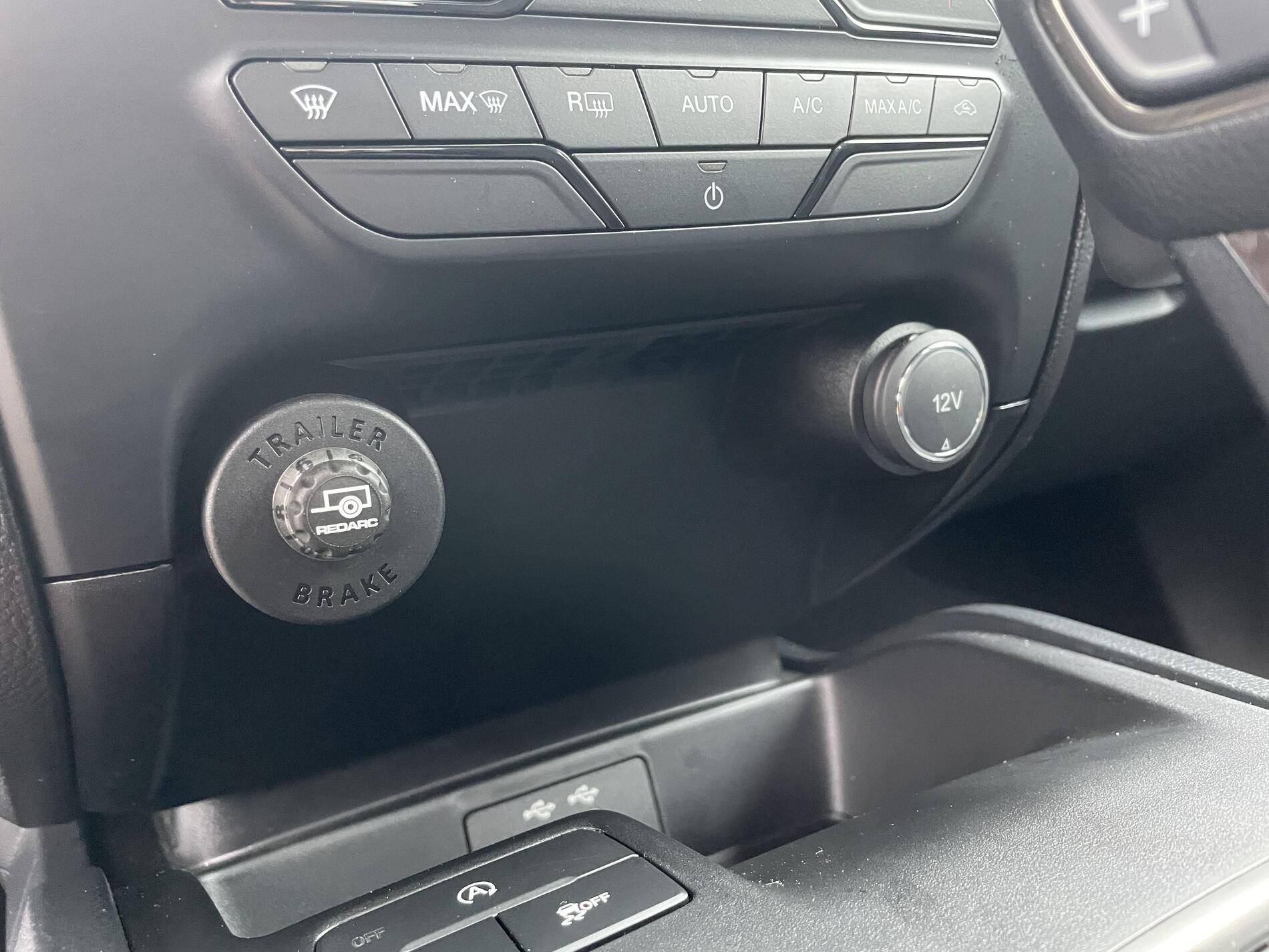

They're good units, if somewhat pricey, I use the Tow Pro Elite myself for a dual axle caravan weighing in at ~ 2400 Kg. I put the controller in the centre console in a fitting I 3d printed, and the box behind the drivers side kick panel.

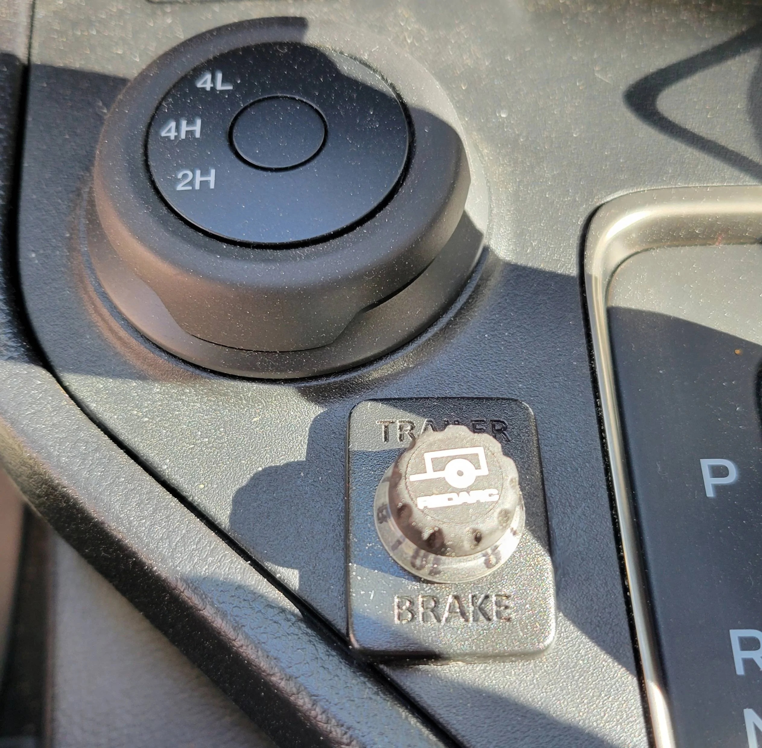

Nice. The hardest part to me was getting the 4 wire pigtail out of the dash. Here's my controller.

That's a good spot for it, in fact that's where Redarc recommends it for Rangers. I didn't do that because some kind previous owner had previously had a brake controller in the car and then not so kindly removed it before trading it! So I had most of the wiring in but non standard colours and install, nothing labelled, so once I figured out which wire went where, I just put it where the existing wires would easily reach.

The blank you used would be a switch for the Power Mirrors on the XLT and Lariat. That said to my understanding that particular brake controller is top notch! I have thought about it for my old Pathfinder, but I don't see myself towing that much with it that much.

Without power mirrors, I think that's a pretty cool spot. I removed the left 12v port for mine on my XLT. I've been happy with the Liberty. Unless you know you'll need more manual controls off-road, it does all you'll need it too.
