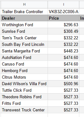

Ugh. I talked with my Ford dealer today about. They are asking > $500 for the Ford brand/approved BC just for the parts! Ugh
Yup. I looked at local prices recently and they're *NUTS* so I picked up the one for $300 and have yet to do the install.

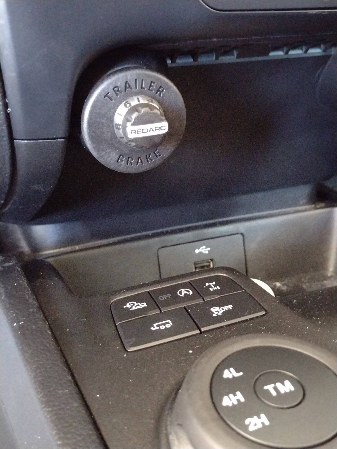

For those who have the Tow Pro Elite installed. How bright is your remote control knob? Mine might be visible at night but I have not checked in the dark, but during the day mine has no visible light. It is working according to the test light procedure. If i have the control in my hand I can see the light from the backside.
It's very dim. Not an issue though.

I think I comprehend your concerns now. It does tend to make one question the install correctness. Same here, now that you remind me. All is good with mine.
Just not as bright as I expected.

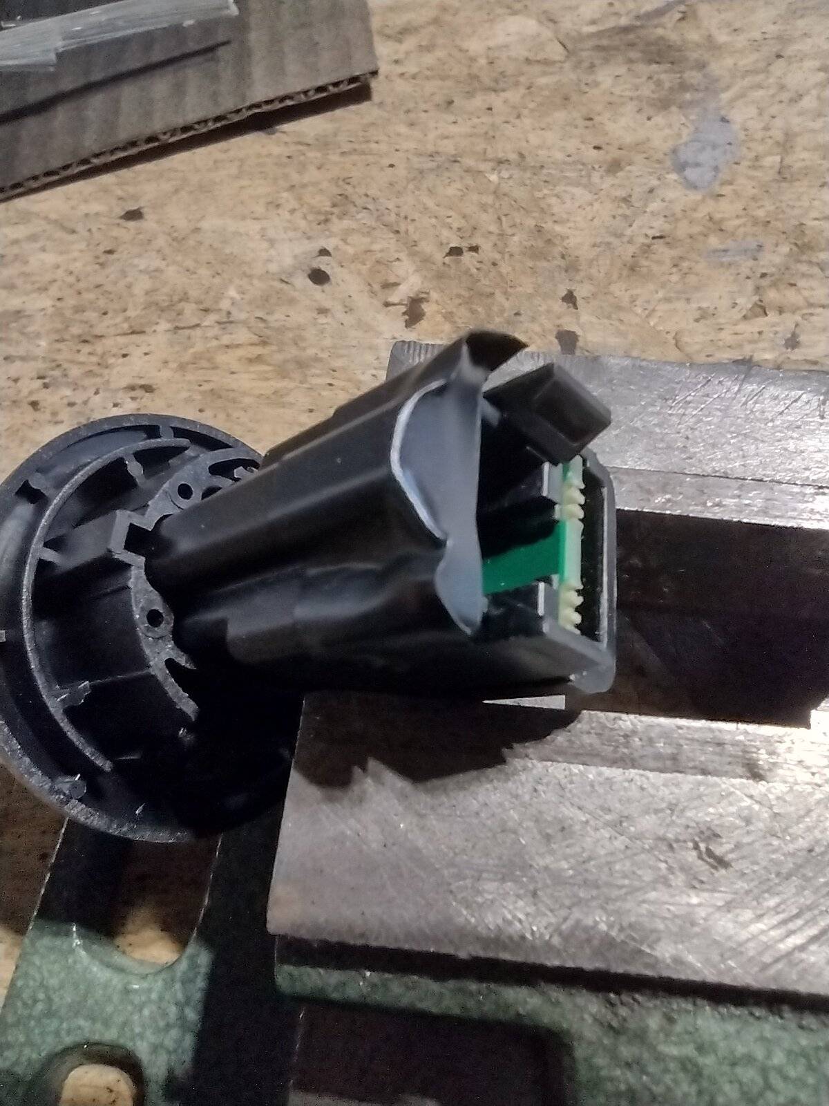

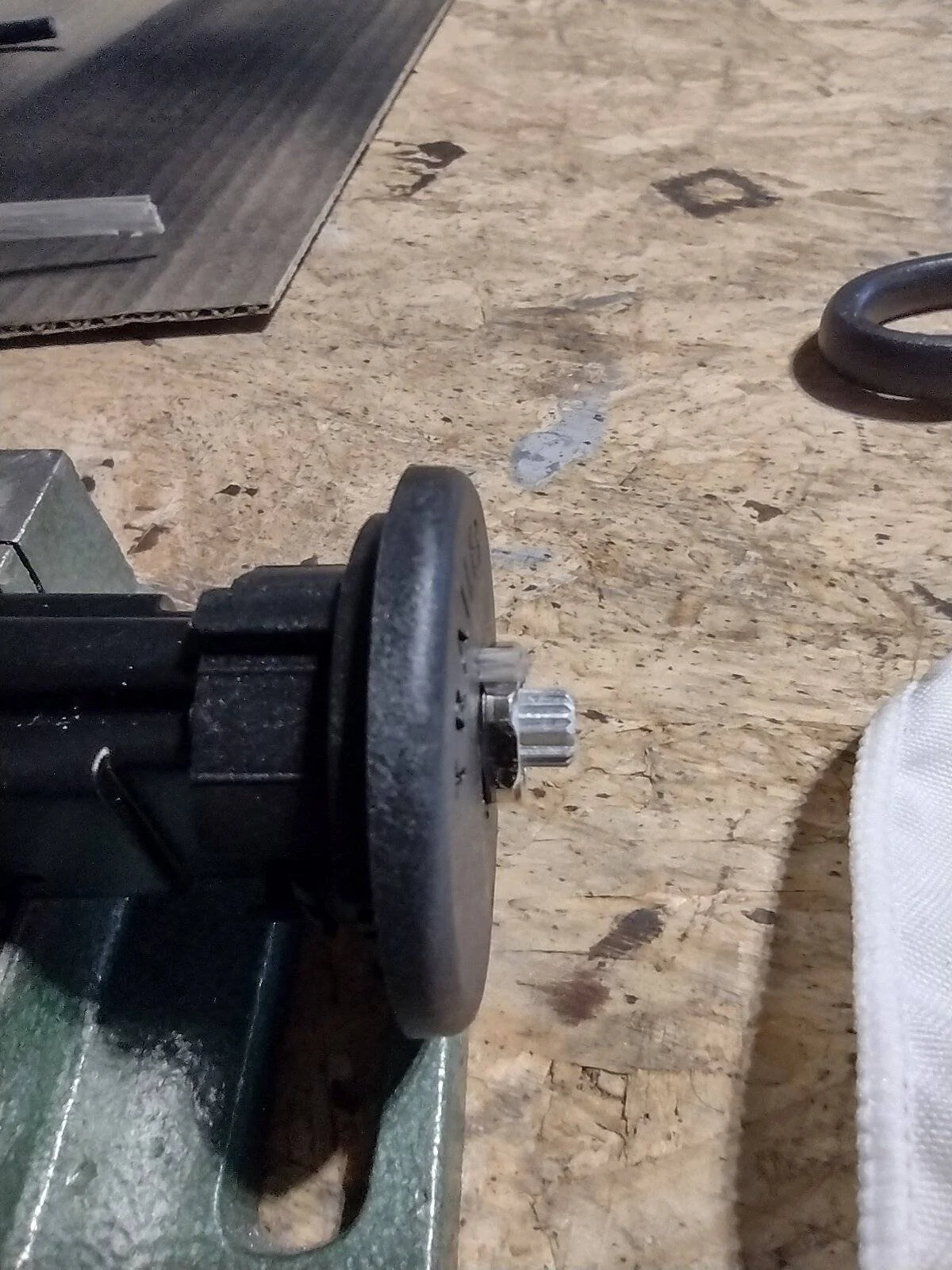

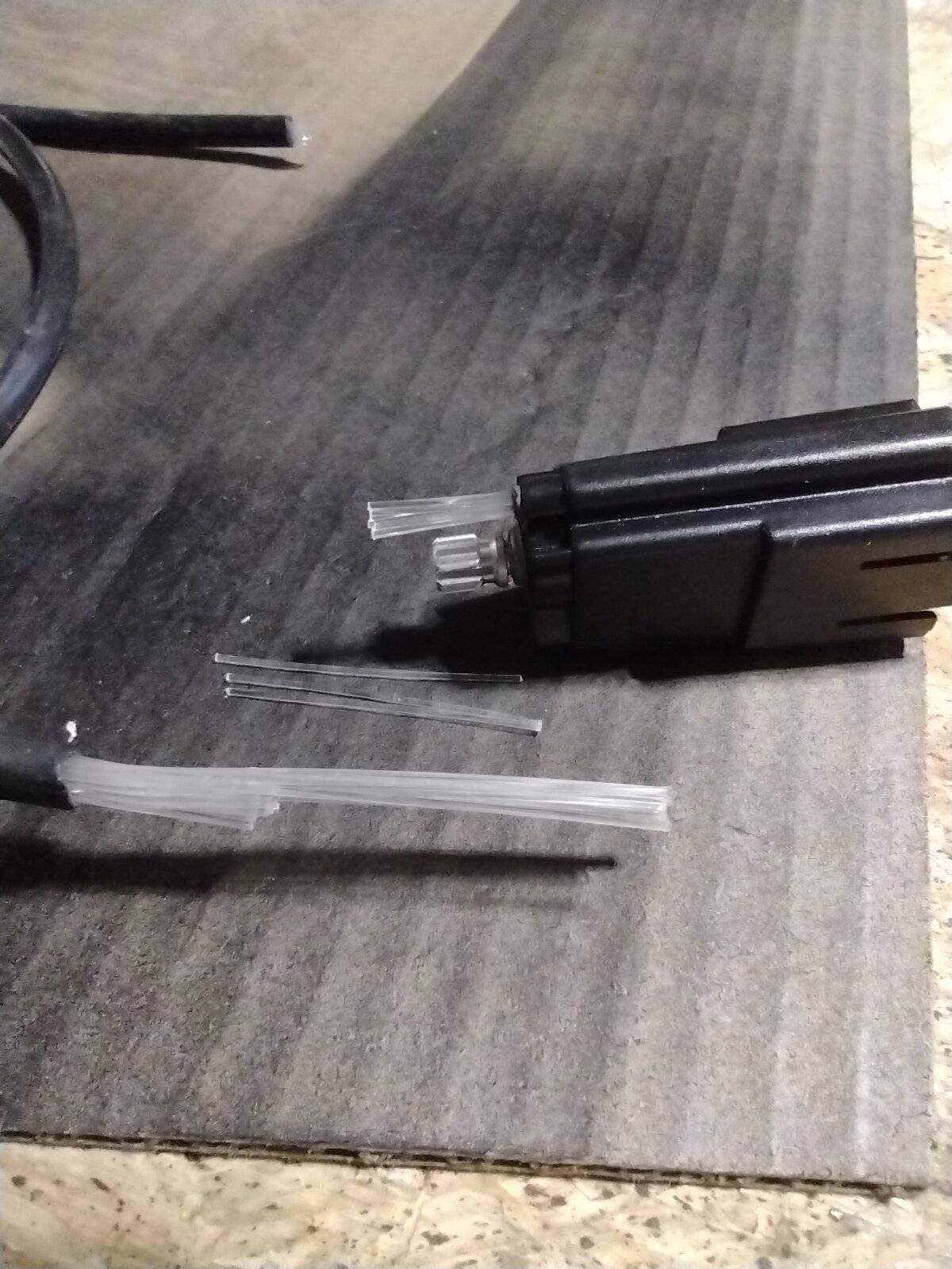

Finally finished up my install today. Put it in the 12V outlet. Since the light was not very bright I modified it a bit. Had some fiber optic cable so I took some of the fibers & inserted them into the lite source hole of the remote & thru the hole in the mounting plate, so now the fibers are wright behind the dial. Also I put a piece of electrical tape on the back side of the remote to help send the light thru the fibers out the front. Much better now. Tested with light bulb & all checks out. Now for a trailer. :like:

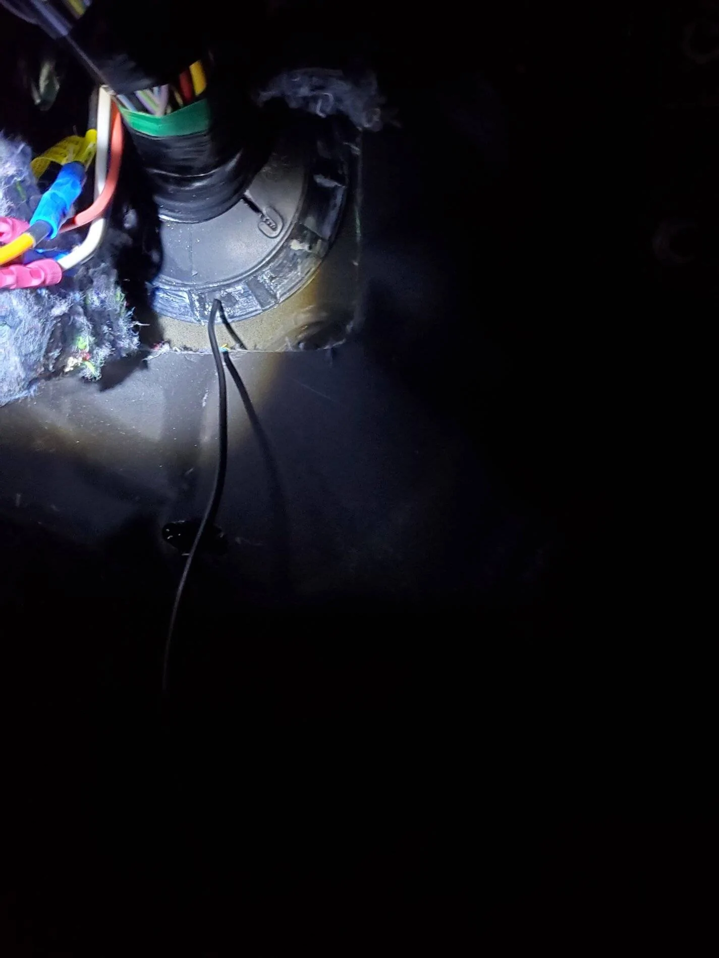

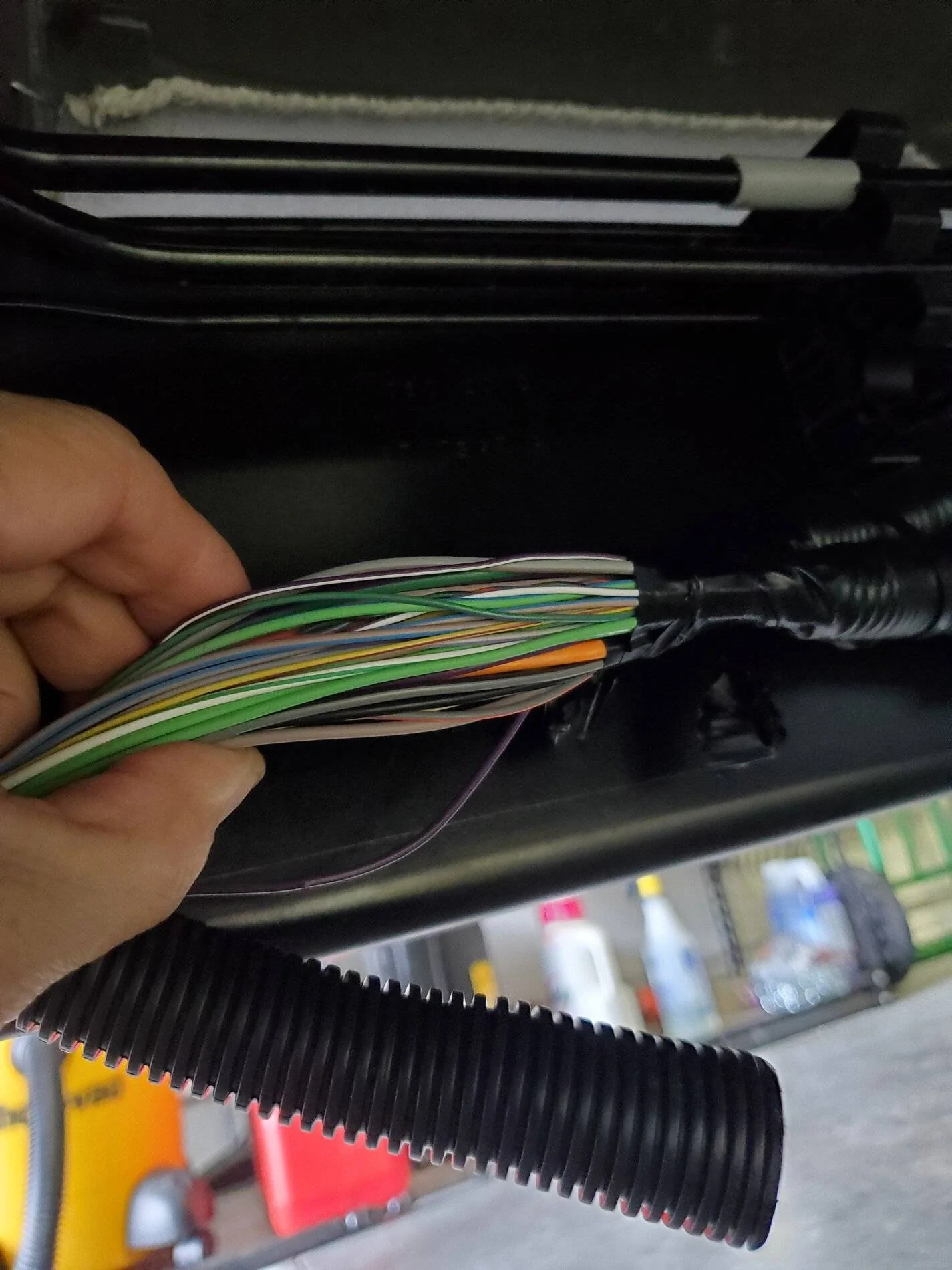

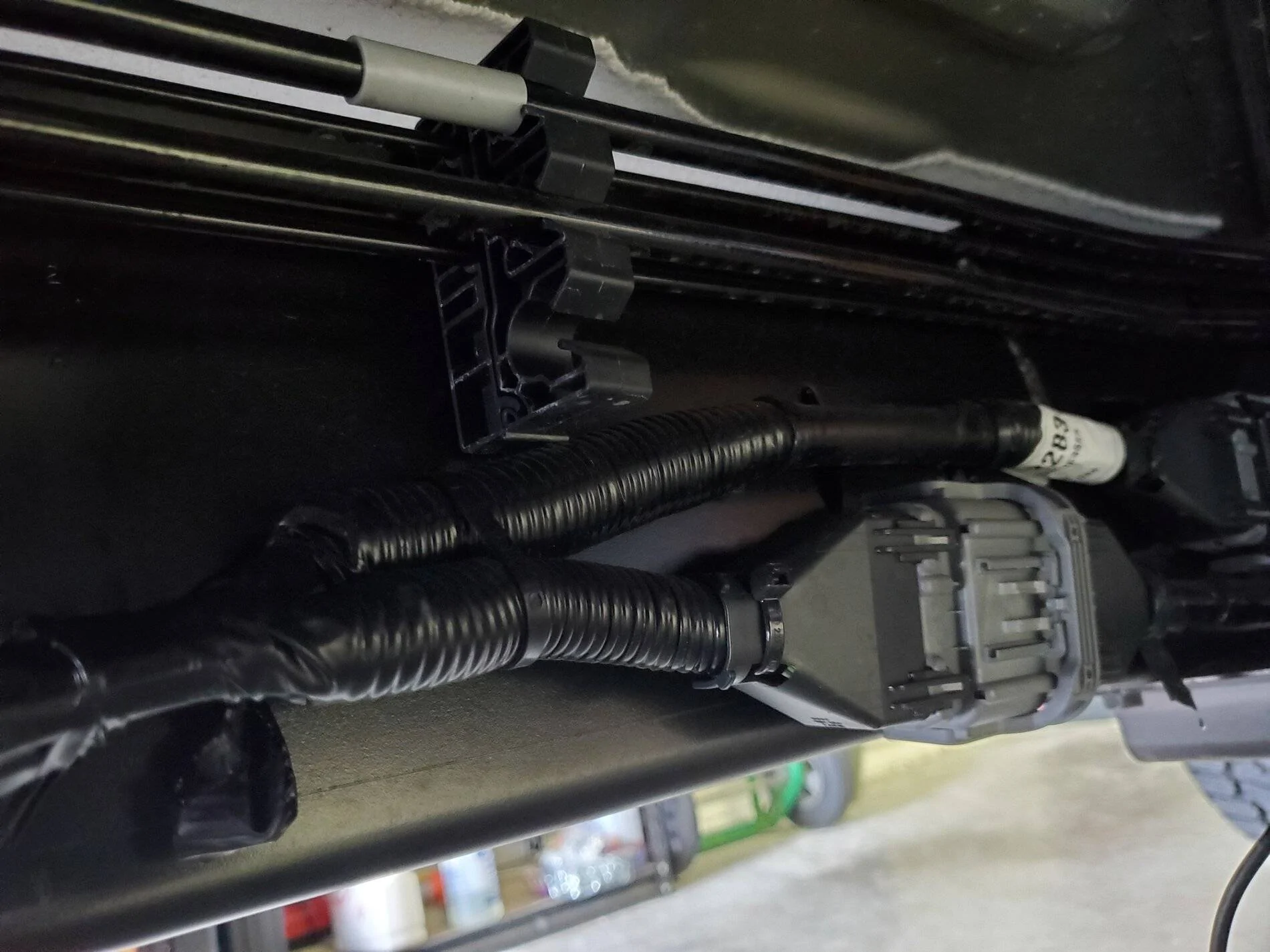

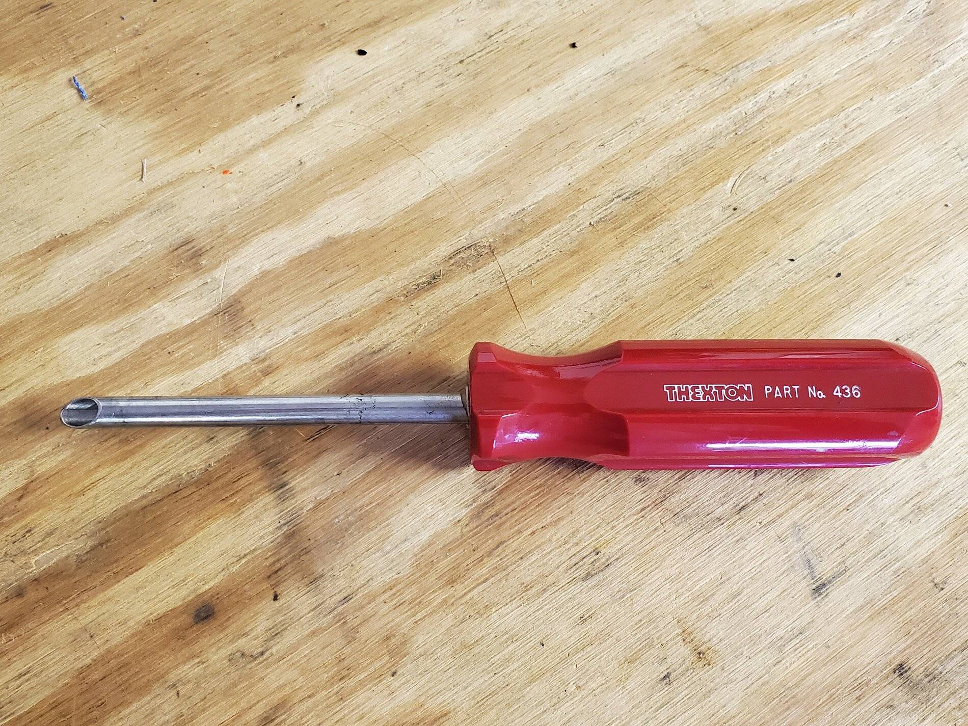

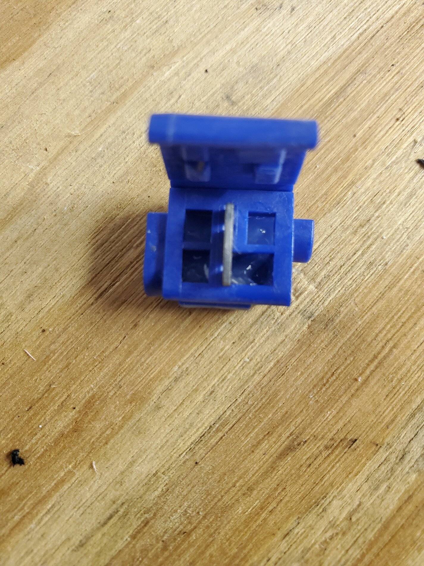

Installed the Redarc tow pro elite in my 21 Lariat over the weekend. I didn't use the brake pedal for the brake signal I instead ran a wire threw the rubber grommet at the fire wall and tied it into the rear break light wiring underneath the drivers side door. The wire you want to use is violet with a brown stripe on the 21 Lariat, make sure to double check as there is a violet with a black stipe in the bundle that looks similar unless you put under a light. Below are pic of what I used and where I made the connection. The connector I used has anti corrosion lube in it. The wiring cover fit perfectly back over the new connector and was retaped. It took about an hour to run it has I was meticulous in running it along the wiring harness that leaves the fire wall and runs back to the rear.
In my opinion (others may vary) this is the same thing Ford's break controller is doing only with a $75 extra box needed. Common sense would tell you that if either the emergency brake system or the active cruise control would kick in on an emergency situation it's going to activate the rear tail lights to let the person behind you know that the truck is breaking. Hence the reason why Ford has you connect to the 3rd break light with there controller.

I think the Lumen module that Ford uses accounts for some extra things that simply tapping a wire directly may not.. such hazard lights vs braking, and also flashing brake lights (AEB flashes them on some vehicles instead of just turning them on). Does your setup account for things like that?
The biggest thing it accounts for is Lariat vs non trims because the signal is different for the LED CHMSL.
I'm wondering if his brakes are going to go ON OFF ON OFF ON OFF if the hazard lights are used, or in an AEB emergency if AEB pulses the brake lights to alert other drivers
Luckily the CHMSL isn't tied to turn signals but yeah, I'd be worried just tapping in without the module.
