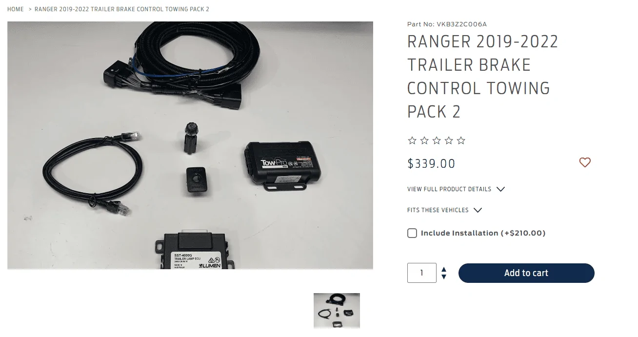

As for the install price, the accessory site shows the install at $210, I think that was only $100 when I bought it. So, in theory if you order it on the accessory site to a dealer that you can select for install from parts bought there, you should be able to get that price.
Dealer I had my package delivered to subtracted the $100 from the final install cost.

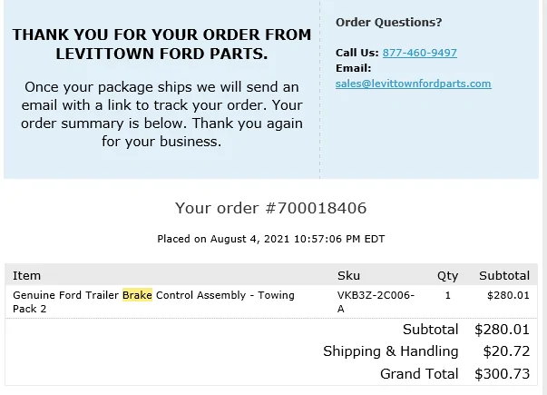

I have a brand new controller if anyone wants to buy it at a discount. My first order was lost and with my trip quickly approaching, I purchased a 2nd one and had it shipped overnight. Of course the first one showed up the next day, thus now I have two. The only thing missing is the grey wire connectors. The kit comes with both grey and black and my truck called for the grey ones. As I posted above, the grey connector broke when I tried forcing the wires in. When the first grey connector broke, I took the grey connectors from the 2nd kit and tried those. Those too broke and that is when I decided to just cut off the factor connectors and wire direct.
This was last summer and I only recently found the other kit in my garage. it's still in the box and has never been installed or used.
Therefore, I have a brand new controller with the black clips only. I paid $300. for the kit. PM me if interested and make me an offer.
