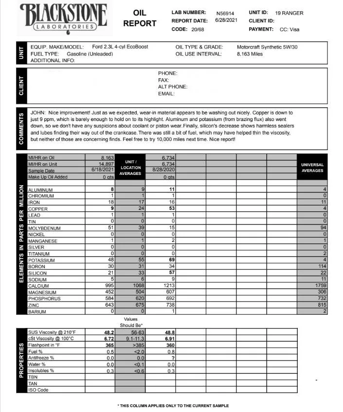

My latest report. This was before a 3,300 mile trip.

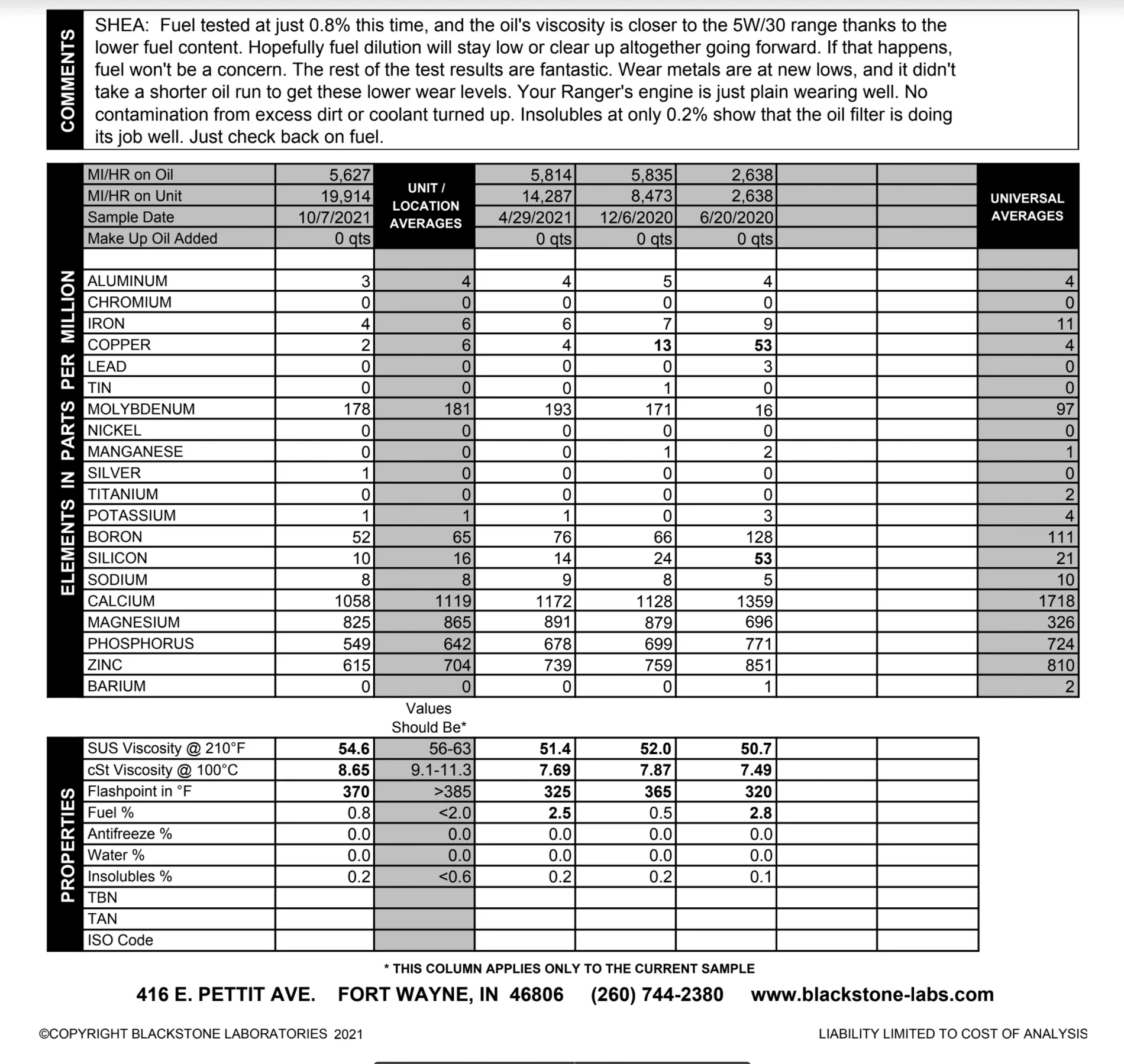

Here are my latest results. I can't complain.

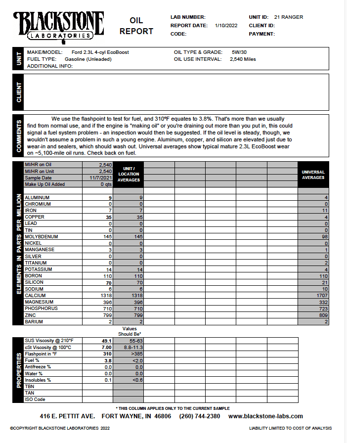

First Oil Change. Thanks for starting this thread!

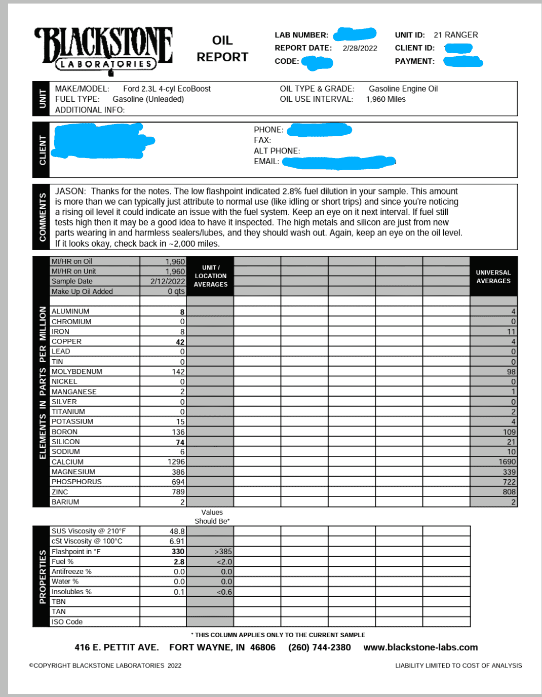

First oil change here as well. 2021 Ranger

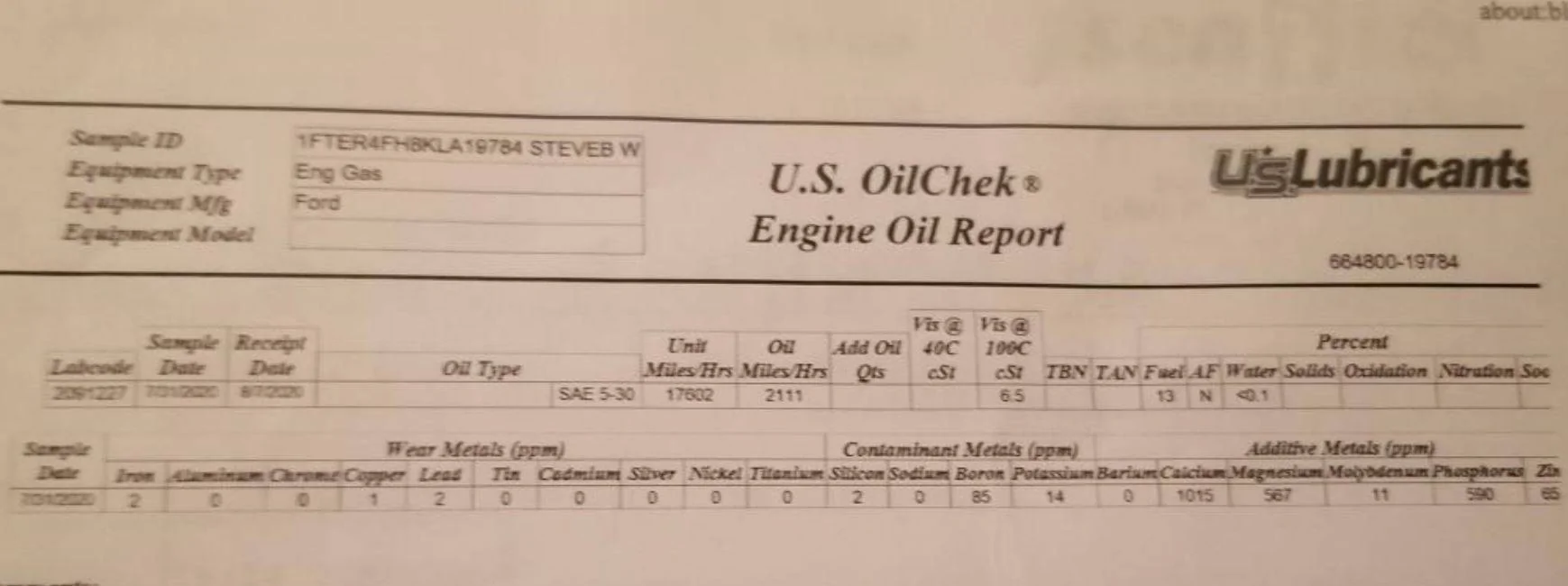

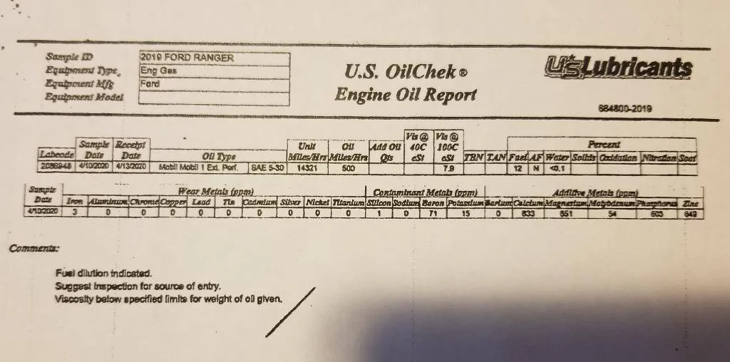

Here are 2 of mine, both taken and sent out by the dealer. One is from April with 500 miles on the oil (12%), the other is from July with 2100 miles on the oil (13%). For both of those the level was just to the twist. I now have almost 37K on the truck and the oil level rises to about 3/8in above the twist by 2k -3k miles and stays there until I do the next oil change. Ford claims it is perfectly fine and refuses to do any more work on it. They took several other samples when the level was higher, but Ford refused to share the results with me.

As I said, the FEW reports I have seen, with multiple samples, seem to show a seasonal trend. One time reports can show no meaningfull data. Yes, it shows high fuel delution in the oil, but that is ALL it shows. It takes a number of data points (more than two) to lead to a trend or possible cause.
I am not saying that there are not trucks with a real problem, and yours may well be one of them. But there is by no means enough data to say there is a cronic problem or a design issue with the engine. Oil delusion is a known issue with ALL direct injection engines. What exactly is causing it and how much is to much, is still up for debate. I do not beleive this is a design flaw or widespread problem with the 2.3 in our trucks. Why some individual members of a specific engine type have it to a worse degree is an even bigger mystery. How to fix it is the $100,000 question.
I do feel for those that have the acute issue and their dealer is not helping you. I'm sure in most cases it is the dealship not Ford causing most of the problems. True Ford does need to start taking the issue seriously and try to solve the issue or at least figure out what what is causing it. They at least need to take better care of the people that have the issue. I'm sure knew the reason and how to fix it they would.
This thread is the first attempt I have seen to compile some meaningfull DATA on the subject. This is a step in the right direction. Up until now it has been alot of complaining and pissing and moaning that is also scaring a lot of people into thinking about and looking for an issue they may not have. As far as I know no one as lost an engine to oil delution.
Full disclosure: I am one of those lucky ones whos truck does not make oil. I have 2-1/2 years of trouble free ownership. My truck starts and runs great, it shifts smooth and pulls my camper without issue. I love my Ranger.
I'll crawl back undery soup box now and go back to watching from afar.

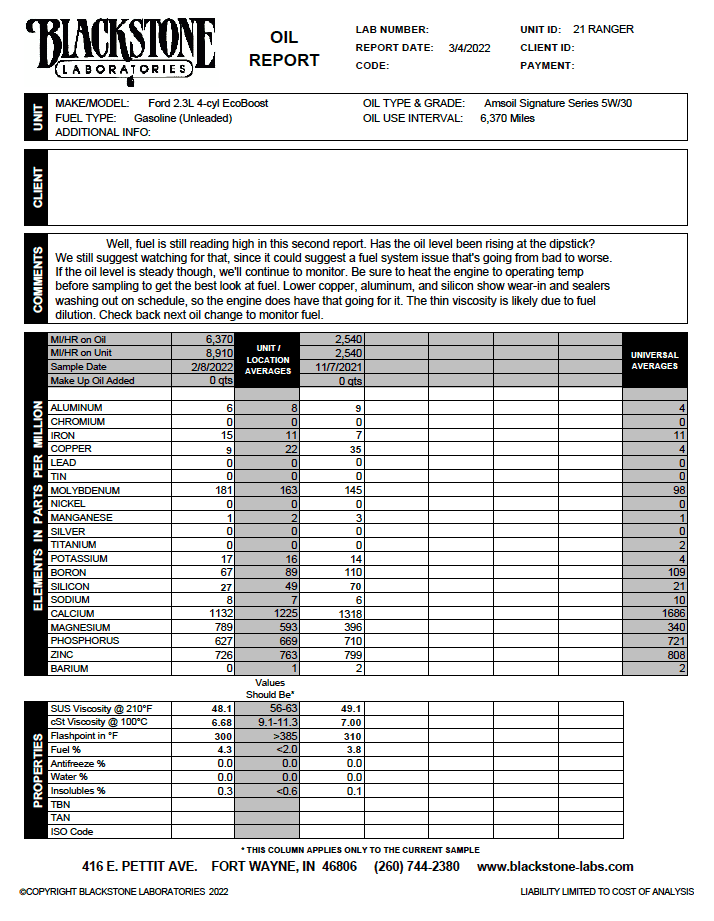

Second Oil Change (Amsoil Signature 5W-30): Shows viscosity diluted down to a 0W-20 but not showing any increased wear at all after 6K miles.

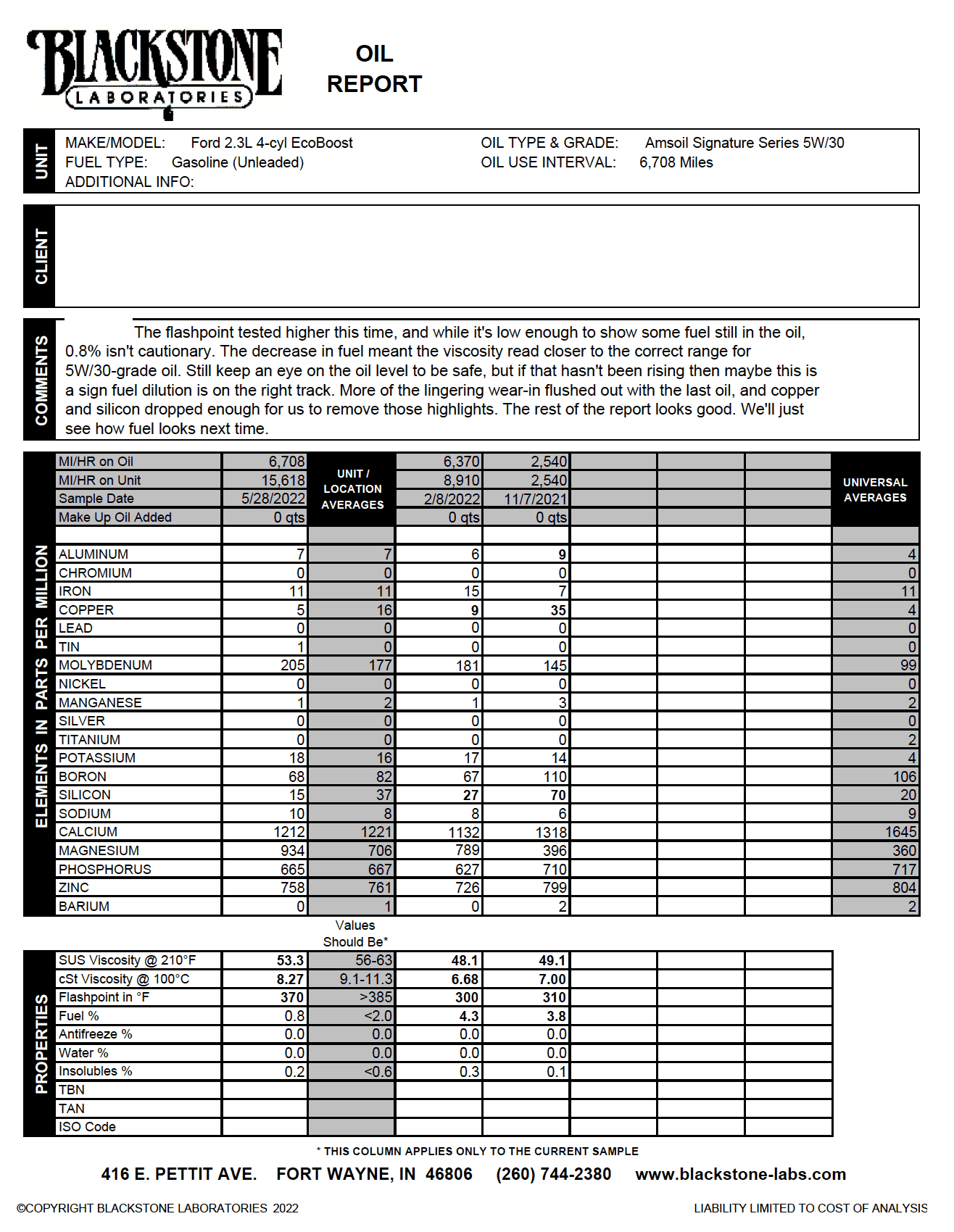

Big improvement for this OCI. Likely due to warmer weather. Down 3% on fuel.
