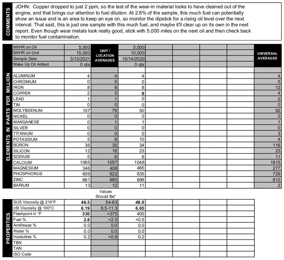

Well damn, after my last oil test at 15K miles, I went from the happy <.5% camp to the questionable 2-3% camp. I updated the my own entry in the poll. Nothing really changed with my truck setup or usage.
2.8% is a little concerning but isn't enough to make me immediately run to the dealer and start making a stink - particularly since for most people dealers and Ford aren't doing shit. I'll just keep an eye on the oil level and see what it is at 20K miles.
My viscosity numbers were bad before when I had good fuel content numbers, but now they are worse. If my fuel content stays at this level or gets worse, I'll have to start changing it at 3K miles.

Winter driving in Wisconsin likely played a role in your higher oil dilution.

Good point. The way the timing is working out, my next oil change is coming after a full hot summer of driving, so we'll see how that factors in.

Nah, like I said I'm not running to the dealer or doing anything about it. IMHO it's the 5-10%+ guys that have to worry.
I checked my oil level and it was 1/8 inch under the top circle. Will check again in a month.
I think people overall are just a little concerned about engine longevity. Ford's silence and lack of action doesn't help.

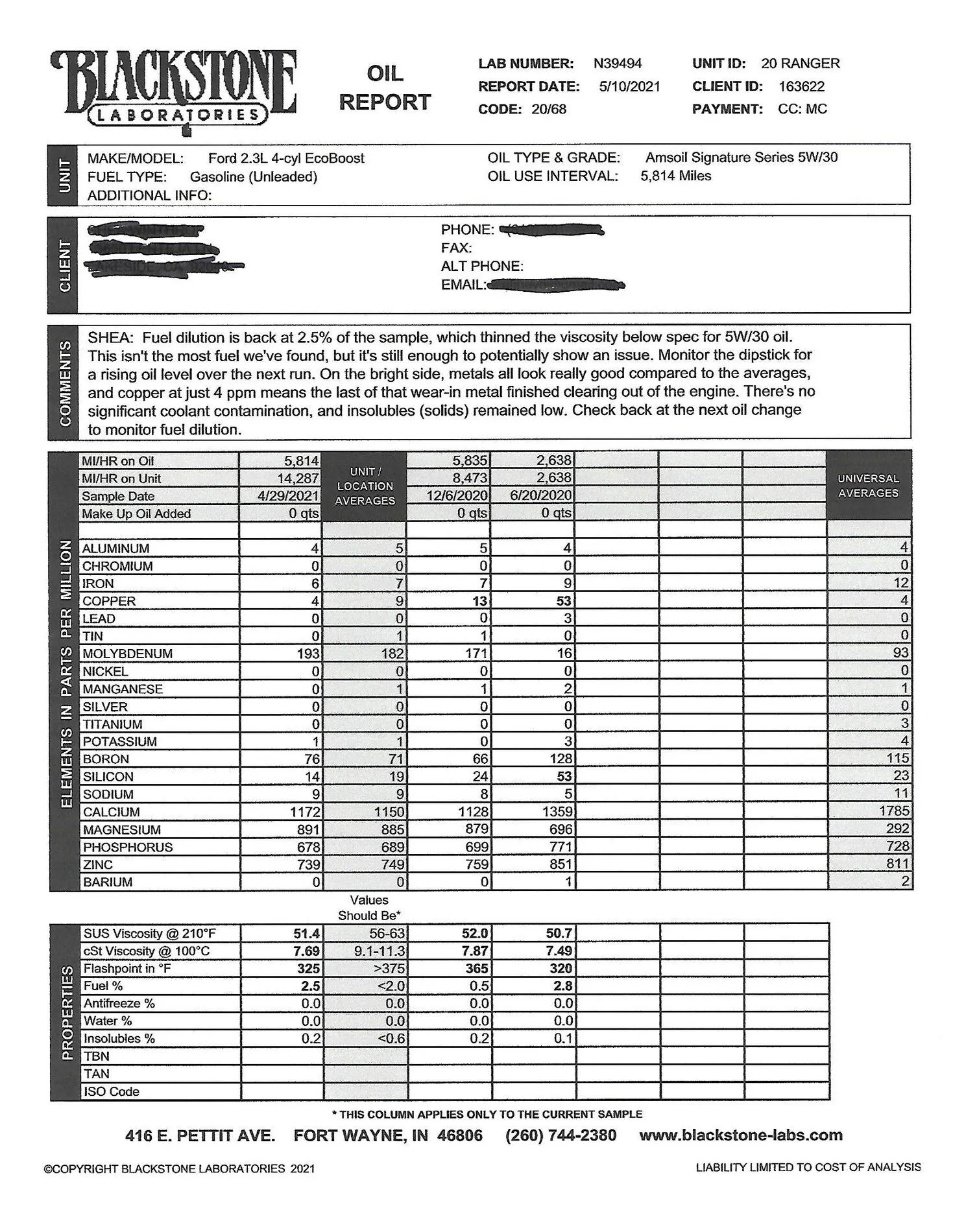

Well, I'm posting up my third oil analysis. This was done after 5800 miles. Fuel in oil went back up. My first test with factory oil was 2.8%, second test with full synthetic was 0.5%, and now it's back up to 2.5%.
Driving habits have not changed. Mostly hwy driving and it doesn't get that cold here in SoCal in the winter, so I don't think that has anything to do with it. I'm scratching my head with this one.

Law of the universe: nothing is random! we just haven't figured it out yet.
Question: are you having dealers pull the oil during a change? Gotta be sure to get it mid stream, and not beginning or near end. Also pull it nice and hot without it sitting around too much.

No, I do it all on my own. Truck is driven first to warm up before I change the oil. It's pulled mid stream. ?‍♂

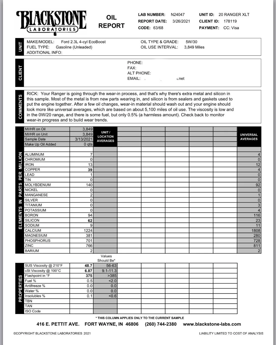

That’s my first oil change. I thought I might have a problem before I sent in the sample. Oil smelled like gas, level had risen to the twist. When I got the results back I was like phewww. So, I’ll keep my eye on it, enjoy the truck and see where it goes! To date I have not heard of one instance of this being a problem of engine failure or fire.
I will be adding a catch can as soon as I finish making it. That’s a thread for another day…

Wow, up to the twist and only 0.5% dilution according to Blackstone. Either the Ranger dipsticks are whacky or Blackstone’s fuel % measurements are whacky.
