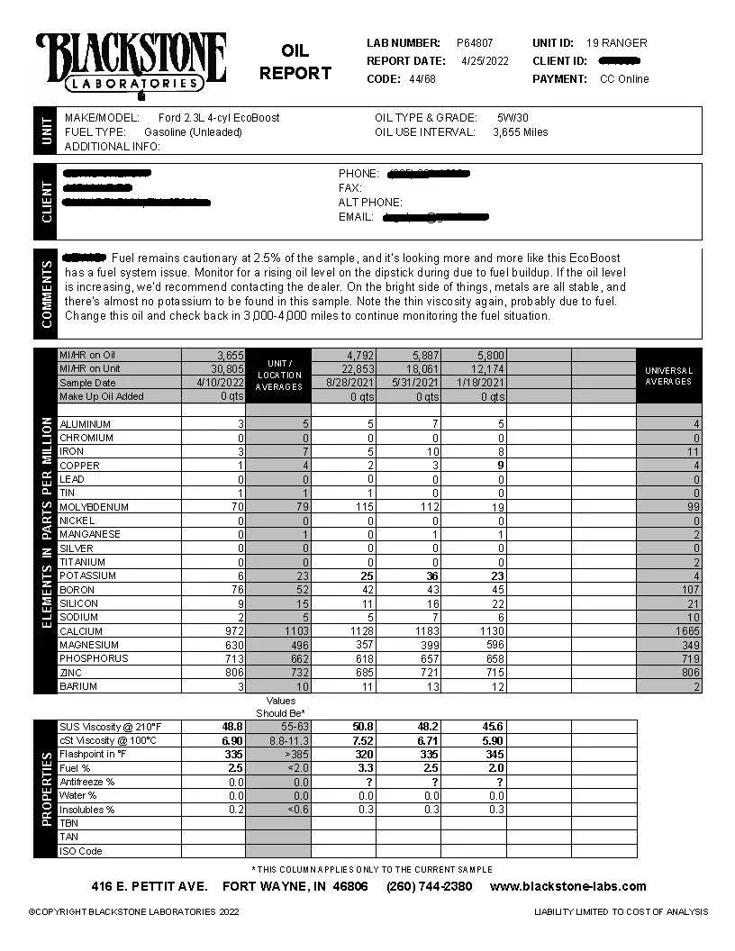

i dont mean this like a dick or want to sound like it but, how much does it cost for the labs to test and report findings? Im not saying this is not or cannot be an issue. however, oil in fuel is pretty common for some engines. so far it sounds like the only sure result is that the labs testing this is making more money. my uneducated guess here : one of two things. 1. operating conditions like weather, driving habits, oil used, fuel used and so on. 2. folks over reacting to something that is for the most part normal. (again not saying it is not an issue) We have some members in the forum that are near or over 100k on the 2.3 ranger and no engine problems. dealers and ford likely think if the engine lasts XXXXXXXXX miles without an issue related to fuel in oil then its a non issue. to them the engine is meeting its intended service life. I am interested to see lab reports if someone has a bad report or a malfunction of some sort related to fuel in oil. id bet a donut ford is well aware of what the issue is, what causes and what conditions etc. they have simply decided its not relevant to the durability of the trucks and not worth making a change. they told thousands of mustang v8 owners in 18-20 that the ticking noise of piston slap was normal and did not have any negatives for the engine lol. to be fair a lot of the folks didnt have a real issue, they just were not used to hearing all those fancy new fuel system noises. as far as i know ford has stuck to the no issue story and directed dealers in more than one tsb to tell customers its normal and ford will not pay or warranty investigation of the noise. sounds like what some of yall experienced with the fuel in oil thing too.
Here is what you are missing, as I see it. Only a percentage of Ranger's are experiencing this issue. What percentage? I have no idea. Therefore, the argument that we aren't seeing Ranger engines blowing up before 100k miles is proof that it isn't a problem. Well, not really. If only 5% have oil dilution issues, then those are the only ones that might have long-term engine issues. I have a first year (2019) Ranger and, due to Covid and remote work, have only 33k miles. So too soon to have any engine failure issues. I suspect my mileage is not uncommon. And to be fair, my Blackstone reports are not showing any excess engine wear even though I am getting over 3% fuel in the oil before 4000 miles. I am changing my oil before 5000 miles. At the very least, this issue is costing me additional money in more frequent oil changes and Blackstone analyses.

JustSteve
Nov 26, 2019
74
87
2019 Ranger XLT
2.5% at only 3,655 miles. Would it have been 7% at 10,000 miles?
Reactions: JDG
