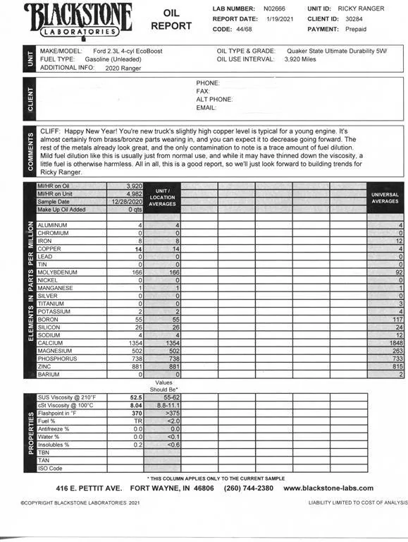

Got a Blackstone report back a couple of days ago. It shows a "trace" of fuel with just under 4k miles. My oil level has been stable and does not smell like gasoline so I'll take it.
Couple more thoughts. These engines sure beat up oil. There is no way I would be going over 5k miles for an oil change.

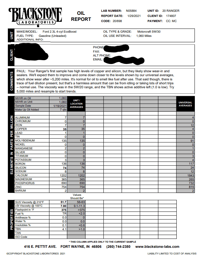

So far so good. My oil had a fuel smell, so I had it changed, and tested, at 1,000 miles. Only showed a trace of oil.

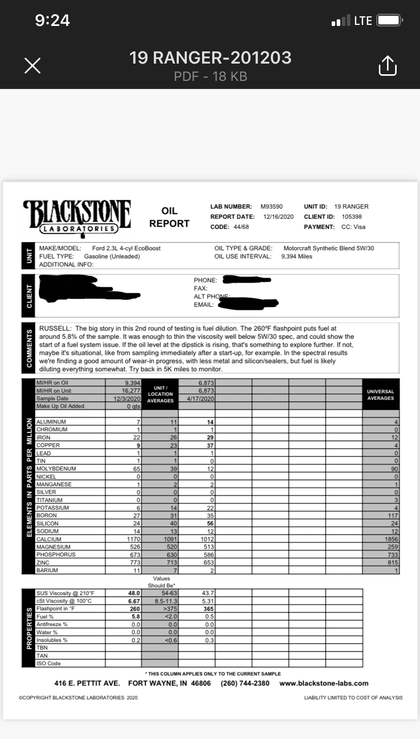

Here's my test if anyone wants to see. My wife has the full megabucks version of Adobe and she redacted the personal information for me. :D
Good to see a US Lubricants test too. @MotoWojo interesting that your truck did ok at first then got worse. I will likely be sending a sample in with every oil change to keep an eye on it over time.
I had a couple Blackstone test bottles left from my motorcycle racing days when I tested often. I asked for more and I see they now come with prepaid shipping labels. Nice. Makes testing oil easy.
@Da Ranger it looks like your results show your 2nd test doing much better. Are you registering your 1st or 2nd results in this poll?
