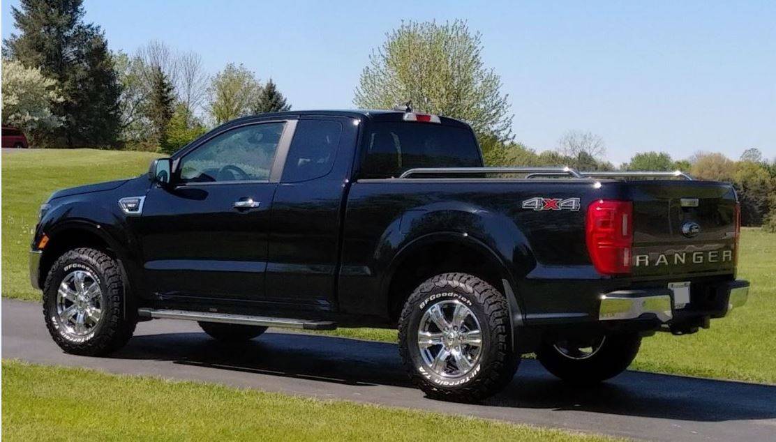

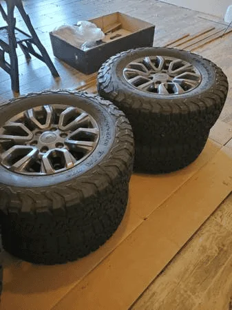

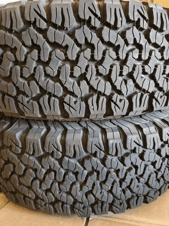

I just got some 265/70R17 BFG All Terrain KO2's installed. Stock rims and no lift, but I'm still really pleased with the look and the quiet ride. Here are some pics .

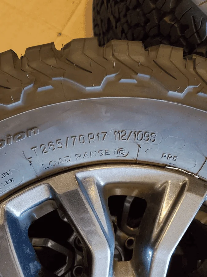

I am thinking about buying LT265/70R17C BFG K02's mounted on Ranger OEM 17X8 Charcoal wheels. My Ranger is stock: no level, no lift. Truck is still under 36 mo. warranty.
1. Will this tire size void the Ford warranty?
2. Will the OEM Ford TPMS be compatible with these tires?
3. Any clearance issues?
4. Any safety issues?
5. How do these A/T's ride and handle on city streets and the freeway?

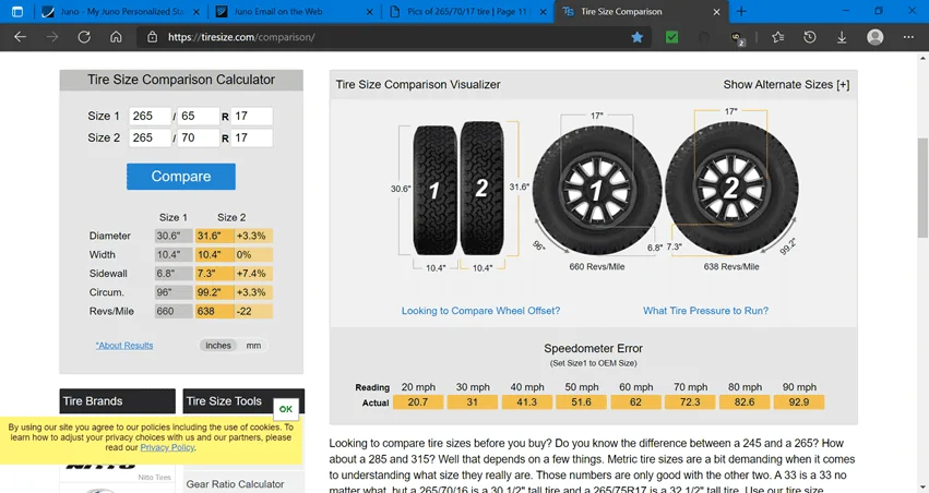

Size 1 below is the OEM tire size that Ford mounts on Ranger OEM 17X8 Charcoal wheels.
Size 2 below is the BFG size mounted on Ranger OEM 17X8 Charcoal wheels.
Any help would be appreciated!

1. I don't know about the warranty. I think that some folks on here have said that Ford would have to prove that a given mod caused the failure to avoid a warranty claim, and my opinion is that it would be hard to prove that this small change in tire size caused a problem, but that's just my opinion.
2. My TPMS sensors still read the tire pressure just fine, but I have increased the nominal tire pressure to 36 psi so I suppose I won't get a "low pressure" warning quite as soon.
3. No clearance issues at all. I did loosen and move forward the left front crash bar before installing the tires since it was closer than the other three, but I don't think I really had to do that.
4. I'm not qualified to speak that that.
5. I can't tell any difference in ride or noise with these tires. They are amazingly quiet for tires that look so aggressive. I also got the "C" rated tires since they are lighter than the "E's" and I don't notice any difference in acceleration or breaking. My average MPG decreased by about 0.3 mpg, but that's the only performance change I've noticed.
I love the look and it's surprising how many people have come up and said they like my Ranger and/or "wheels" since I installed the 265's. Before that, it never happened. One more pic...
Good luck!

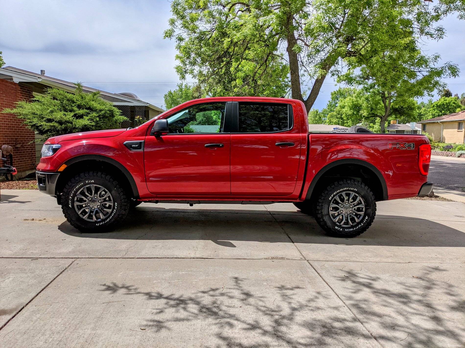

Adding my experience here. Just got a set of 265/70r17 BFG KO2 load range C tires. The tires feel like they grip better and give a more stable feel at highway speeds. Don't feel like I lost much - if any - performance. At the most, first gear doesn't feel as jumpy as it used to be.
Thanks for all of the info in this thread!
Loving the stock+ look!

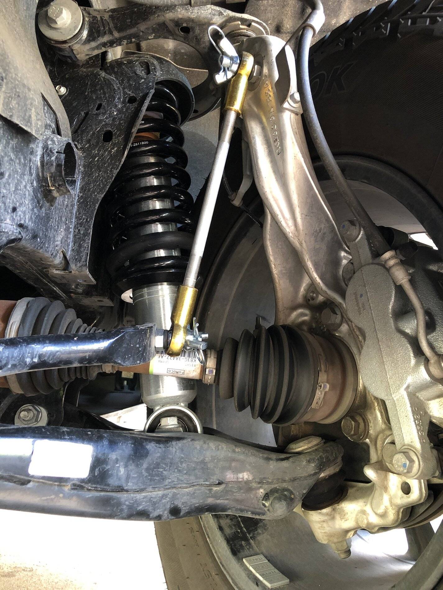

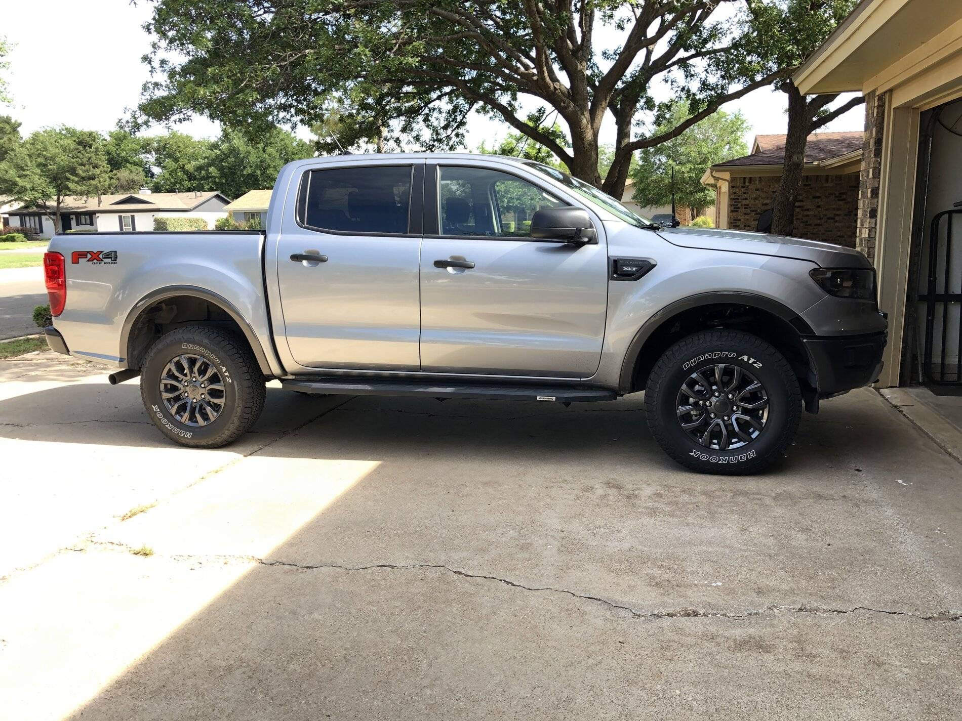

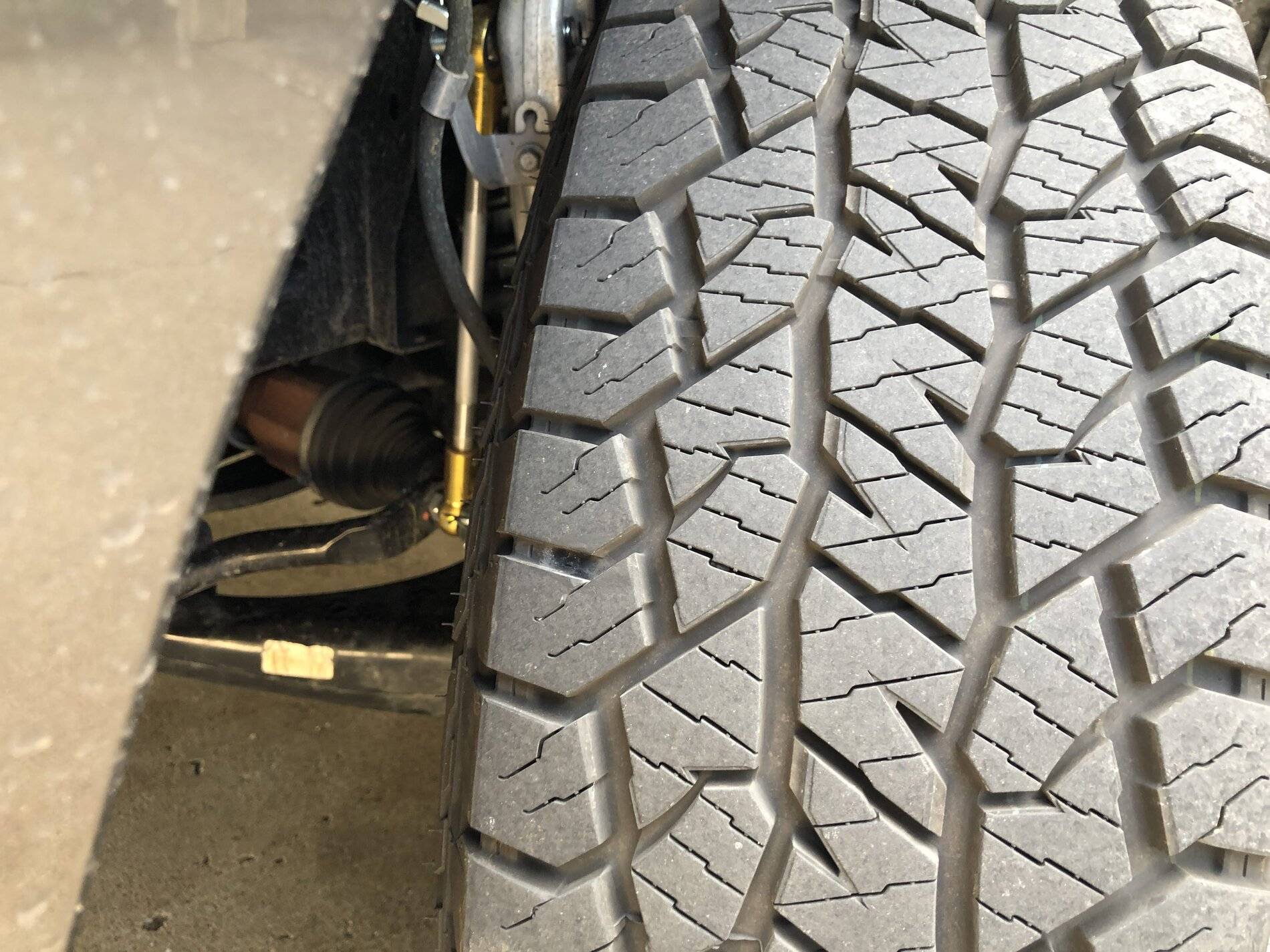

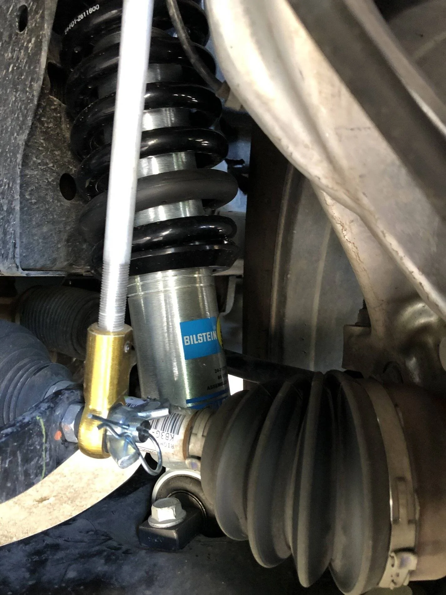

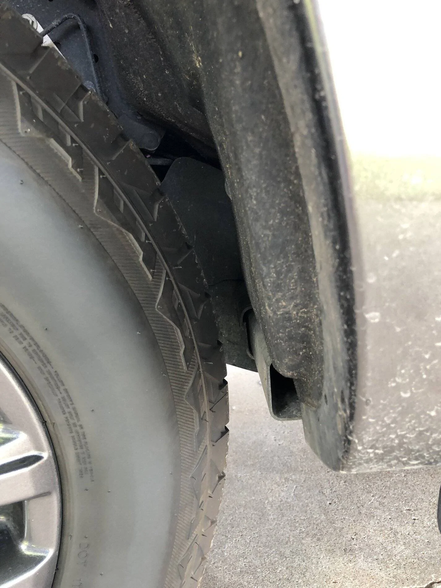

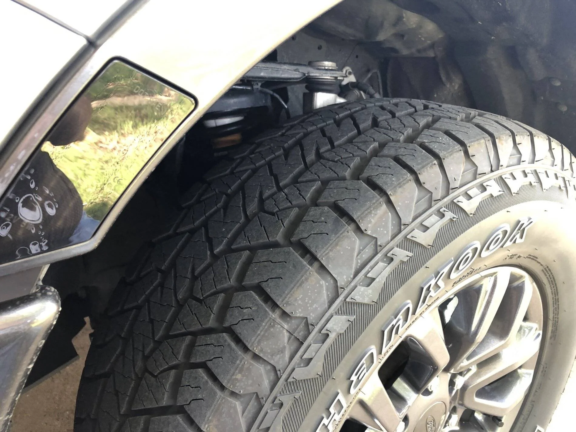

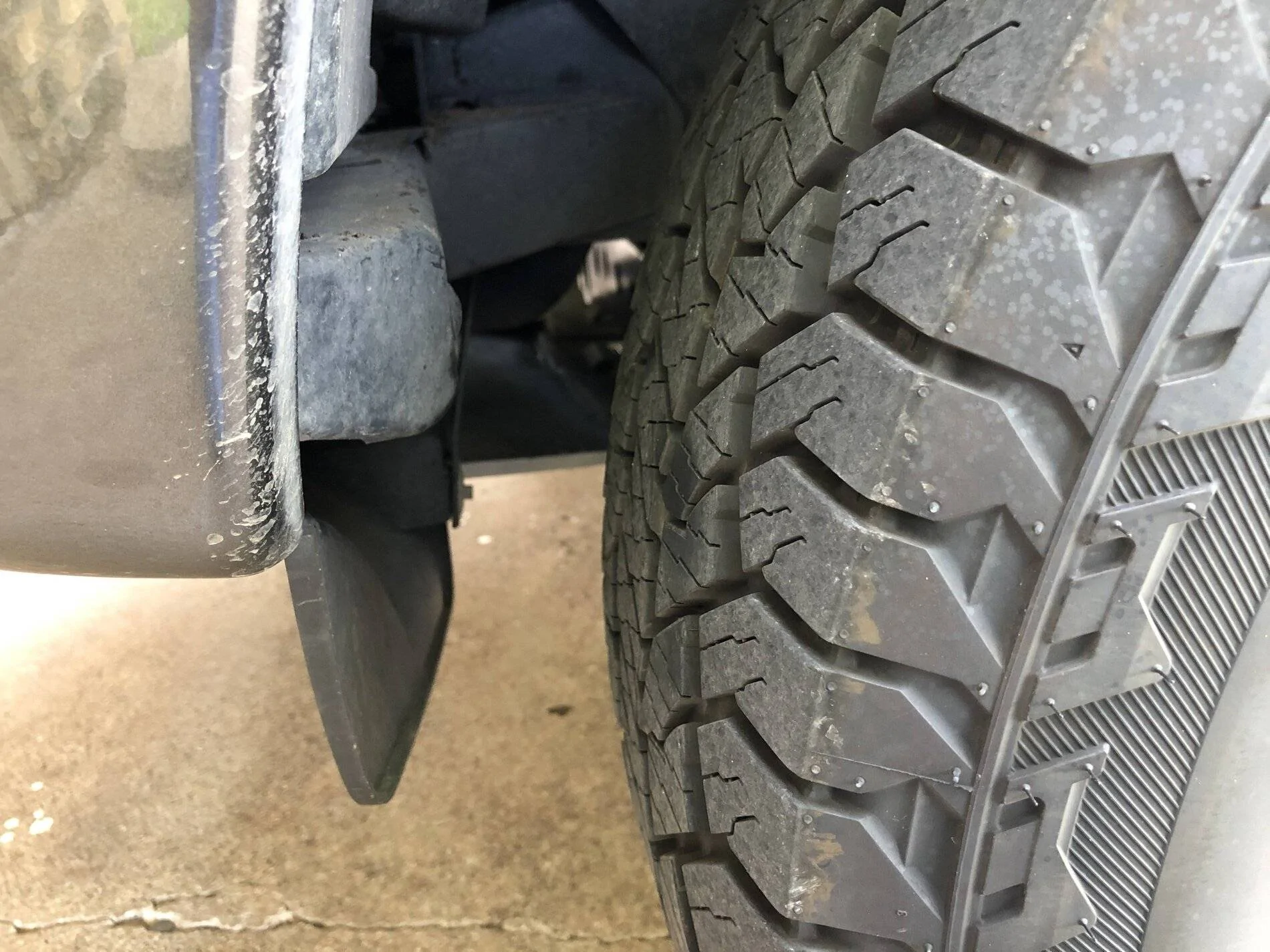

Hankook Dynapro AT2 using Bilstein 6112 front coils and shocks set to 0.80" higher than stock. I also used these tires with the stock suspension. Either way; there is lots of clearance.

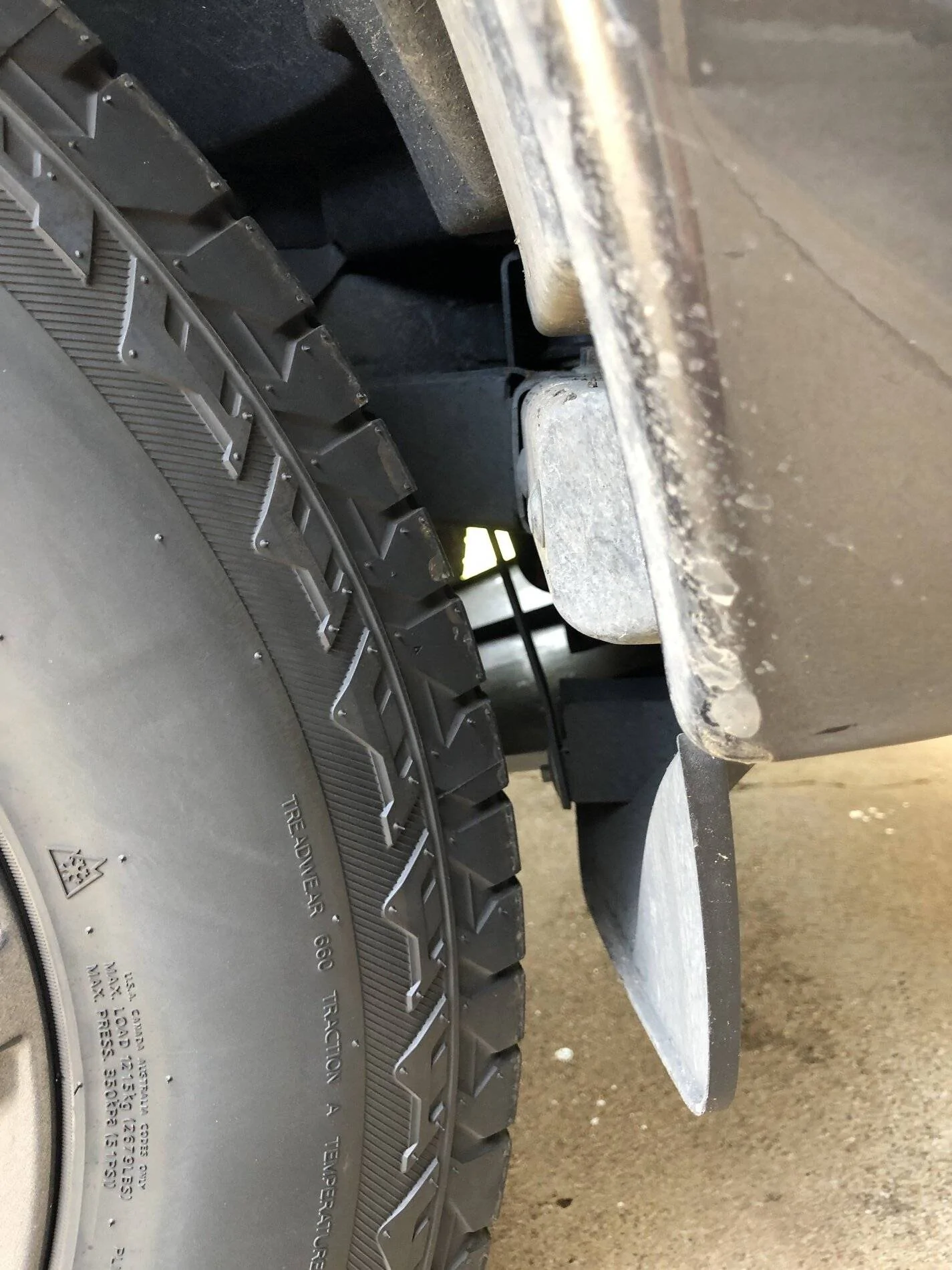

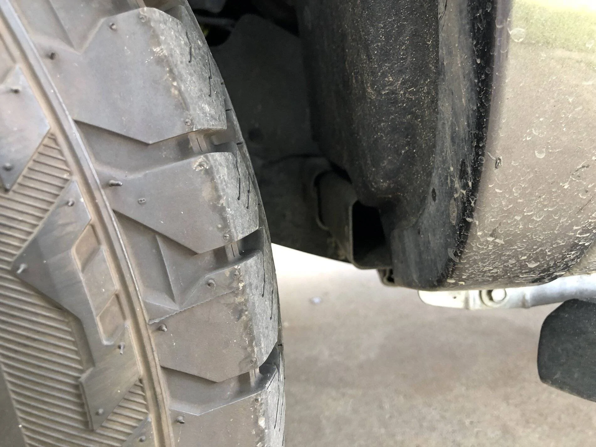

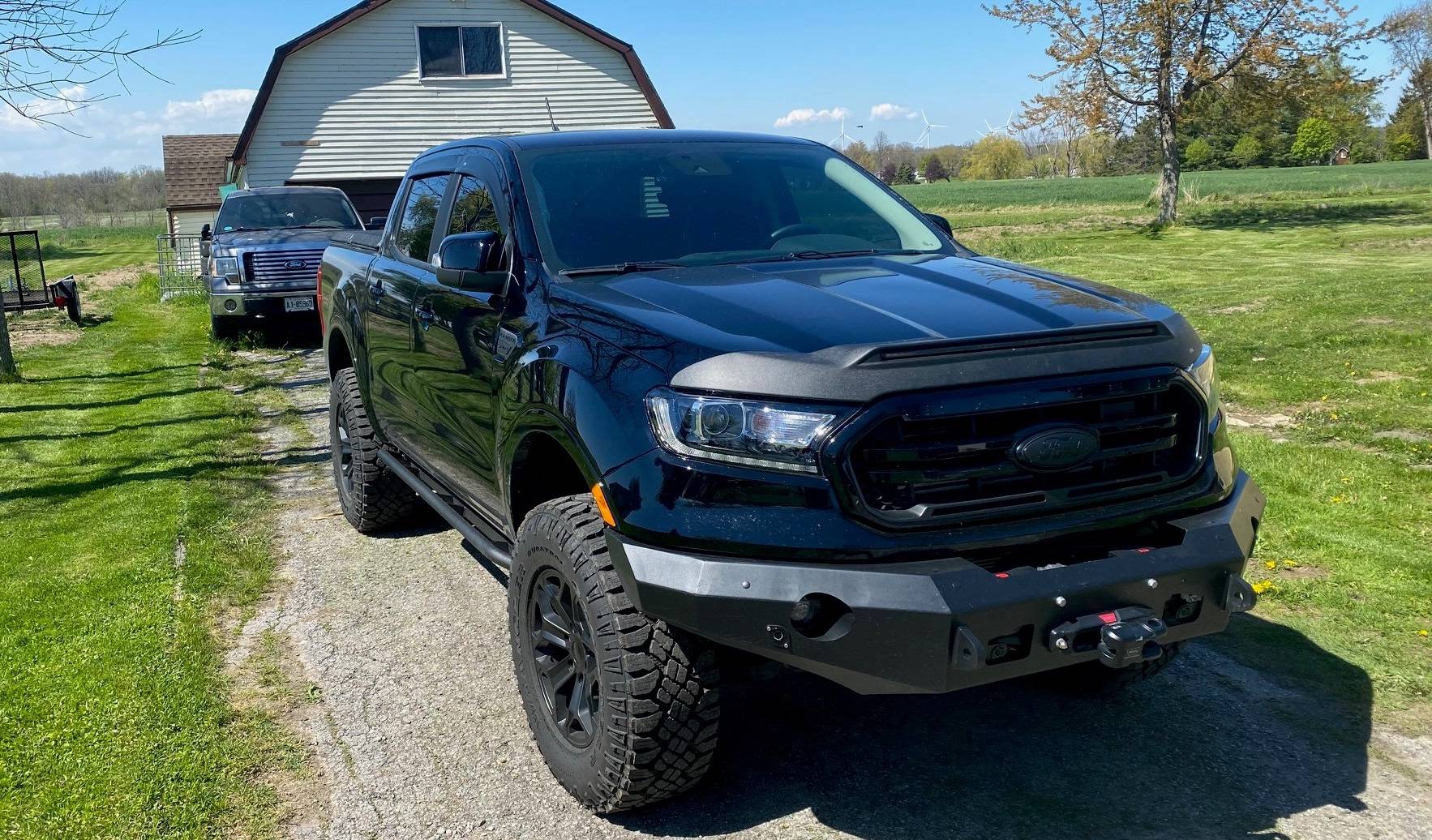

I have 3.5 BDS lift front and rear. I also have Warn bumper, so all the forward crash support is gone. I have Duratracs LT 285/70-17, 10 ply on +35 rims. That moved the inner sidewall 10mm farther away from the suspension, and the outside side wall moved 30mm farther out. Yesterday, I heard rubbing on the rear crash bar, with full right turn, and some suspension compression. Too be fair, I am on factory FX4 suspension still, which is pretty squidgy, but even on 3.5 lift, rubs can still happen. I'm gonna get under and see how far or if it can be moved at all, and trim it back if not.

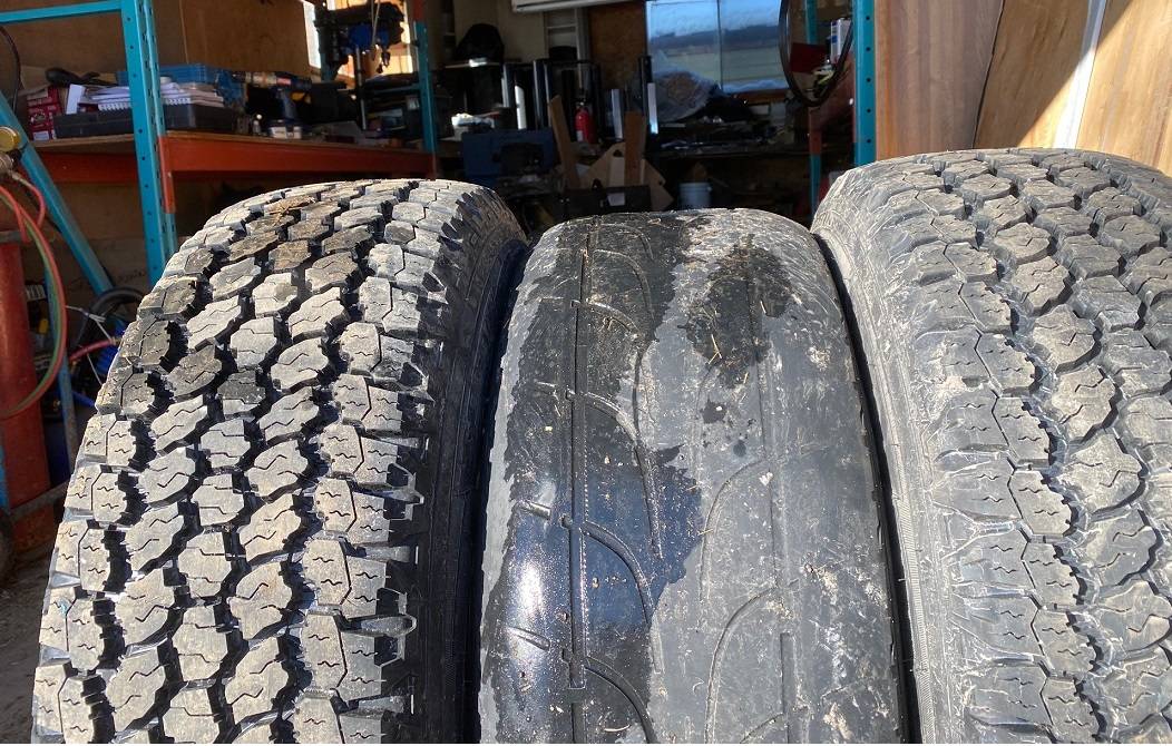

Alternately for less aggressive 285 tires, the outside tires here are Wrangler All-Tarrain Adverture Kevlar. I had them on my company commuter 06 and 11 Escapes, then a Scab shortbox F150, and they were awesome all season, real good in snow tires. I bought the LT 285/70-17 10ply for my personal F150, I liked them so much on work trucks.
This is the perfect setup for this tire size. Some of the trucks with 2”+ front level actually end up looking like reverse rake whereas this fits the rangers body lines better to me. I suspect you could go a little higher before the reverse rake look sets in, but this is probably the exact setup I will use.
LoneRNGR
May 8, 2020
472
856
Lubbock, Texas
2020 Ford Ranger XLT
Systems Engineer
I don't mind the raked look. To be honest, this looks level to me. I haven't aligned it yet and I'm still deciding if I want to keep this height. I did it to mimic the Tremor stance, which is advertised as 1" over stock. So my shocks are adding 8/10ths of an inch and the tires the additional 2/10ths, so this is about 1" over stock in the front. I have some 1" Fab-Tech wheel spacers, but I haven't taken them out of their box. I'm not certain that I want to widen the track.

I have this same setup but it absolutely killed my mpg, went from 24 combined to 19. With tire calibration with ForScan done as well. Did you get the same effect??
Do you have no rub at all ?
