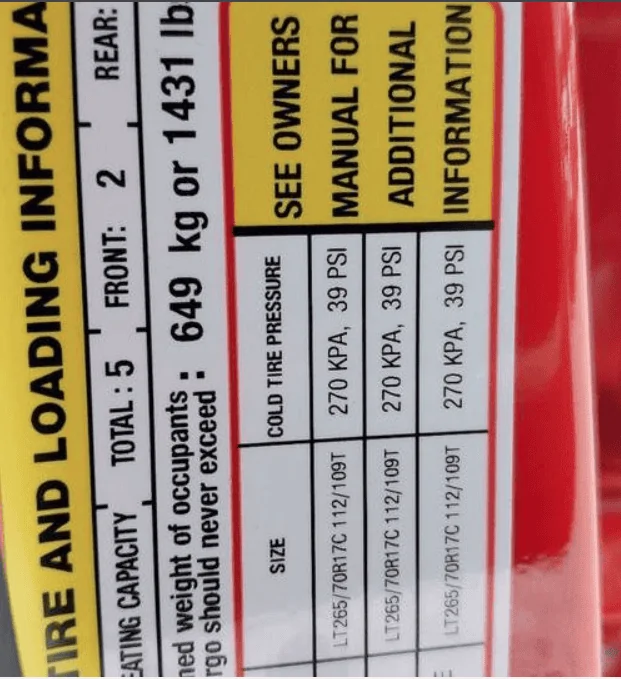

On trucks that come stock with LT tires the placard recommends different pressures. 37 LBS
That I was not aware of. As for going up in pressure for towing have you tried staying at 37? I would think it would be a bit more comfortable.

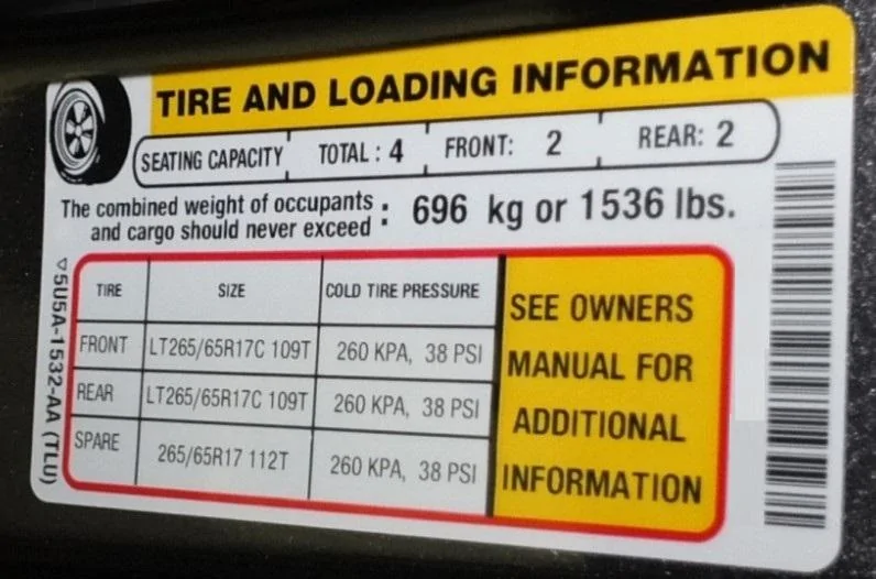

Just saw a new Tremor and here is the recommended PSI for the stock 265-70-17 General Graber AT .
38 PSI Specified for the LT's on our SuperCab

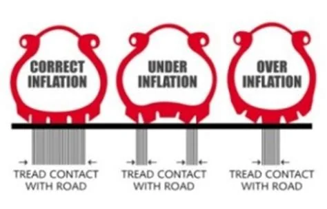

You should do the chalk test instead of guessing. Chalk a section of tire tread and drive. The chalk should be gone equally across the treads. Only gone in the middle...pressure to high. Looking for even "wear" of the chalk across the entire tread pattern.
Chalk all 4 tires.....
This will result in the best psi for your vehicle.
