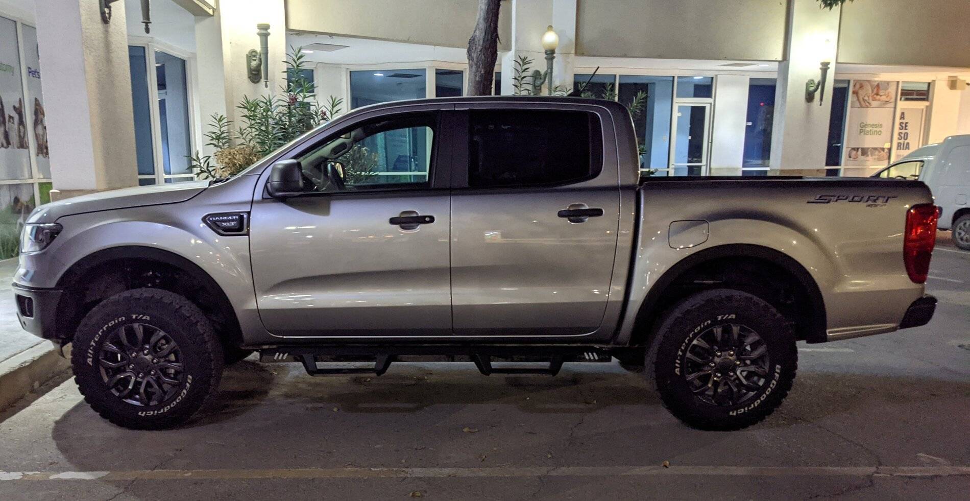

Do you have any rubbing at full lock? I really would like to fit this size w/o leveling kit, but not sure how much that affects towing and payload.

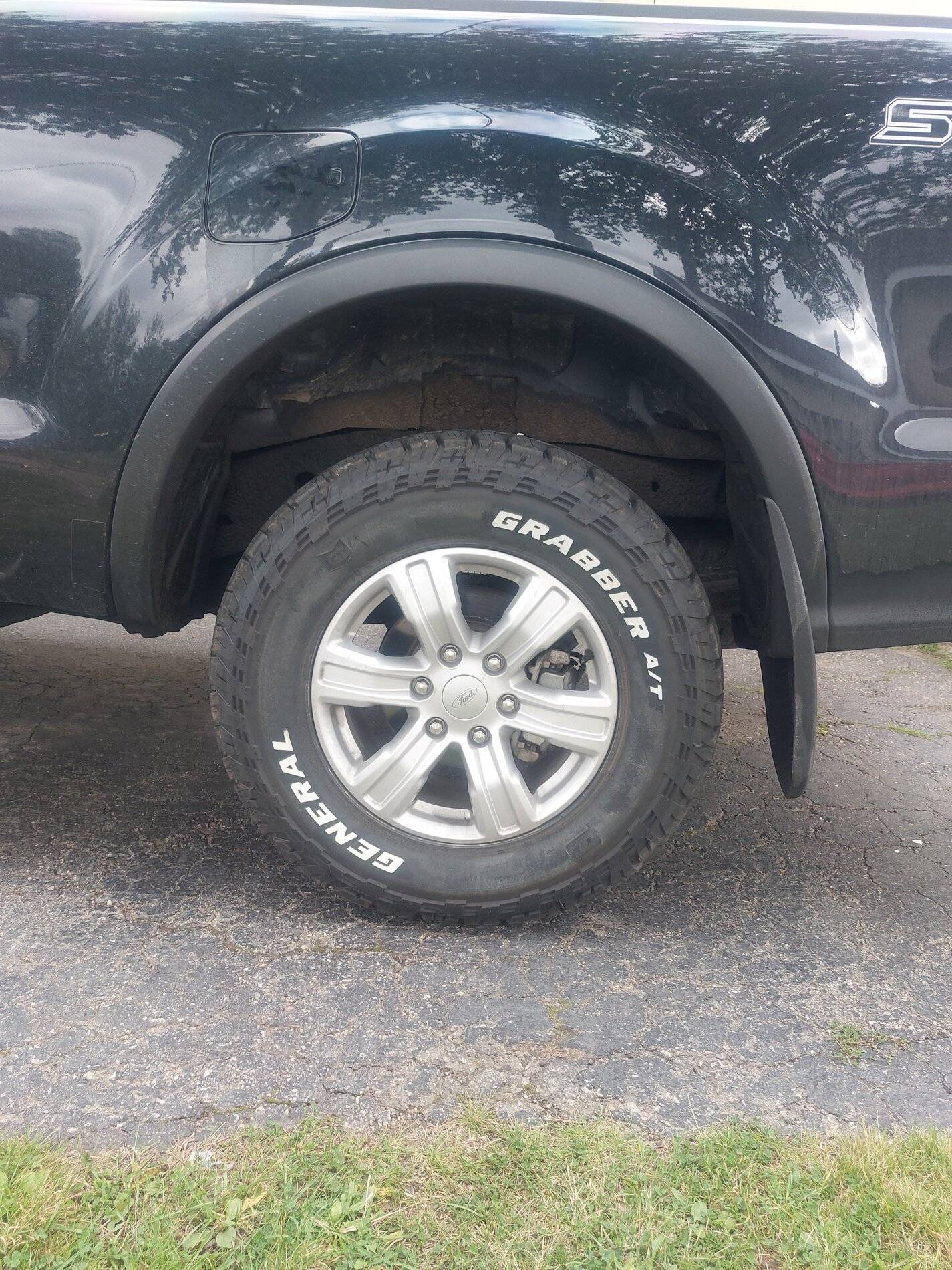

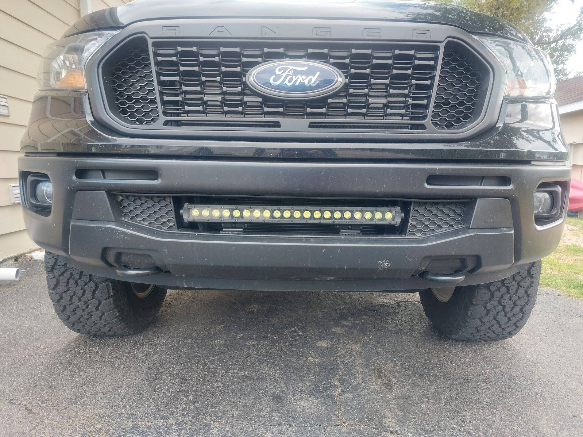

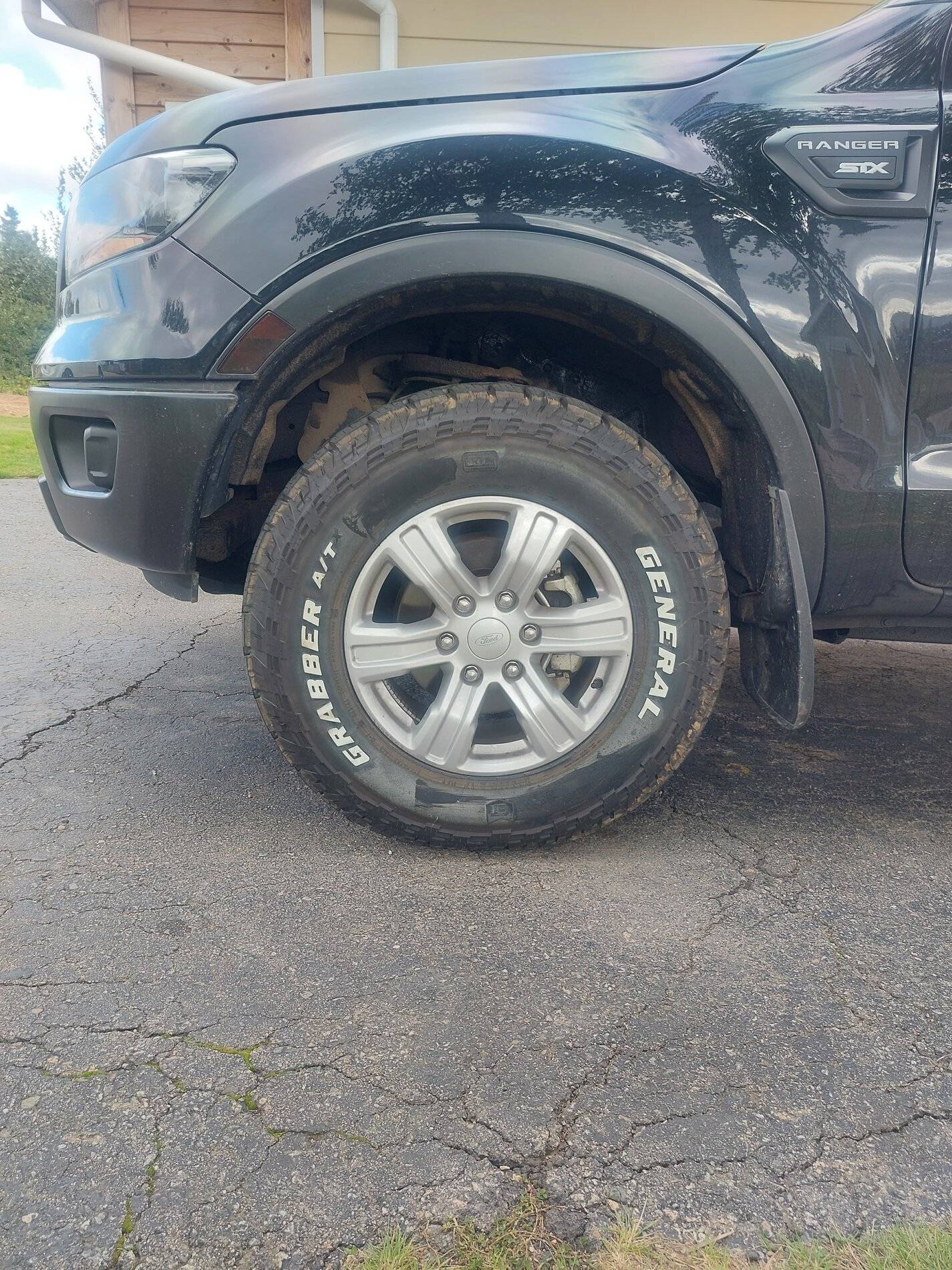

I just installed 265/70R17 General Grabber ATXs on my stock XL with the Stx wheels. there is no rubbing at all under any conditions that I have found yet. I did zero modifications of any kind before putting the tires on.
Can we get a close up pleaseeeee

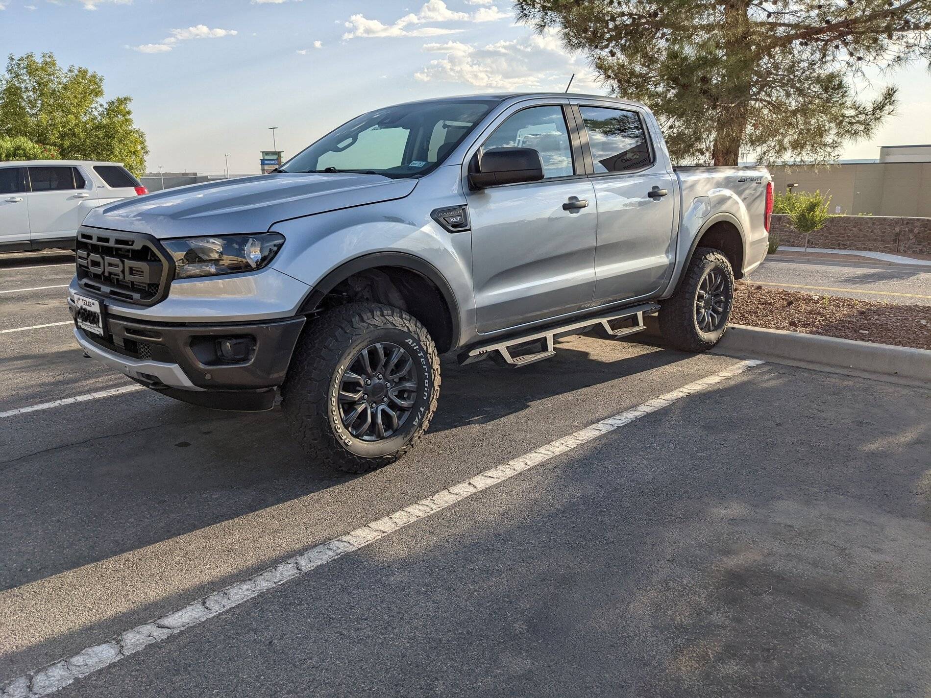

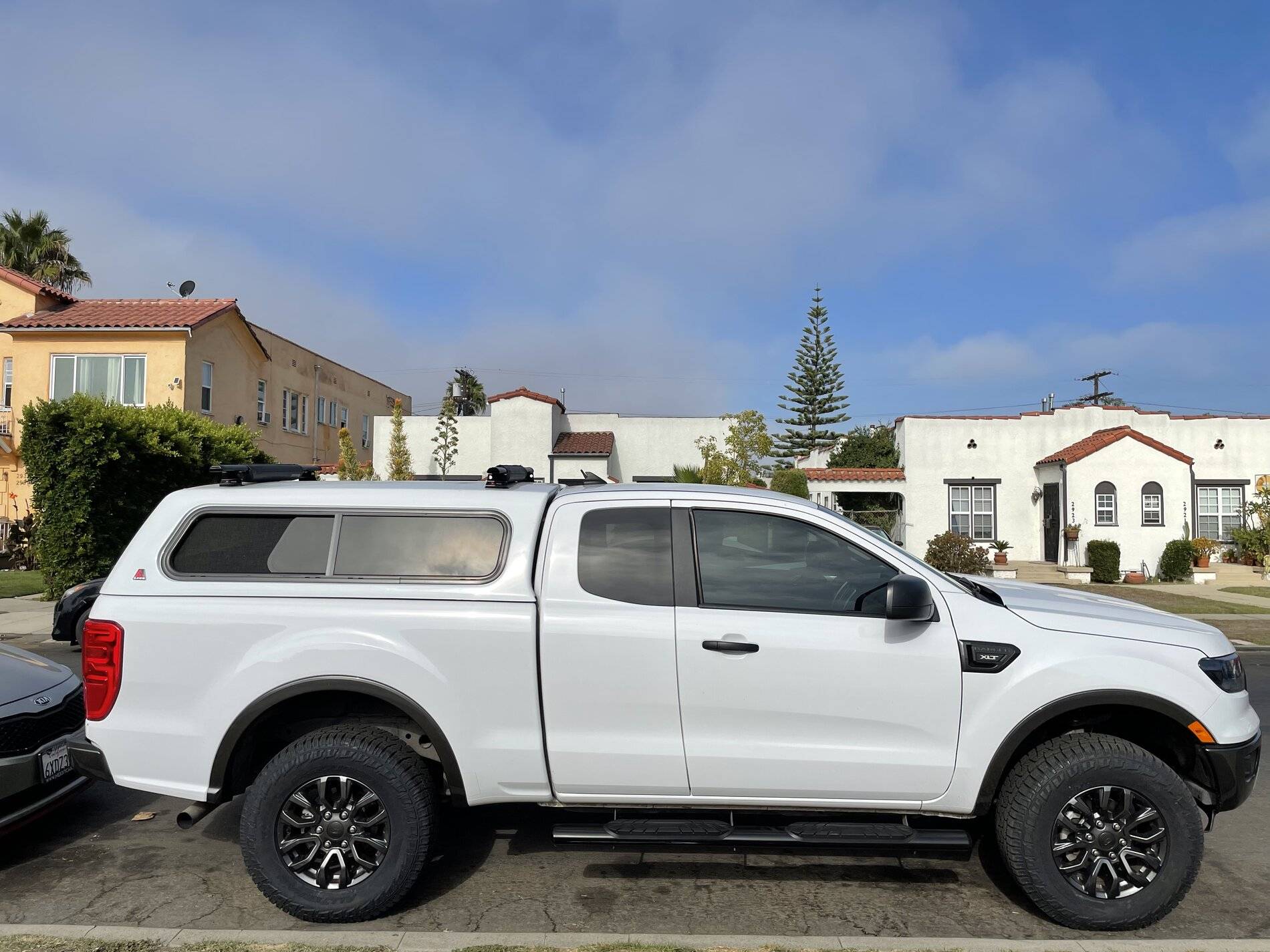

265/70R17 Duratracs installed on factory wheels, no rubbing, no lift.
Yeah for sure, dark out now but I'll try to remember to get some pics tomorrow. I also had the rear suspension flattened this weekend the day after putting the tires on hauling scrap metal to the dump and there was still no rub.
