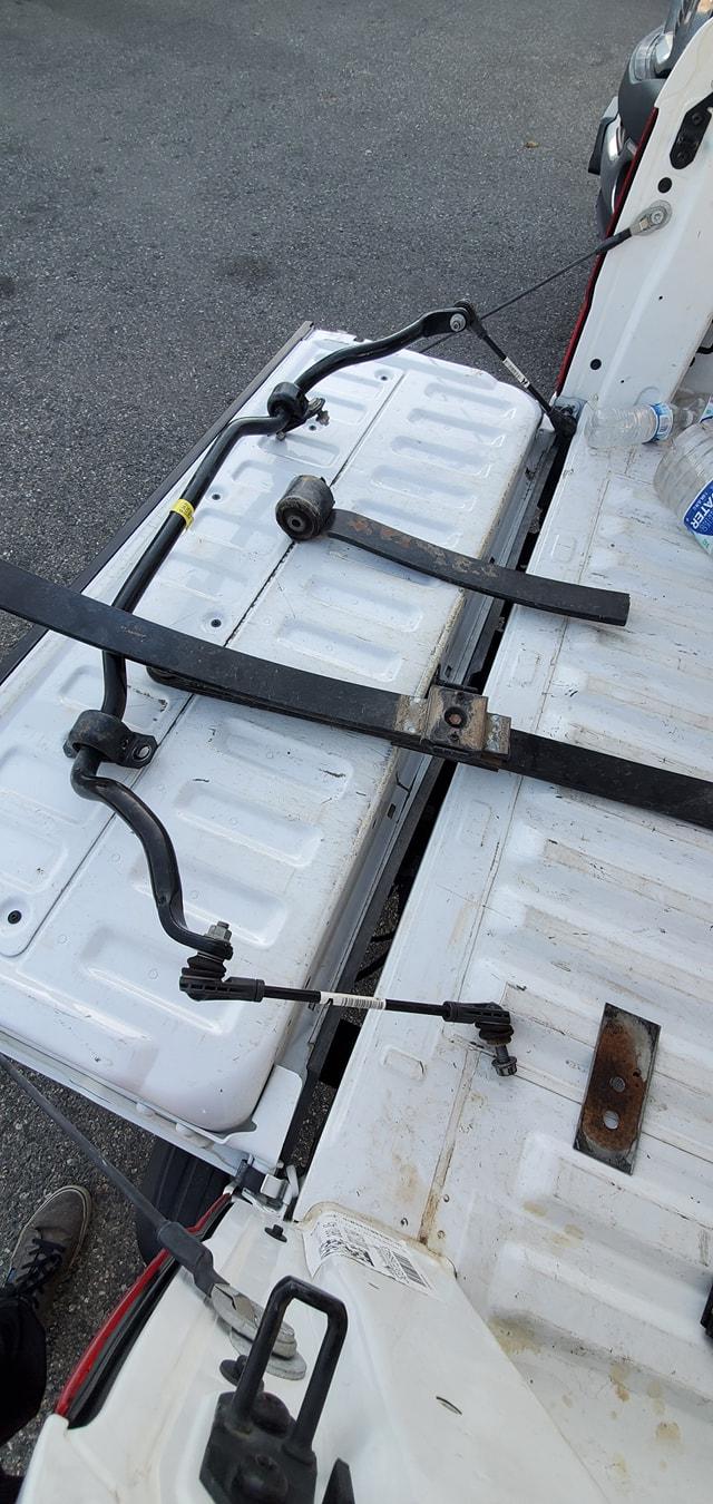

Hmmm, it looks like @Glocker and @AzScorpion are collaborating to mod an anti-sway bar into a dual tailgate damper. I’m not sure where that leaf spring comes into play but I’d bet it’s a new closure assist mechanism. Interesting.
Stand back because this thing opens with force! You need to winch your tailgate shut though. BoooooO!
Like the old Ford model T’s stand in front and crank it shut‼
