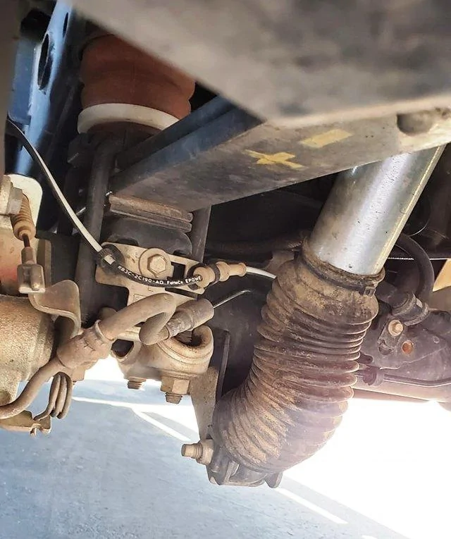

The one broken spring I saw was completely stock. But, it sounds like the driver was trying hard launches with his Ranger...
The spring was stock.. but what about the rest of the truck? The shock in the photo isn't stock, is it?
No, you're right and good eye. But the rear Eibach shocks are a direct replacement for stock. They neither add or take away from the height of the truck.
But based on the valving the shock uses, it can change the loads the springs see.
