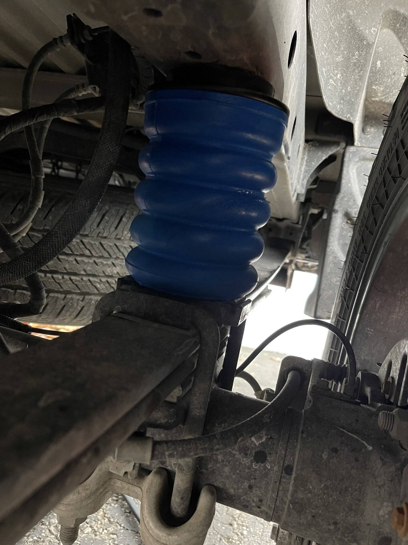

Installing 1000lb SumoSprings today!! I’ll post some pics and information once I get it!
Btw, currently have maxtrac 2.5” spacer in the front and RC N3 shocks in the rear. ——Maxtrac came with a bracket for a diff drop, still not sure if I’ll do that or not. If I do, I’ll probably purchase the BDS—— I was expecting this spacer to make it level, but adding a decked drawer system and a couple hundred lbs of tools left me with a constant 1” squat… So… I just ordered Fox 2.0’s for the front. The SumoSprings will be paired with BDS shackles and Bilstein 5160’s for the rear. If this still leaves me unsatisfied, I’ll most likely go OME leaf springs. But, I’m thinking that this should help get me get to a point that I’m happy (level to 1/2” rake with comfortable, firm suspension). I won’t ever Baja it, but will have a constant nag to adjust if it’s too bouncy or simply too harsh. Anyone in a modern Ranger deserves that!
The Fox’s have a 10-12 week delay to ship… but it could be worse, I guess. It’ll give me a chance to install, analyze, and understand each change along the way.

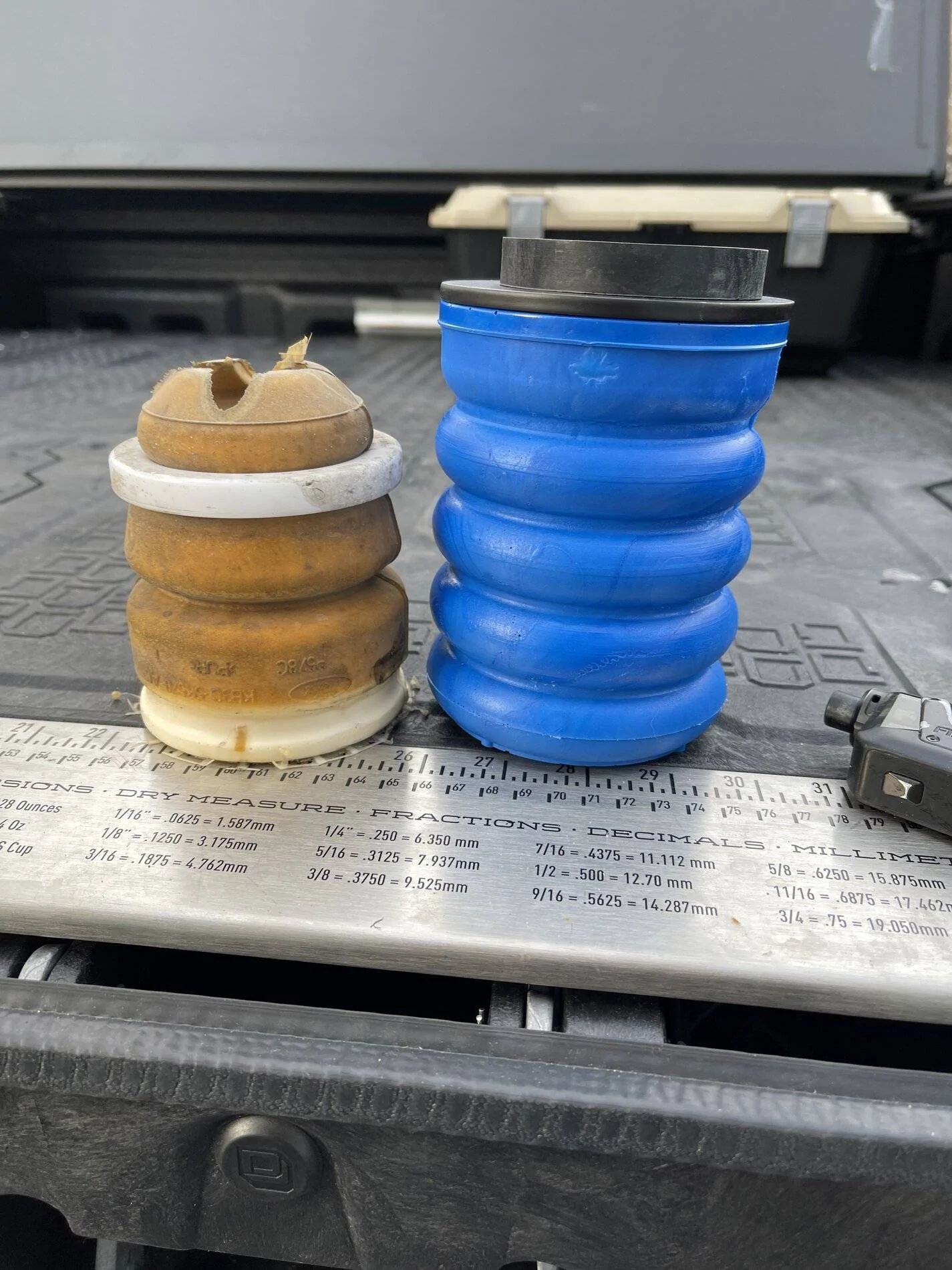

Sorry for the delayed response… I’m in a very similar situation! It ended up being rainy on Sunday and my girlfriend got the day off, so I put off the install til today. Just got done with my test drive for the SumoSprings. They just make barely make contact with my standard weight, so didn’t fix any sag unfortunately. I’ll end up just matching the front height to the rear once I get my coilovers.
The rear feels firmer actually, but LESS harsh. The RC N3 shocks helped, but once I was into the bumpstop it got harsh quickly. The SumoSprings dial it down and take the edge off. Even more noticeable is when hitting something unevenly- I was actually intentionally hitting large potholes and grinning- or large speed bumps. I would 100% do this again on any truck that’s not bagged.
I have 265/70r17s on and once I add the BDS shackles maybe I’ll make a spacer to compensate for the change to keep this amount of contact. I’ll cross that bridge when I get there. ??‍♂ Very happy overall with the rear end now. Now it’s a waiting game for the front!

Thanks for the follow up and pix! That is great to hear that you think you are happy with the SumoSprings and that they are much better than factory bump stops for big hits. Too bad they don't take care of your sag. I'm hoping that they solve any potential sag issues I will have when I drop the 1,000 pound ScoutCamper Yoho in the bed sometime in February.
I just noticed that SumoSprings is having a 25% off sale. Too late for you and I, but hopefully someone else out there in Ranger5G land can take advantage!
