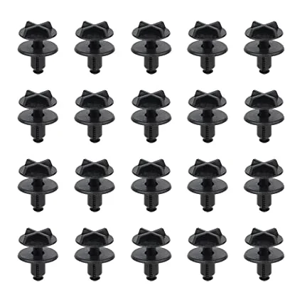

I've got some things I ordered to try that might work as well, just haven't had a chance, but was going to report if/when they worked.
It is a fastener GM used or uses, made to be removed:
They're sitting on my toolbox waiting for me to get around to it. Was something like $7 for a baggie of them.
you got a link for them?
