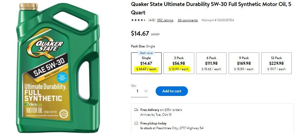

I used Quaker State Ultimate Durability full synthetic 5W-30 on my oil change last week.
It meets the SN PLUS designation required for our 2019 Rangers, and also meets GM's DEXOS 1 Gen 2 standards. Right now it's on sale at Walmart for $14.67 for the 5 Qt size (just don't buy the three pack at $18.99 each)
GM's DEXOS 1 Gen 2 seems to be pretty similar to the new ILSAC GF-6 standards protecting for low speed pre-ignition (LSPI) for Turbo engines.
