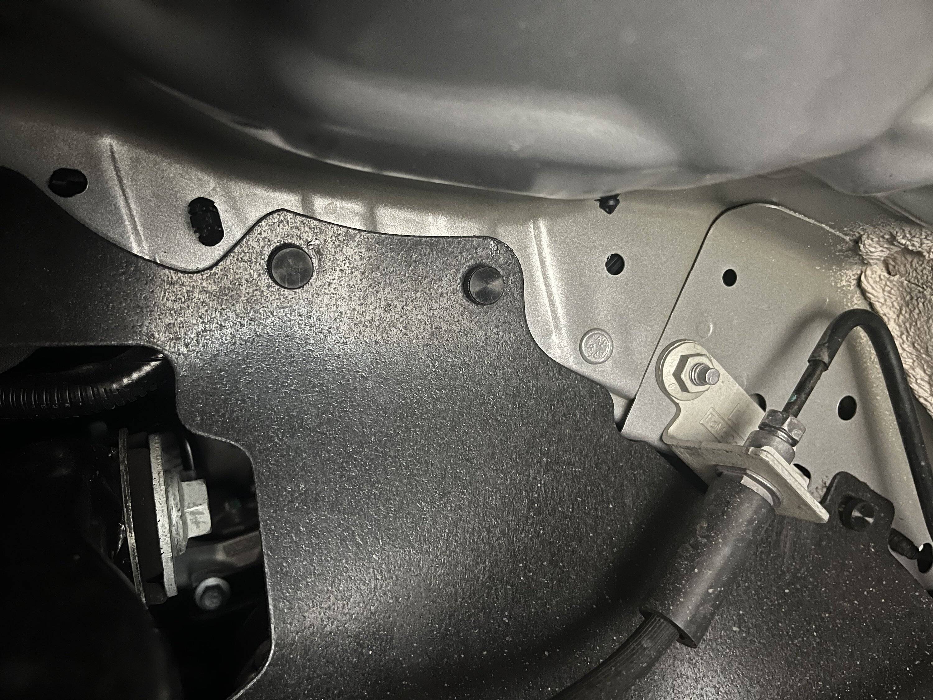

care to elaborate? those stupid ford clips make me miss my Caddys
I removed the plastic 'screws' from the fender well covers and JB welded rivet nuts in the holes, then I just use threaded thumbscrews to fasten the flap back in place, no tools and quick to remove/replace.

nice! that would shave an easy 5 minutes off... that means more time for drinking

I've got some things I ordered to try that might work as well, just haven't had a chance, but was going to report if/when they worked.
It is a fastener GM used or uses, made to be removed:
They're sitting on my toolbox waiting for me to get around to it. Was something like $7 for a baggie of them.
Edit 6/17/23 - Added a thread to the maintenance section on installing these. Everyone is correct, you do need to enlarge the holes, but it is a simple job. About 1 on a scale of 1-10.

Curious why you JB the rivnuts instead of the squeeze/friction fit they are designed for?
